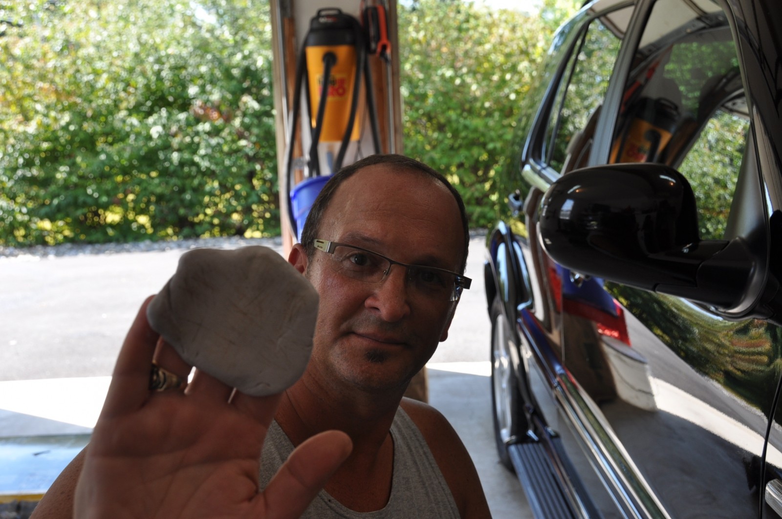

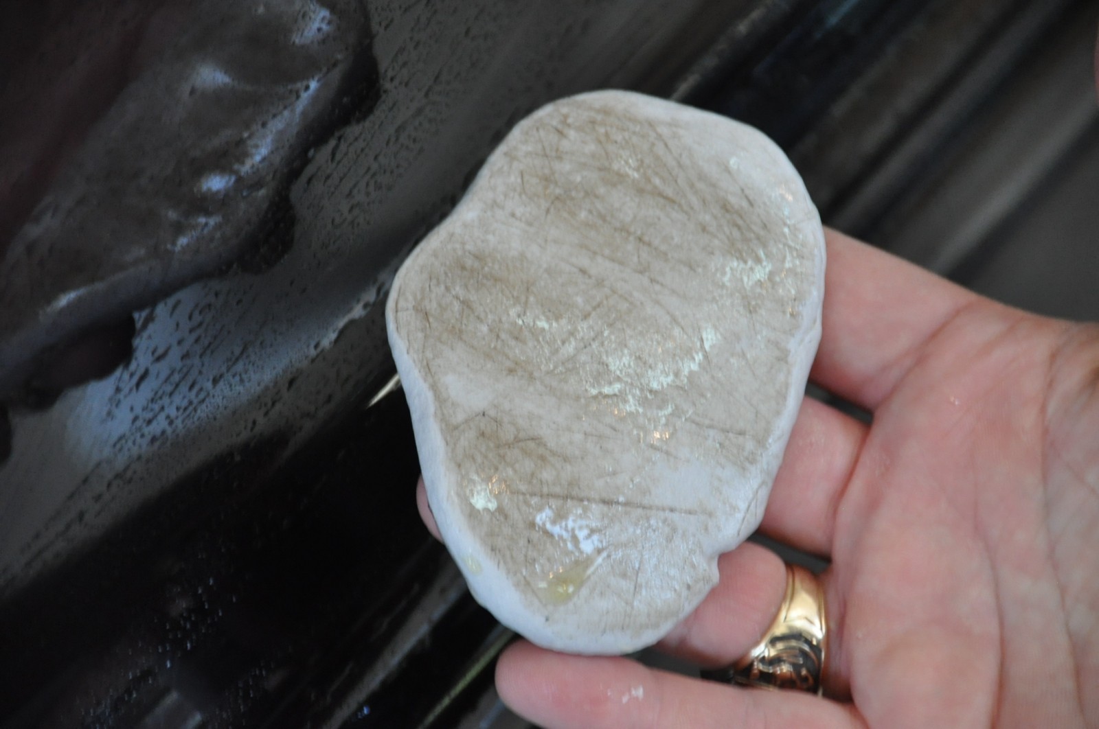

I had to run a clay bar on a clients car and then used D156 topped with DP max wax and it came out great and looked like glass. I'll be ordering more when it gets low.

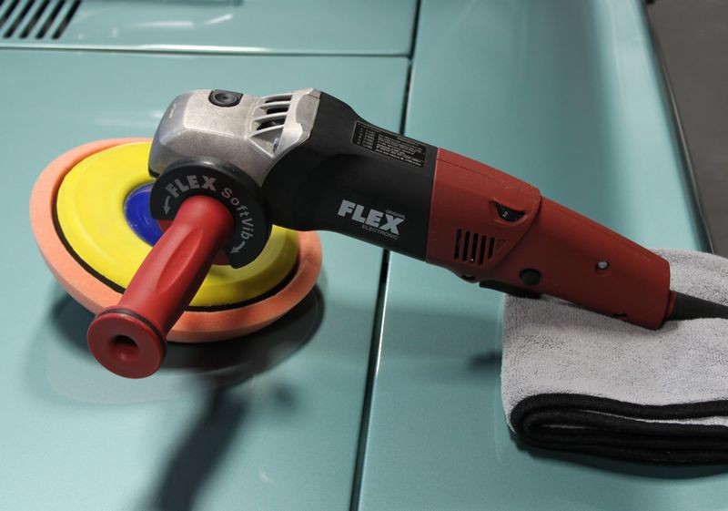

So I detailed my car today... foamed the paint with Dawn, washed the paint with one ounce of Dawn and one ounce of Maxi Suds, used Iron X, but to my surprise, the paint was not very contaminated with iron as I thought it would be, but I did see some "bleeding" going on and mostly on the rear-end of the car. After the Iron X, I clayed the whole car, applied CG EZ Creme glaze with a red LC HT pad on speed 4 with my PC, then applied 2 coats of MPL. I think the paint looks even brighter since I used the Iron X and possibly even more so by applying the EZ Creme at the speed of 4 and really working it in. The gloss in the silver paint is really something. Can't wait to wash it now, lol. I'll then top it off with D156 after every wash. :D
