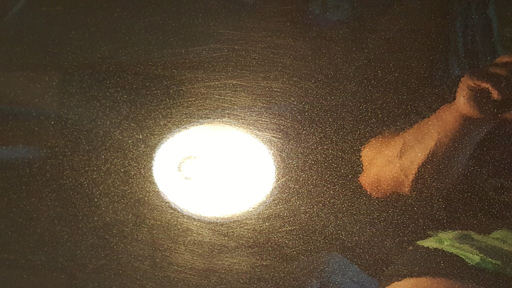

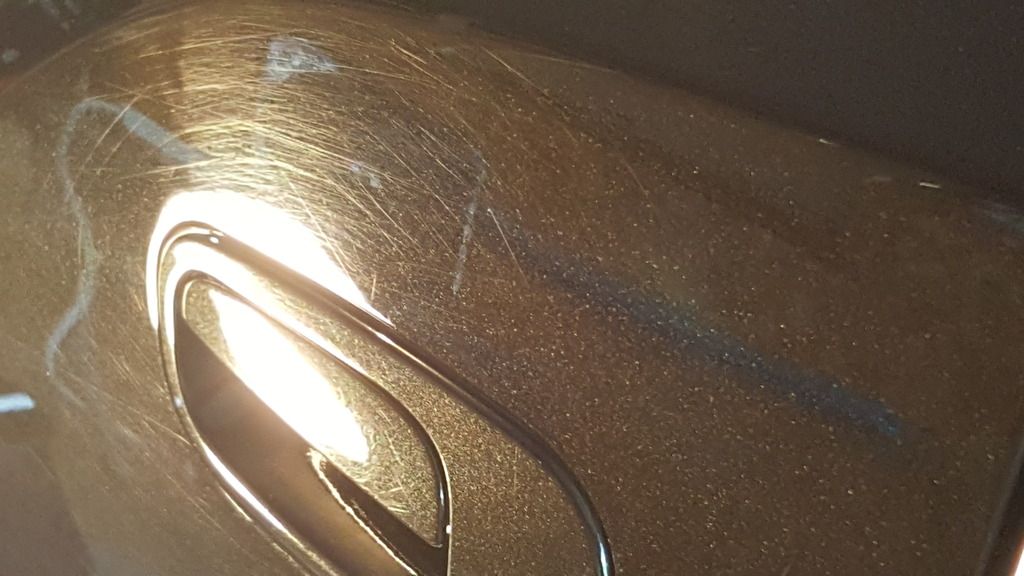

He is what I have to deal with on my Car...
Skip the AIO... I honestly think you could accomplish what you want on that paint with Meguiars Ultimate Compound and Ultimate Polish. It'd be nice to have Griots Boss Fast Correcting Cream in your back pocket just in case.. But I doubt you'll need it.
