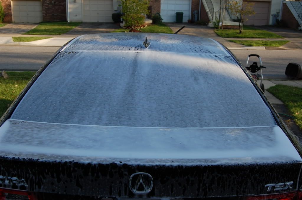

Marc...man you and I are on the same page alot of times...when I get a PM from you I'm 9 times out of 10 thinking of the same thing. Anyways, I had planned on doing this today because I'm here at my fiancee's house tonight.
Alrighty...here we go!!!
I used 4 ounces mixed with warm water:

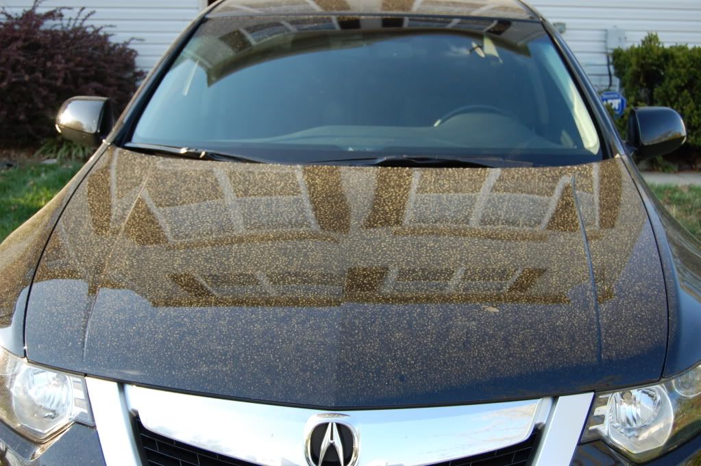

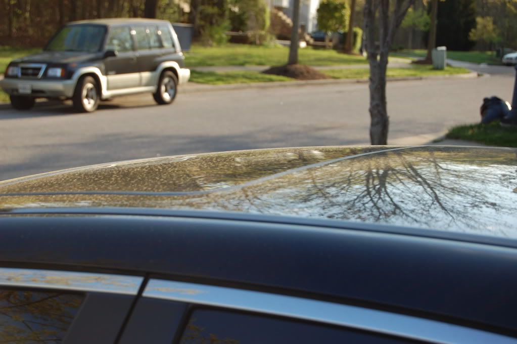

Here's what my car looked like before:

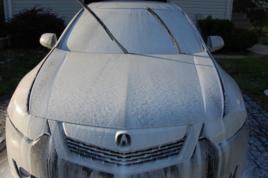

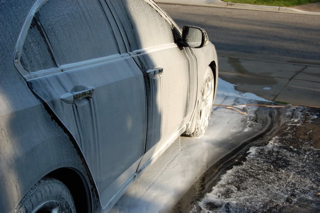

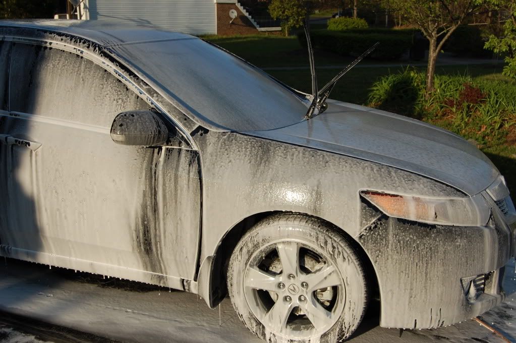

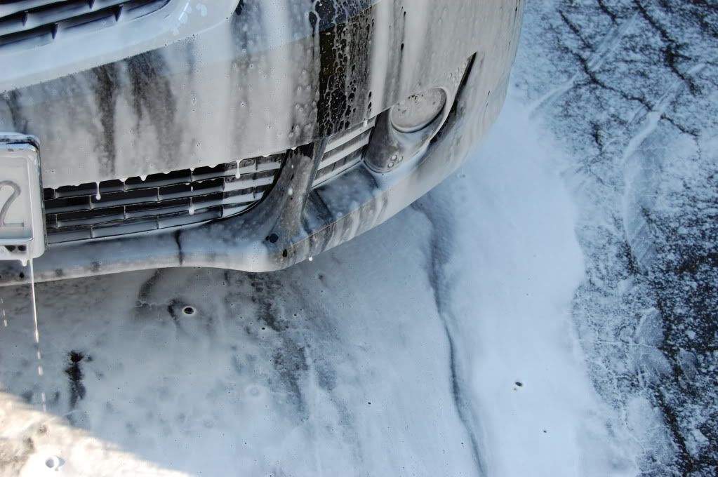

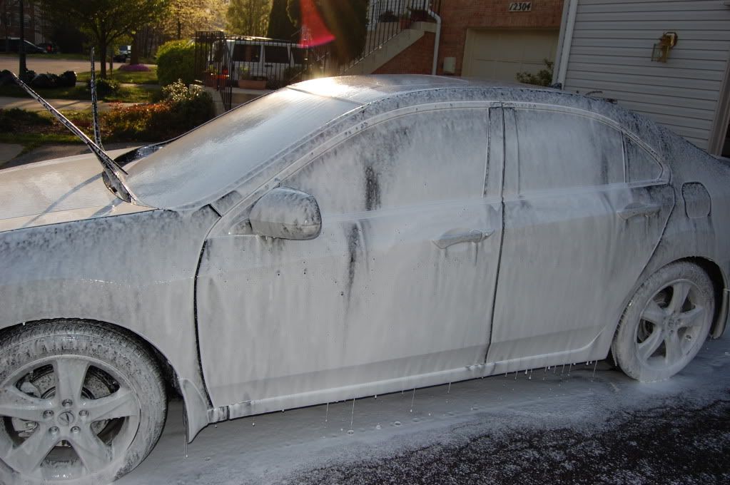

WE GOT [FOAM] ACTION!!!
I was able to make SEVERAL passes. I may cut the recipie in half next time- 2 ounces of shampoo to half warm water.

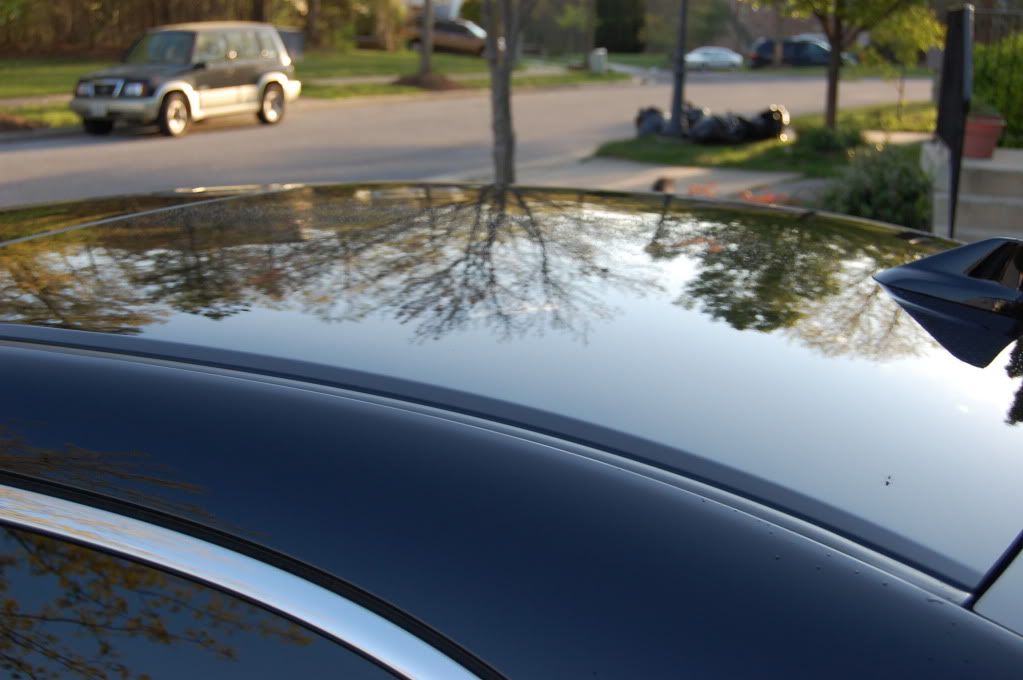

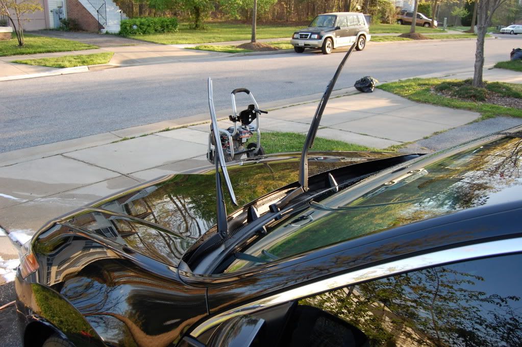

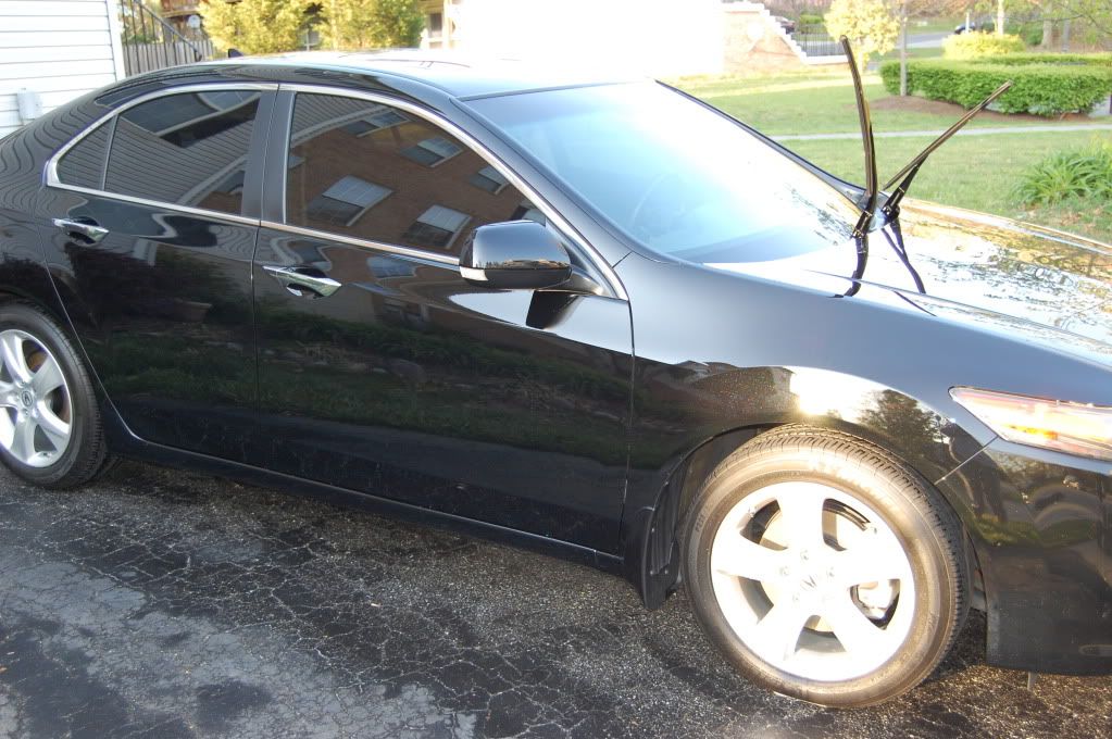

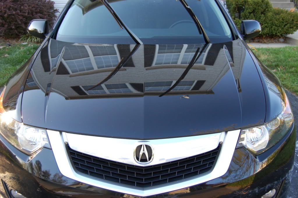

And here it is after I dried with my leaf blower:
My Final Thoughts:
I absolutely LOVED doing this. If I had to guess how long it took me (minus the picture taking)...it took me about 30 minutes. I didn't have much road grime on my car, considering I washed it on Sunday, however I had a nice protective layer of pollen on it. It rained last night but it was that weird spotty rain so it didn't wash the pollen off...only made it look worse.
This is a great alternative as a touchless wash, however I wouldn't recommend it to REPLACE a traditional wash. Prior to completely drying the car, I flooded the car with water. When I was drying the car with the leaf blower, it looked like it had water spots all over it but it wasn't...it was rings of settled pollen from the rain drops. It took alot longer to dry the car and the water beads seemed like they had some resistance against the surface-due to the surface not being 100% clean.

WOW!!! Thanks for getting that done so quickly Alex!!! A bottle of beer for ya!
Your car definitely looks a lot better compared to the beginning. It improved it 95% except for the water spots. I guess if rain is involved, then we can't get it completely clean but if it's only dust then I think it can work.
And BTW, I won't be complaining about our pollen situation here. Your car looks yellow. That'll drive me nuts!
