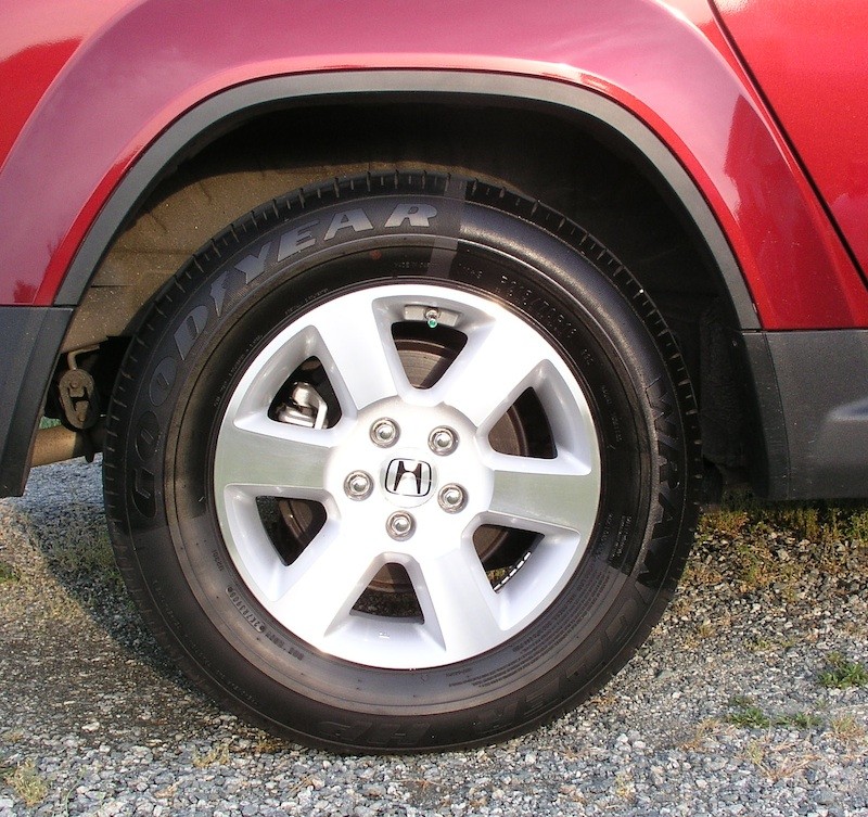

So, this afternoon, I gave the four tires, and wheels on my Tahoe the full treatment, Opti-Seal on the Wheels, and Opti-Bond Gel on the Tires.
I first fully cleaned the tires, and even gave a wipe down with Turpentine, with a small brush, and some old towels to remove all previous tire dressing products. The Wheels were wiped down with full strength 70% IPA, then wiped again with a dry clean cotton towel.
I made sure that I was much more stingy with the Opti-Seal, doing two spritzes on a MF Applicator, then after doing two wheels, applied one more spritz to the applicator, and went on to apply to the other two wheels.
No hazing, no streaking, the product went on perfectly.
Then onto the tires. This time, I used a small clean foam sponge applicator that came with some other tire product around here.
I first applied the Opti-Bond Gel full strength on the first application, and you could see there were areas in which the tires were soaking in the product like a sponge. Just a light retouching as I went filled in these thirsty areas.
I waited about 10 minutes, by the time I was finished applying the first coat, I came back and did a decond coat, this time a 50/50 dilution with water. Let dry.
About 40 minutes later, came back to examine my work, and took a small MF towel to lightly wipe the wheels.
Here's a couple pics. Now keep in mind, these Michelin 275/70-16 LTX tires, and wheels are 13 years old, and been beaten to death over the past 9 years by a southwest desert sun. Prior to that about 6 Chicago winters.
Sort of a waste of great products, and in these two pics the Opti-Bond Gel is bone dry. Reason I say "waste", is I'm planning on replacing both tires, and wheels in the spring. Plan on a nice set of 5 spoke chrome 20's, with a 275/55-20 tire. Mark
