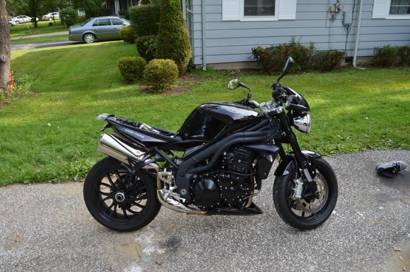

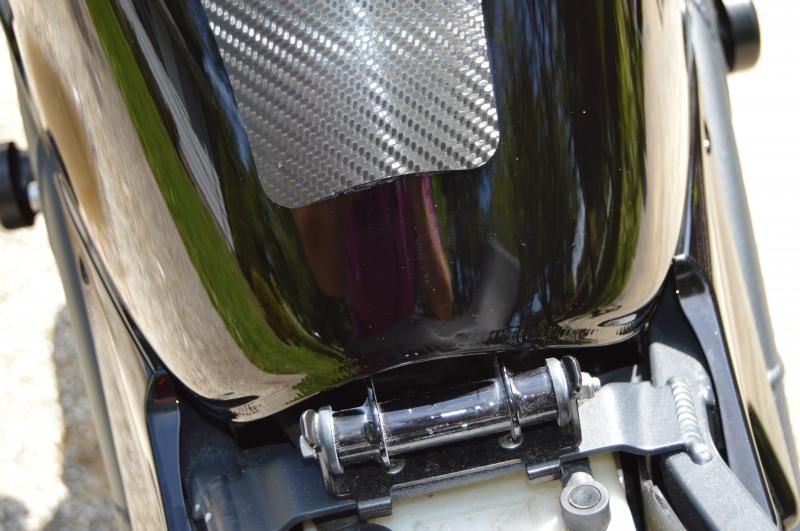

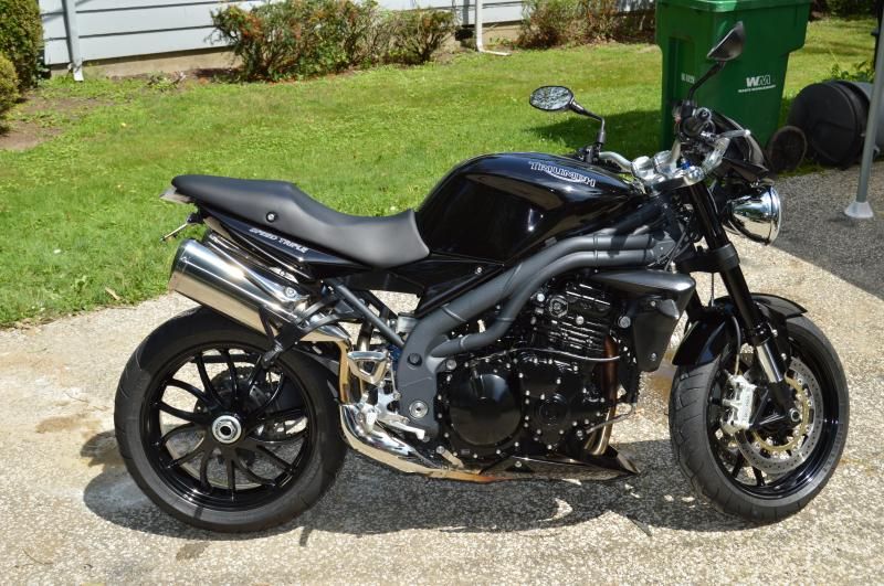

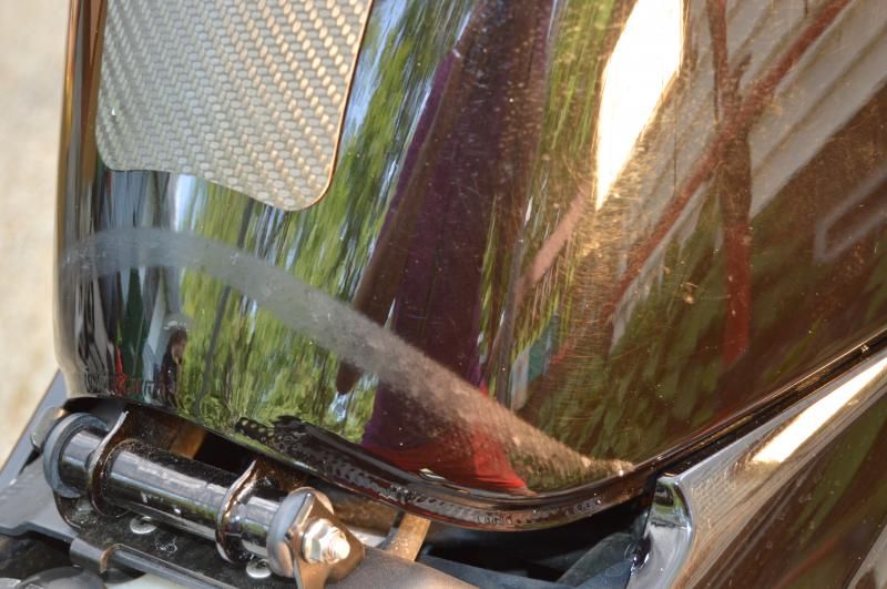

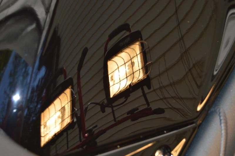

Thing looked good on drop off, until the lights hit it! Then it was a swirled out mess and the seat had made some pretty good rub marks through the clear. DP Bug remover for the fairing, wheels were hit with kerosene to remove chain lube. Followed up with Sonax FE on the wheels, got a chance to try out my new wheel woolies too! Paint correction was uber on a cyan 3" pad on the old GG full size. IPA wipe down and followed with Migliore ceramic paint coating. Shiney metals were worked over with Megs fine cut metal polish on a crimson 3" HT pad.
Some swirls:
Damage from seat:
Pre wash:
Seat area fixed:

Done!
