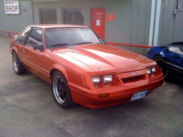

Hello all! Mike I was at the detail gtg at Nicks. Thanks you for all the knowledge you passed along. Very good gtg for learning from a expert. I just painted my 86 Mustang. The paint is around a month old. I plan on taking it to shows and enjoying it on nice days. Its all PPG paint and I put on a extra coat of clear cause I knew I was going to wetsand it down and buff it. What would be the best steps as far as polishing goes to get the paint to really pop and have that show car shine? Ive been to hundreds of shows and im quite suprised at how many cars that are in the show that have not show quality paint. Swirls and such. I dont want to be one of those people. I have a rotary buffer and a DA. I am very fimilar with both. Learned lots of tips though from Mike at the GTG at Nicks. Here is a pic of the car. Any help help and guidance would be appreciated. Also, great website with lots of good info. I plan on adding it to one of my daily web surfing sites.

Thank you. Im debating on painting the headlight buckets and trim flat black. Cant decide though
I'm right there with you on the headlight buckets, would definitely look killer in a matte black. Otherwise, great color choice, the car looks fantastic!
Thank you for the kind words. Im not sure if I want to or not. Im scared of prepping them and spraying them flat black and not liking it.

I know this came out rough, (spent about 2 minutes on it in photoshop) but I had to see what this might look like. :dblthumb2:
Hmmm, satin cowl?
Hmmm, satin cowl?
Dont look bad I just think im so used to seeing it all orange that im scared to do it.
