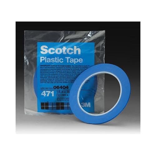

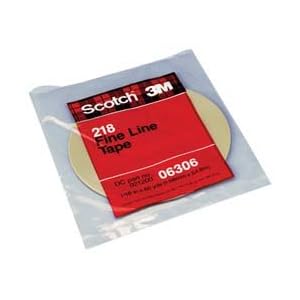

I wouldn't try buffing on top of painted stripes that aren't buried under clear. If the person who did the job was using what most stripers (one p, not two... this is a family forum :p ) I've seen use, it probably was an enamel -- One Shot.
Regardless, if you're concerned (and as mike said, care should be taken when using masking tape so it would be your judgment call) you can get fine-line tape for use on those small areas.
Wow, SLD. I had no idea they made masking tape that thin. I think that would do the trick. Can I pick up that 3M tape at any hardware department or just hobby shops?:props:
Probably just hobby shops or paint/body supply distributors (PBE Jobbers). I've never seen it at any hardware stores. :xyxthumbs:
Those thin tapes are what is typically used for laying out stripes or other custom paint jobs because it is easy to work into radius shapes and leaves an extremely crisp separation line as compared to wider traditional tapes.
You can pick up all different sizes of layout tape at your local auto paint and body supply store.
