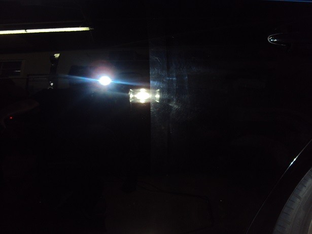

I attached a photo of the spots on the paint. This was before I clayed this area.

That water issue is a text book example of what I wrote in my how-to book on page 34. On page 34 I describe Type III Water Spots, what type of paint they happen to and how to remove them.

Type III Water Spots are tough to remove only because the way to remove them is to abrade i.e. compound the paint. And of course, you have a limited amount of paint before you hit primer.
The #7 contains a unique oil that brings out the full richness of color in pigmented single stage paints. It's the only product I know that offers this unique ability and the only product I know of that was introduced at the time car paint was INVENTED and is still around today.
Working #7 into the affected areas of paint would be in my opinion a good idea. It will help. Compounding however is also needed because the red pigments in the paint have been stained white. Since you say you've removed them to some level, (I don't know if you removed them via clay or compound as I didn't understand what you wrote above), I would get some #7 and start rubbing it in first as this will gorge the paint with the unique TS Oils. The gently and methodically compound the area with the Ultimate Compound and either a foam cutting or foam polishing pad or by hand with a microfiber applicator pad.
