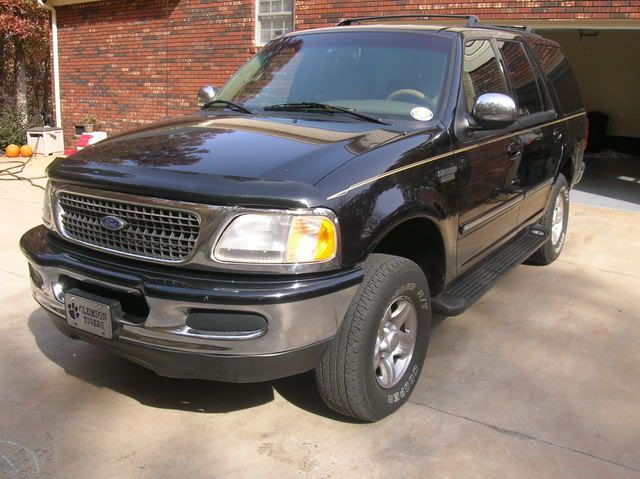

This vehicle I do bi-weekly, wash-vac. I done a full detail on it this past summer. What I done was save her from 1-800-new –paint
The lady wanted my Express/Wax package. It’s like a 1/2 detail.
Wash body DG # 901.
Wheels same as above (Klasse twins holds up good! Done past summer brake dusts cleaned right off).
Wheels well Purple power
Paint Polish
None
Wax
MaxWax then top with DG A/W
Front Glass AIO (didn’t need it, water still beads)
Outside Plastic and Chrome
Stoner trim shine and 303
Wheels Wells
AA tire foam
Tire Dressing
AA
Inside
Vinyl top with 303
Carpet Vacuum
Stoner’s Invisible glass
Leather DG #221

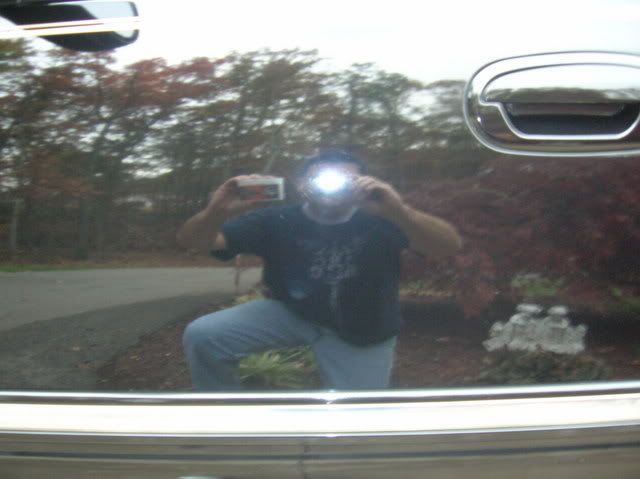

Before
After
Looking good. When do you use AA to do the wheel wells do you just spray it in there and it disappears? Do you scrub it? Does it leave it protected/dressed? Where do you buy yours too because I can't seem to find any.

abrcrombe, I scrub the wheel wells with Purple power first, then wash the body. After drying come back spray tire foam. IMO Black Magic tire foam better, Wal-Mart was out of it, so I pick up Armor All Tire foam. I buy 10 cans at a time. Black Magic seems to clean better, and has a better shine. Most of the time I just spray the wheels wells, has a higher gloss. If I want a matte look, I wipe it down with a towel. It also protected and dressed.
