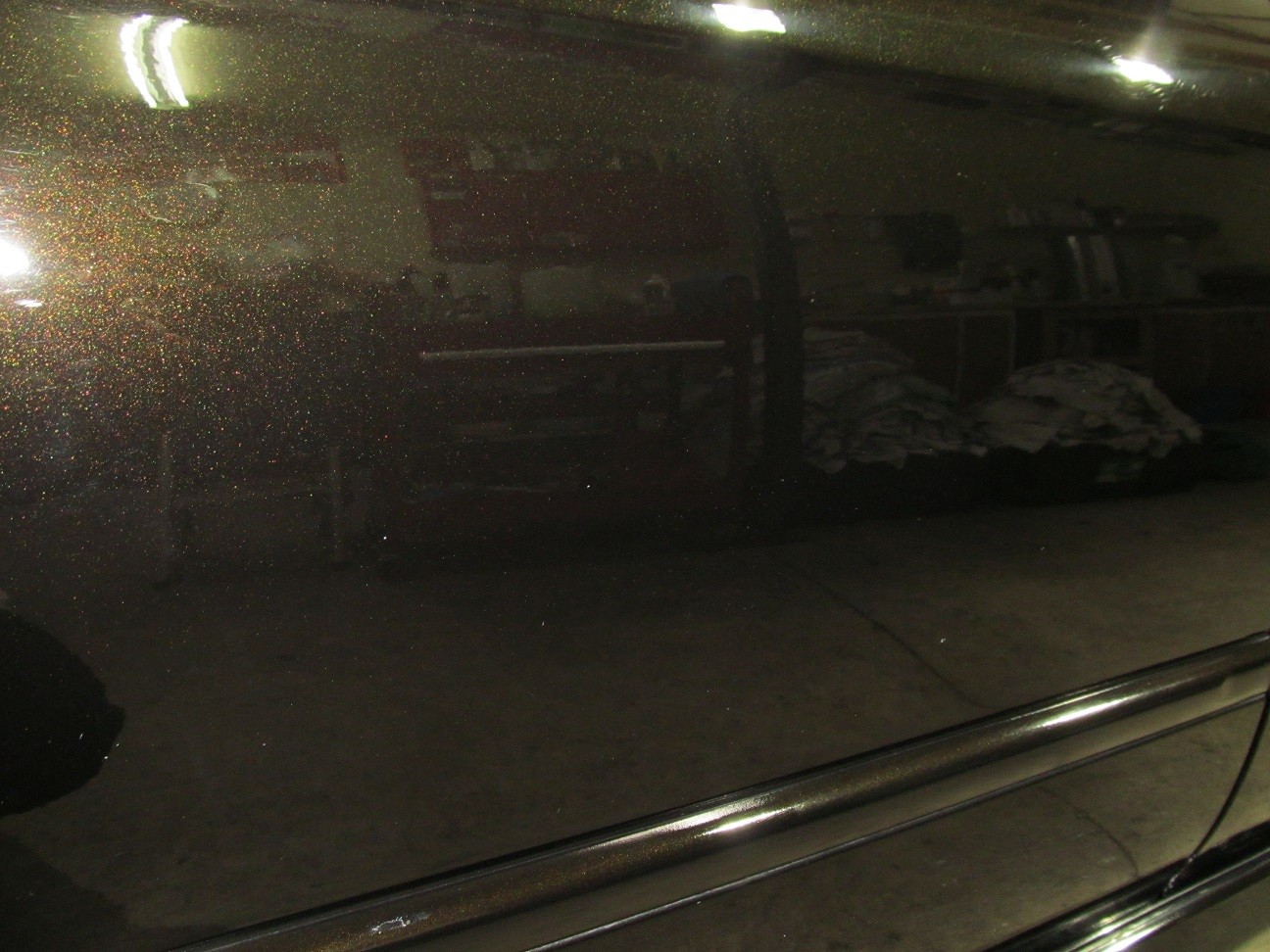

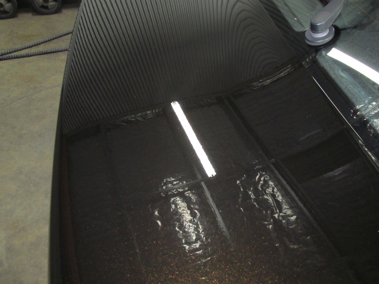

This was one of those issues I had the last resort ready(my 3" eat sanding kit) I did have a ton of faith it was going to budge. Take in mind it was about 30 minutes before sundown the shots were bad and I never hit it with a finisher. Tomorrow I am starting first thing and will get plenty of much nicer shots!
I started with BH Touchless since his car hadn't been washed since October.
Used Adams Iron remover
Then a medium clay mitt.
Lastly hit it with TWHS Slick-N-Slide
Then grabbed my three heaviest compounds. The Last Cut +/ Jescar Heavy Cut and 3D ACA 500
Decided I would use Jescar first.
Grabbed my Rupes LH19E with 6'Plate and 6.5" LC Natural White Wool Heavy Polishing pad
It came off like butter. Never had enough light to use any finisher.Barely even wiped all the compound of as you can see.
Like I mentioned it will et a full job tomorrow and will be sure to post some nice pics!
