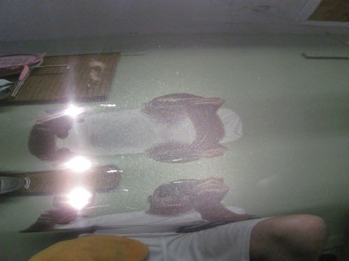

This is the close up of the defect on the paint.
After the usual prep (wash and clay), I took my flex and went to town on a panel with the MF pad and M101. 2 passes later..... A lot better but not quite there yet.
Note: The B&S MF was playing nice with the Flex 3401. I didn't experience any grabbiest. It felt almost like I was using foam. It actually felt better than my go-to MF pad....OPT MF cutting Pad. For a quick comparison, I did a small section with the OPT MF. I had a hard time telling the difference as far as the result was concern. The action was smoother with the B&S pads but it did however generated more heat on the surface than OPT.
I wasn't completely happy with the result so I grabbed my LC Purple Wool Foam and did the section adjacent to it. Few passes later. Much, much better.
Note: The surface seemed cooler after the use of the wool pad versus the B & S pad. Weird.....
The test spot dictated that the wool pad was better for this situation. I did all the panels with the wool pad followed by SF4000 on a LC Hybrid Polishing pad. A thin layer of sealant was applied immediately after a wipe down with CarPro Eraser.

1. The B&S MF pad worked just as well on the 3401 as OPT but with a smoother buffing experience.
2. Be sensitive to the surface temperature when using the B & S Pad.
3. The LC Wool Foam will still the pad of choice when dealing with really nasty paint.

Nice test. Wool will definitely play better than MF with the 3401, while MF will definitely play better than wool on a standard DA.
Wow, worked so well it's like it's not even there! Wait, maybe the picture just isn't loading... :)
How does the B&S pad compare to say an orange or yellow LC cutting pad?
On the 3401? I'd be willing to be the orange pad will cut just as well as the MF pad. On a standard DA, the MF pad will blow away the orange pad.
Yes the 3401.
Thank you for the feedback Mark.
No problem, Mike. Foam or foamed wool is where it's at with the 3401. I always got less than stellar results using MF pads with the 3401. KB told me because of the forced rotation, the fibers are matted down too much, which will results in more haze and less cut.

I tried both the B&S MF cutting pad and the LC Hybrid orange cutting pad with M101 this morning to see which would perform better on the 3401.
As expected, the B&S MF cutting pad on setting 5 ran warmer on the surface than the LC Hybrid pad on setting 6. M101 dried much faster on the B&S pad than the LC. I was able to do more passes with foam. Since I was could do more passes with the LC pad, I got more out of the polish. However, the cut was about the same when I did the amount of passes with both pads.
Initially, I thought the action with the B&S pad was relatively smooth but once I switched over to foam.....what was I thinking!!! Foam wins. I stayed with the LC Hybrid Orange pad rest of the way.
