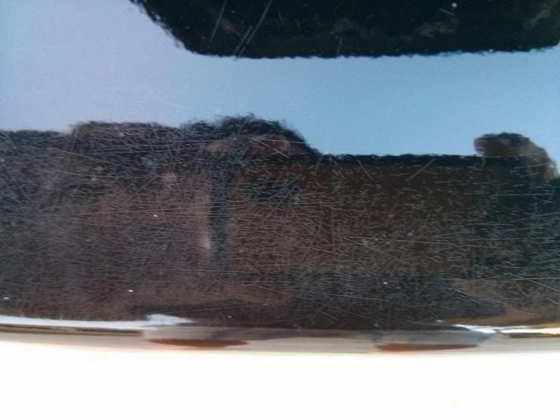

I have 96 Honda Accord and it's been parked outside for the past 3 years in the South Florida sun and heat. I'm embarrassed to admit that I haven't been keeping up with maintenance. I've been washing and applying a spray wax maybe every four months.
The car is parked in the driveway and the rear is exposed to the sun most of the day. The picture below are of the rear bumper. The fine lines look like scratches and cracks. I've tried correcting it with a couple of passes with Menzerna medium grit polish and a yellow foam 3 inch pad on a Porter Cable RO, but it didn't make much difference.
Is this the beginnings of Clear Coat failure? Is there anything I can try other than repainting?
Yes sir, That I believe is checking in the CC and cannot be corrected without a repaint. I believe the expansion and contraction of the plastic bumper has a hand in it as well. Hate giving news like this! Is it just the bumper?
Sigh. Thanks for theverification. The checkering is just on the rear bumper. The plastic section beneath the license plate is showing the classic spots of CC failure as well. I havent noticed any other damage on the hood, roof or trunk. This morning I went out in the cool air, and I noticed that the dew seems to accumulate along the damaged surfaces. Could the moisture and the sun in combination hastened the damage?
I would venture a guess that moisture could also play a part if its able to get below the CC. In your case it doesn't look like the moisture is penetrating since I am not seeing any corrosion stemming from the "cracked" areas. At least it's just the bumper that needs a respray. Can't see it being more than $150-$200 for nice new paint.

It does feel smooth if I run the tip of my fingernail gently on the surface. I'm guessing the the colored paint underneath the clear coat is what's fracturing.
Someone mentioned that Honda paint seems to be susceptible to this. Do you think I could have prevented it if I had been more diligent in my paint care? The Honda was kept in the garage for 6 years and lost its home 3 years ago when the new car took its place. I'm surprised that the paint died in just 3 years of exposure. Or is it just that the paint is 9 years old and "drying out" or something like that?
