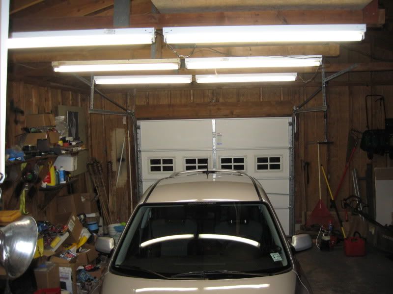

this is what i'm using -
and yes, that's a silver metallic car under there, lol.
here's another silver metallic i've done in there
