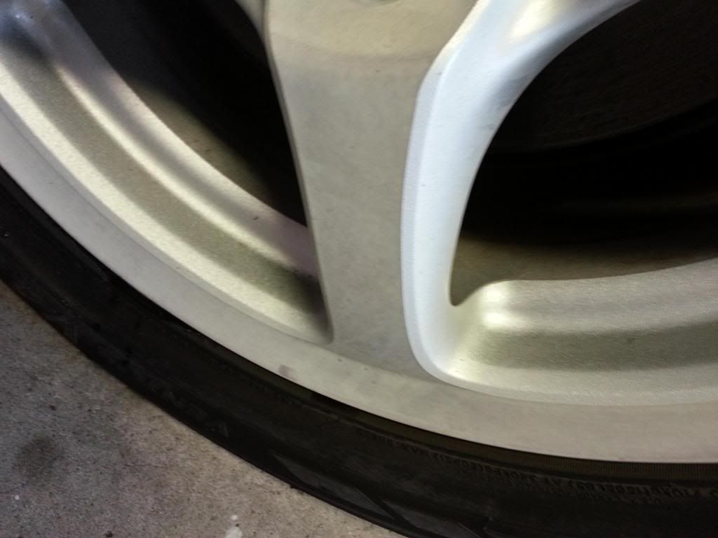

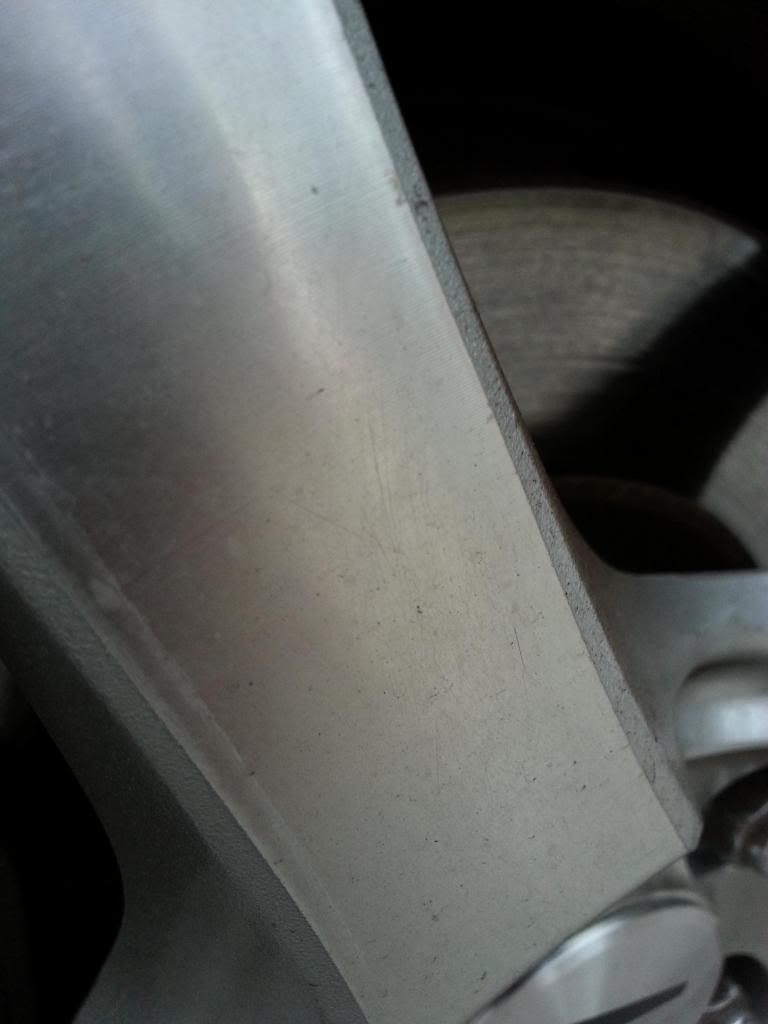

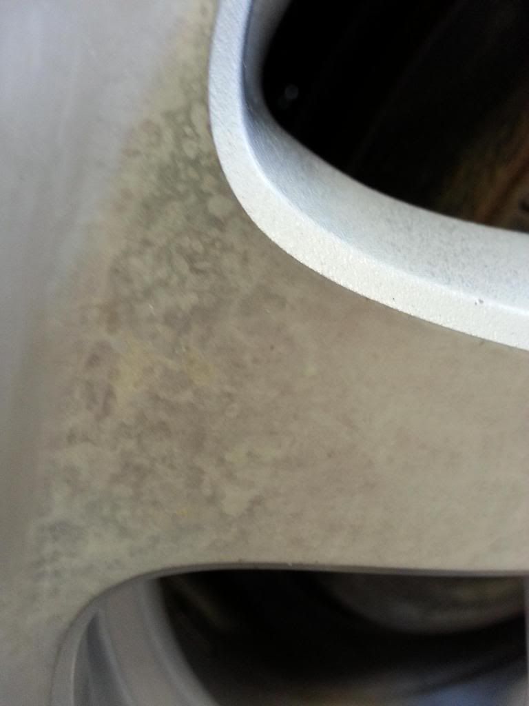

Ok so this is one of the strangest things I think I've seen... So I am currently detailing my friends s2000 and I started cleaning his wheels with Mother's foaming wheel and tire cleaner like I normally do to my roommate's car (who also owns an s2000).
Anyways, so I spray on the wheel cleaner one wheel at a time like a normally do scrub with various wheel brushes and then hose off wheel cleaner. Well, after I hosed the wheel cleaner off I moved on to doing the other wheels and when I checked back to the first wheel, the wheel had turned to like frosty white and it wont some off (all of the wheels are now like this). Now I know the s2000 wheels are clear coated (I have done a aluminum polish test before). I have tried wheel wax, 11% ipa mix, nevr dull (just to see if the oil in it would do anything) but nothing is working. The weird thing is I have never had this problem with my roommate's car who has the exact same wheels! Any suggestions? Thanks in advance!!

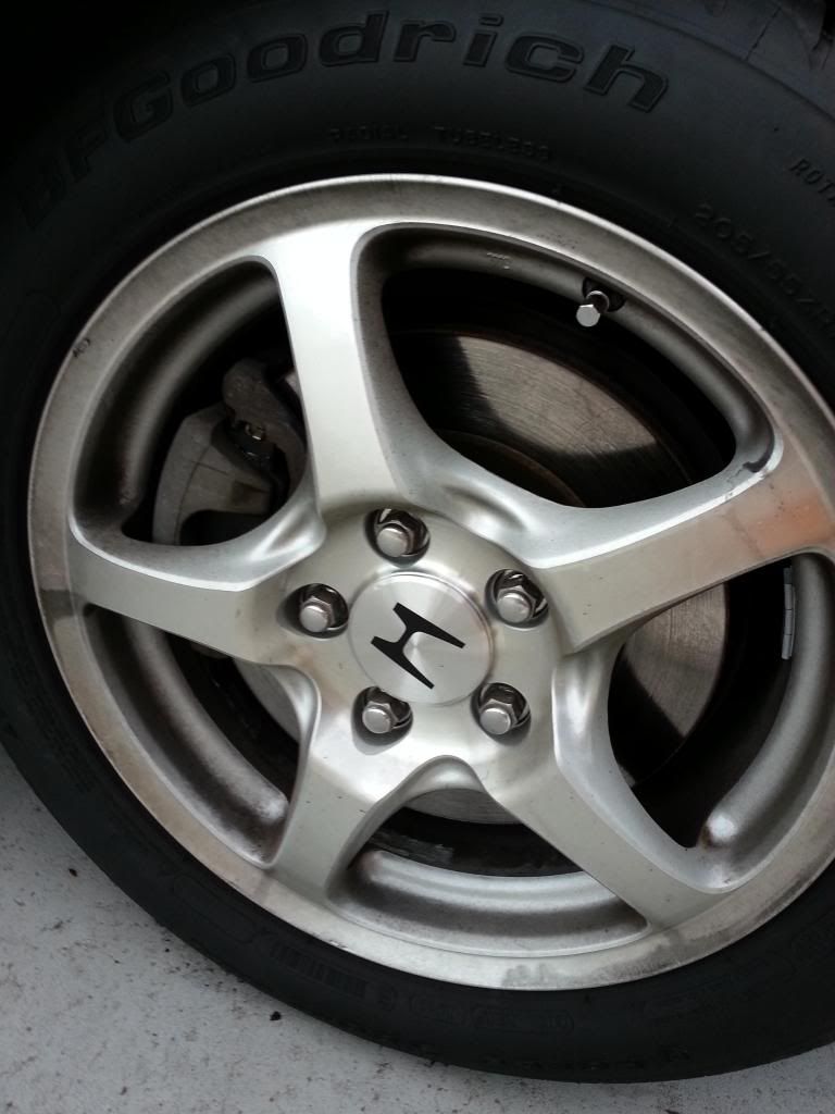

(The 3 pics on the bottom is of my roommate's wheels without the frosting problem.)
Were the wheels hot or even warm? Did you spray the cleaner on the wheels in the sun? All the other wheels worked fine with the wheel cleaner?

That is acid etching I'm willing to bet! Most wheel cleaners have hydrofluoric acid at one dilution or another. If the wheel is the least bit warm the reaction will be much more adverse than if it's stone cold. Also want to pre-spray wheels with cool water before hitting them with wheel cleaner.

Nope not even a little warm. It was just rolled out of the garage.

Yes, it was this one.
Mothers Foaming Wheel & Tire Cleaner

Hmm... Interesting, I might try that tomorrow, thanks for the suggestion.
So I ended up trying m205 with an GG 3 inch pad and orbital buffer, still a little left so then I tried m105 and it took the white stuff right off! Thanks guys for input... and thanks quiksilver_ben3 for the polish suggestion!
Oh, and one more thing... I talked to my friend and he said he had waxed the wheels a while back with Meguiar's NXT. So after I had used the polish on the wheels to remove the white markings, I took a q-tip and made a "test mark" with the same wheel cleaner I was using before and.... NOTHING HAPPENED!
So that must have been what it was some sort of strange chemical reaction between the wheel cleaner and the NXT.
