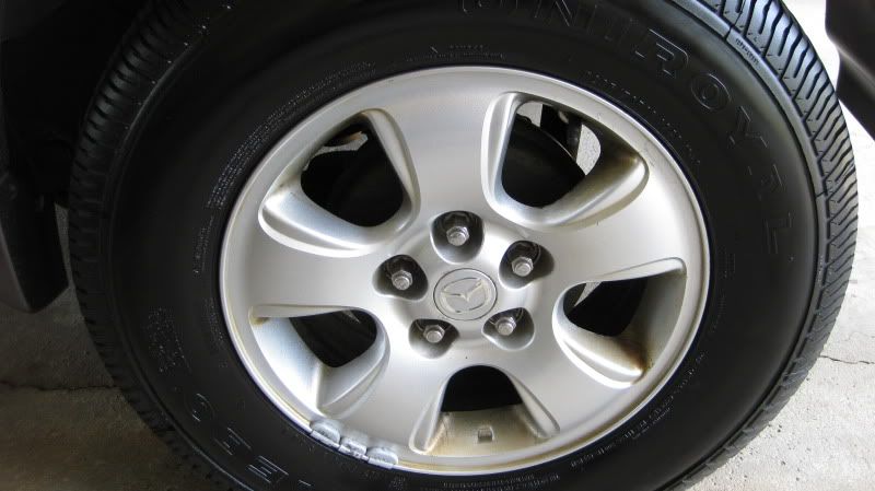

I have an 04 Tribute with factory finished wheels. The two fronts, which are now on the back since rotation, have been stained since the first winter.
Any ideas on what will truly work? Method? Product?
I have tried 3 OTC Wheel Cleaners and a stiff brush. The grime/stain won't budge. Any help appreciated. My tires with DP Gel look great, but the wheels are ugh.

You can try Poorboys Spray/Rinse Wheel cleaner for a stronger option. I would then use a paint polish and some elbow grease or a Mothers Powerball Mini and see if it can help. If its etched or stained into the finish only polishing will help, wheel cleaner will only remove outside crud.

if Poorboy's won't work, try Megs Wheel Brightener. Be sure not to use it on uncoated alluminum as it might stain those wheels...
What are those wheels? Coated stainless or painted? Hard to tell from the picture.

Well guys. It doesn't always take nasty chemicals to remove that kind of nasty grime.
I tried three solutions and here are my results.
1. Mother's Chrome Polish accompanied by a stiff brush. Results were..minimal.
2. Gunk stain remover. Forget it!
3. I just happened to get an order of Stoner Glass Cleaner from AGO the other day.
Hmmmmmmmmm..I sprayed the area and the lovely wife just happened to be walking by me
on her way to work. So, her brilliant little mind suggests; "why don't you try a Magic Eraser with
that glass cleaner.
DONE!..like a cake walk!
That is WHY we have a wife!
The magic eraser was removing it with a lot of effort, but with the glass cleaner it broke it down quickly.

I finished the job!
Stoner glass cleaner and a Magic Eraser.
Take a look.
After I receive my Father's Day order I'll layer some wheel paste on them. For now, they are polished with 3M Pro Finish.
