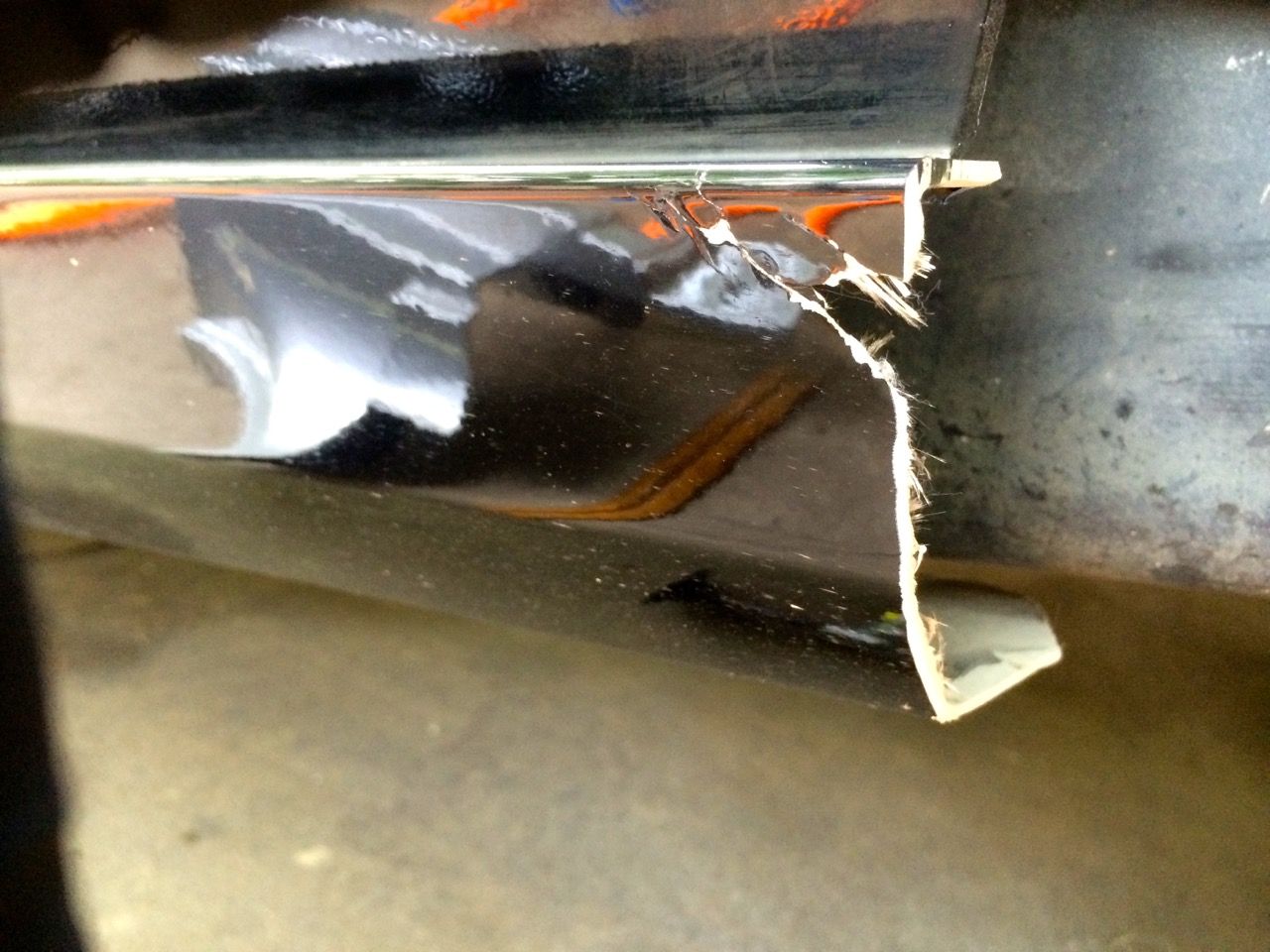

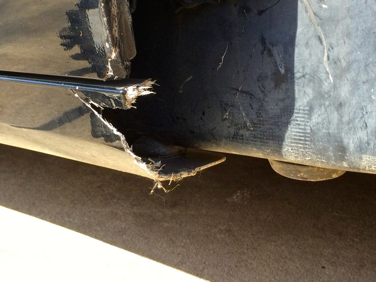

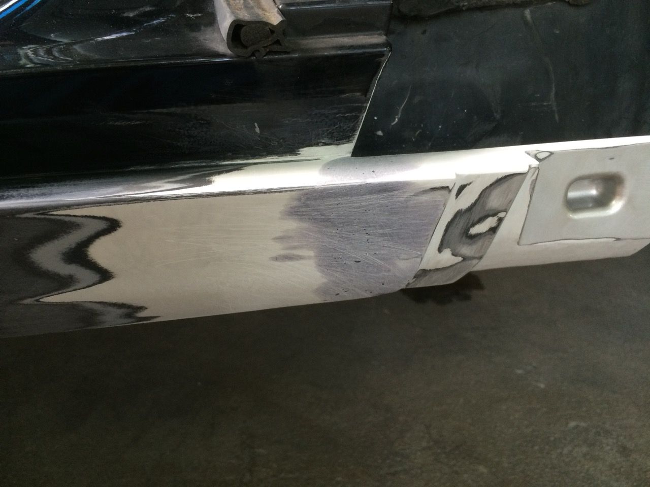

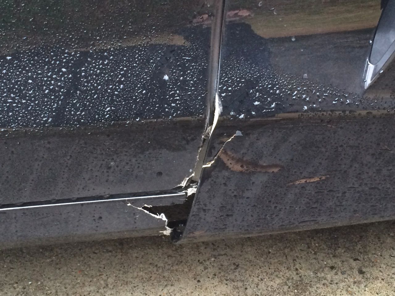

So, long story short, this is all on my 2005 Corvette. I purchased it a few months ago with some damage on the passenger fender, door & rocker panel (obviously, it was cheap). Unfortunately the rocker panels are epoxied on to the frame on these cars in such a way that they are pretty much impossible to get off (the GM techs I've talked to literally saw them off as best they can then grind the rest off.. the epoxy GM uses is no joke)
I decided to give repairing it myself a shot by sectioning in an undamaged piece on the rocker panel that I found on the internet and then repairing the door/fender. I bought a section of a rocker panel off a wrecked car, a few different types of SMC/fiberglass repair materials and went to town. Overall, the repair wasn't so bad.. I primed it with Southern Polyurethanes epoxy primer, then basecoat/clear that GM uses today on the C7 corvettes. I figured at worst I'd screw something up and have to pay someone else to fix it, but, at best I could save a lot of money and learn a lot along the way.

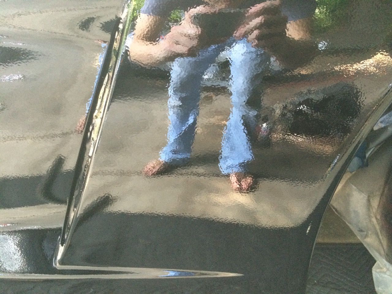

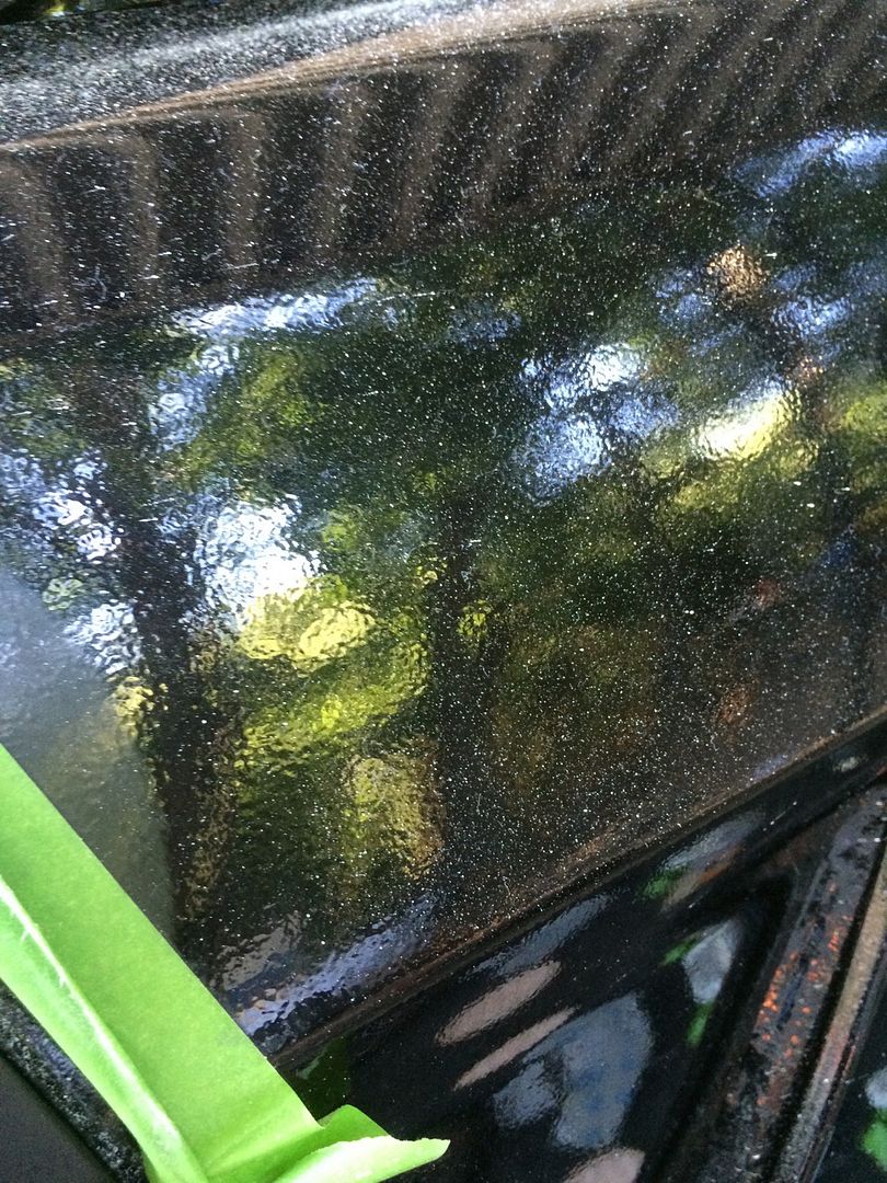

All was well until I got to the clear coat. It orange peeled like CRAZY, worse than I had ever seen. I later figured out I had not thinned it enough, and someone had added an additional regulator at the compressor, so I was not getting enough air.
Here's what I started with, prior to any repairs:

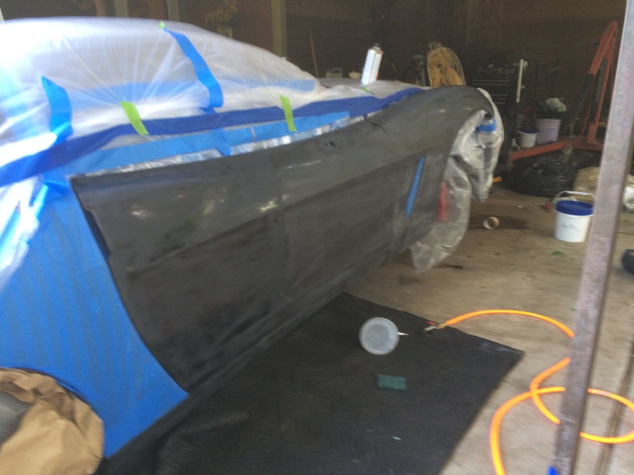

And with the fender out of the way
What'd you do last weekend? Oh just took an air grinder and chopped a piece off of my corvette..

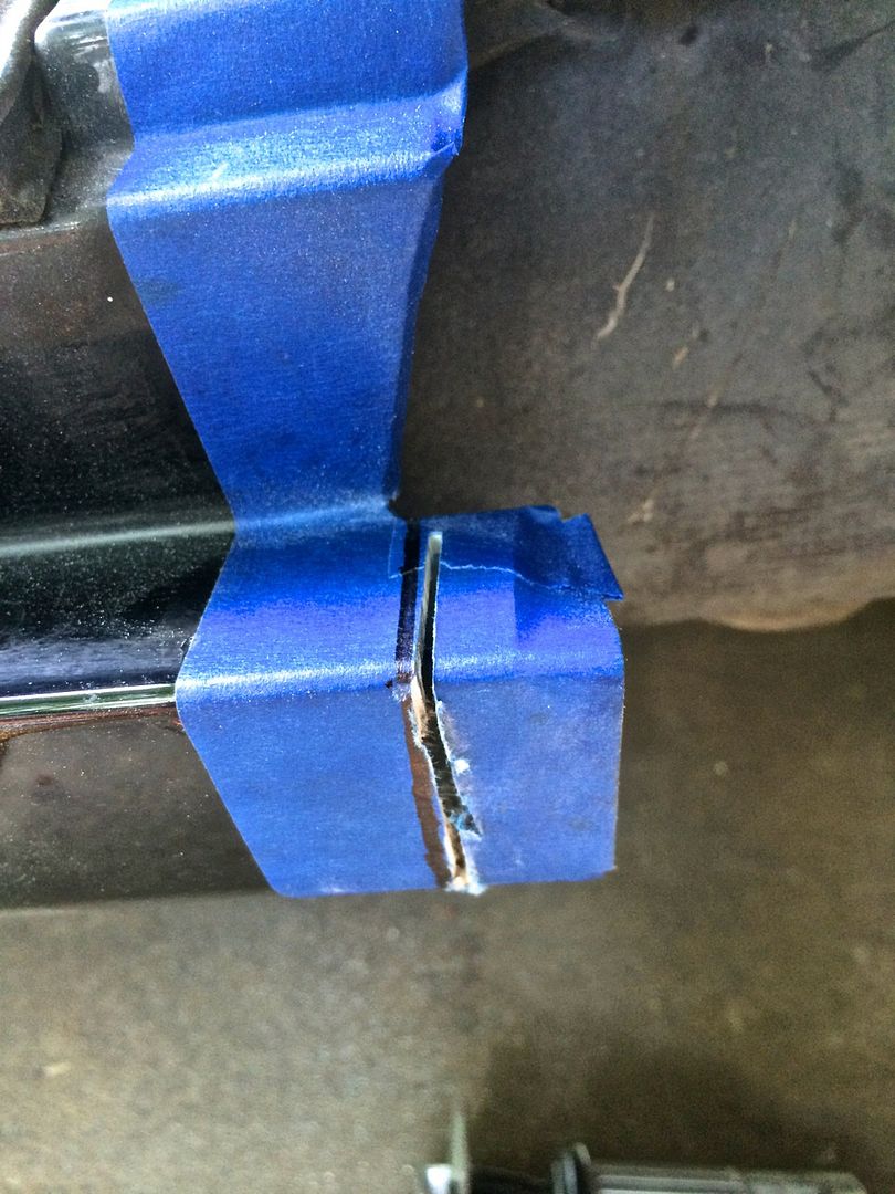

So here's what it looked like with the "new" piece sectioned in:

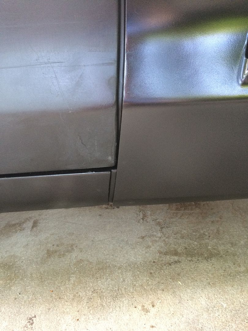

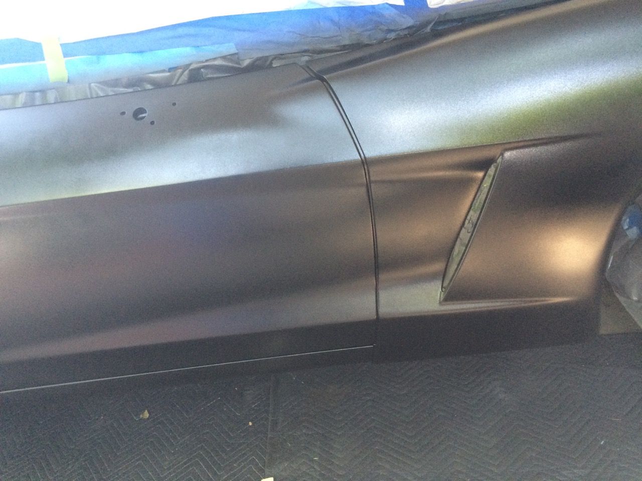

And with a light coat of primer on everything (I later fixed the gap at the bottom of the door so ignore that)

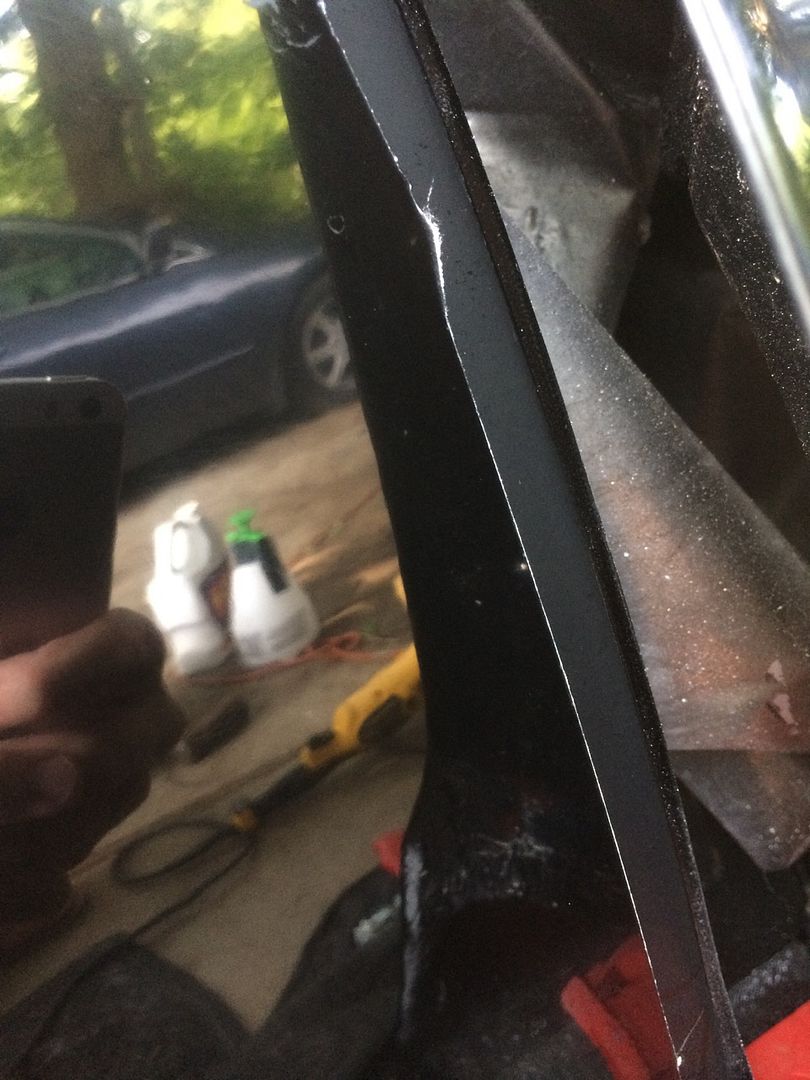

Everything scuffed and ready to paint. The idea here is to put a good coat of basecoat over the repair areas where there was no paint at all, but to only give a light mist of basecoat over the rest of the area. This is to try to blend the colors of the old/new paint. Since this is black, it wasn't very hard to blend, but can be much trickier when dealing with metallics. Then you put a full coat of clear on the whole area
After basecoat (at this point I'm feeling pretty good about it..)

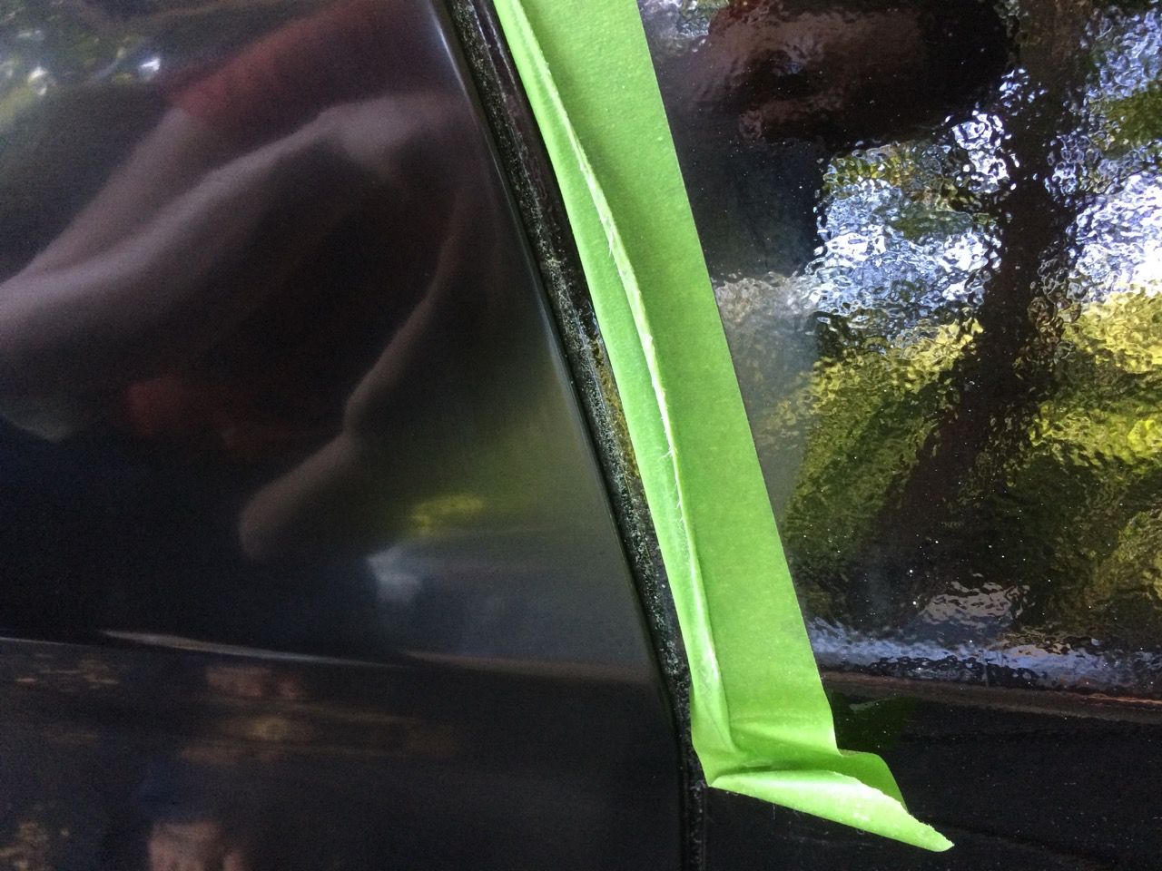

And after clear.. uh oh, orange peel!!
At this point I knew I had to either sand it all back off and start over, or sand off the orange peel. I had a good 3 coats of clear on it, so I decided to try sanding it off first since I thought I could do it without breaking through to the basecoat.
I ordered a pack of Mirka Abralon 1000 & 2000. Unfortunately, these lasted about 10 seconds before they clogged up so bad that they were useless

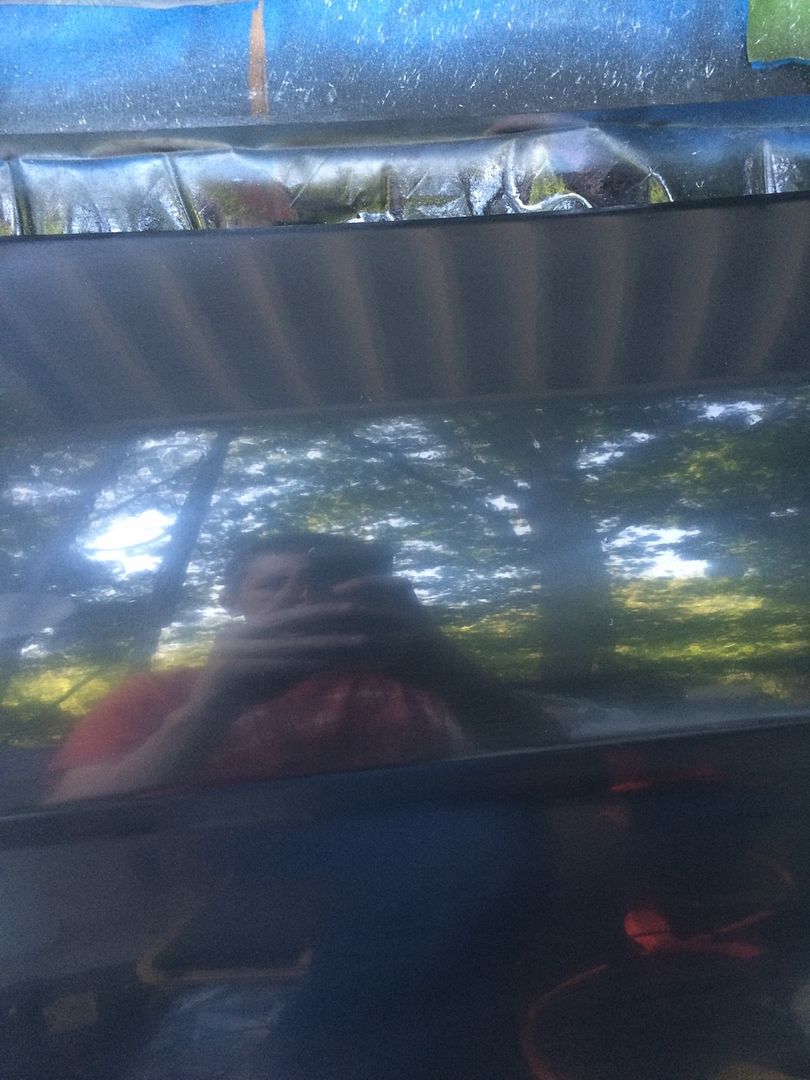

Next up I ordered a pack of Trizact 1500 and 3000. While not cheap, these did much better. I still went through probably 5 or 6 of each grit before getting all the orange peel out. Here's a before/after comparison where I was mostly done with the door but hadn't touched the fender:
Here's a close up of the "after"
Before:
After:
You get the idea.

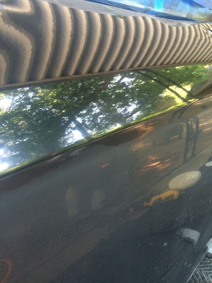

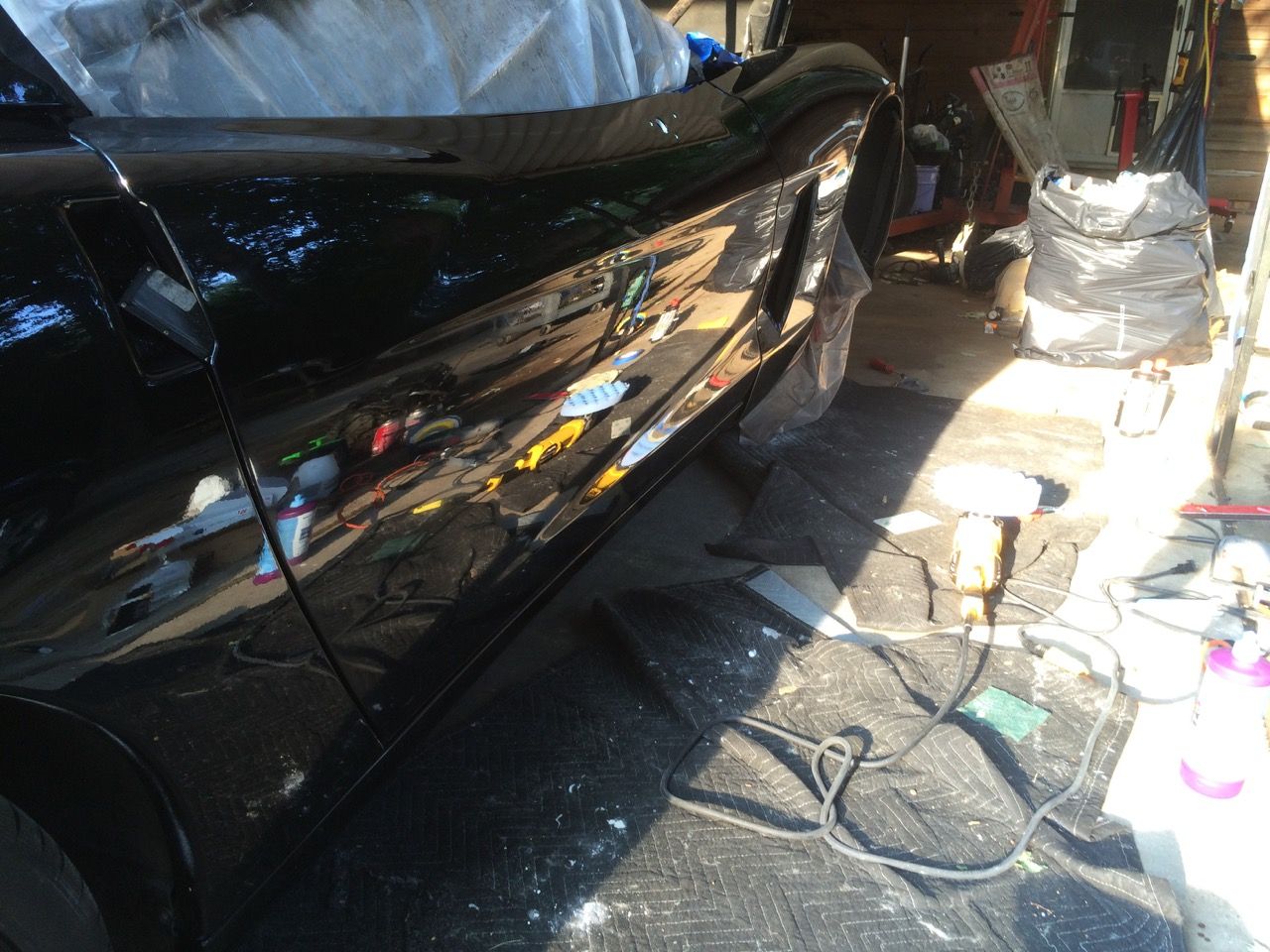

Here I've started buffing the top, but the bottom is just sanded with Trizact 3000. This was buffed with a rotary, 3M wool pad + Chemical guys V32 or V34 (can't remember, I ran out of one or the other halfway through)
And the whole panel buffed out (one pass, same as above)

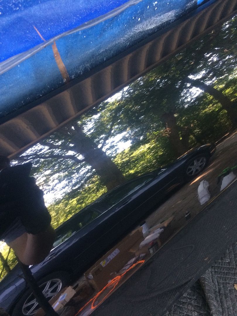

Here's a little section I had left taped to help me not screw up the edges.. so, the left side is buffed, right side is sanded/unbuffed. It's pretty amazing to me the difference a bit of wool and buffing compound makes

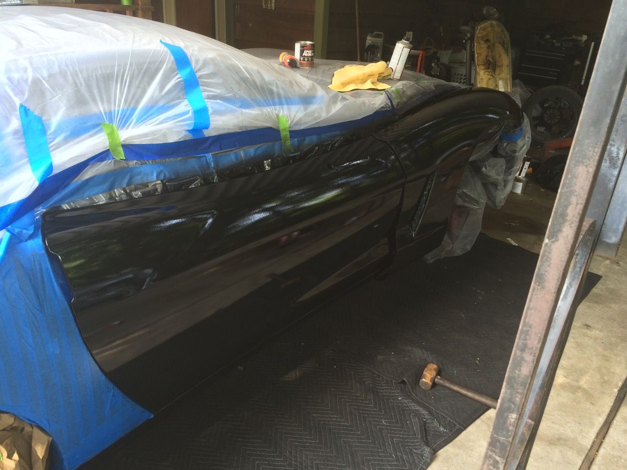

And finally, here's the whole thing after sanding/buffing:
Overall I'd call this a pretty good outcome. Soon I need to do at least a small amount of buffing on the whole car, as it's covered in small scratches and other crud that's accumulated over the last few years. The paint on the rest of the car has a bit of a hazy look to it, while the new paint is very clear. I buffed a few test spots and it didn't take a lot to make the old paint look like new, I just need to find the time to do the whole car.
The repair isn't perfect though to be honest. I found a few small spots (edges mainly) where I sanded through, so I'm going to have to somehow fix those. I'm almost thinking of trying one of those paint scratch fixer pen things, then sanding everything smooth by hand after it dries.
