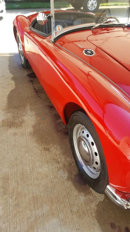

Interior before, notice the sorry state of the mats and how dry and weak the leather looks.

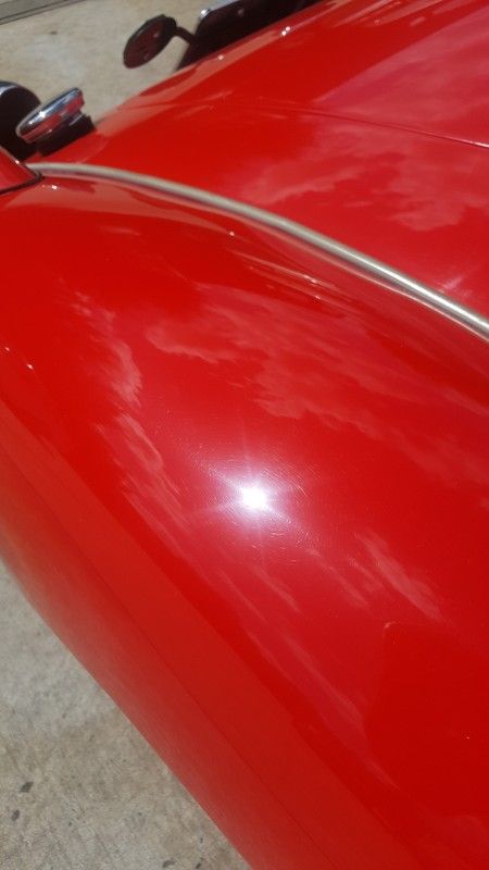

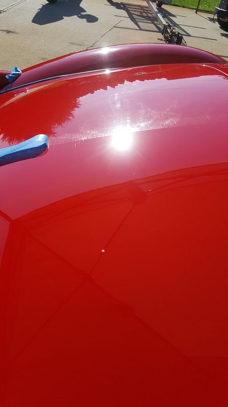

Original paint condition. Owner attempted to polish it himself

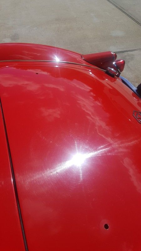

This was the best spot on the car before

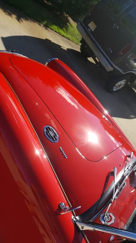

50/50 of the UHS system on the trunk which was the worst part of the car

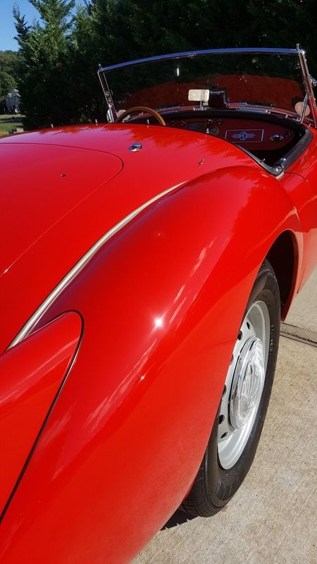

Finished side

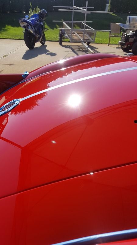

All polished up and ready for LSP!

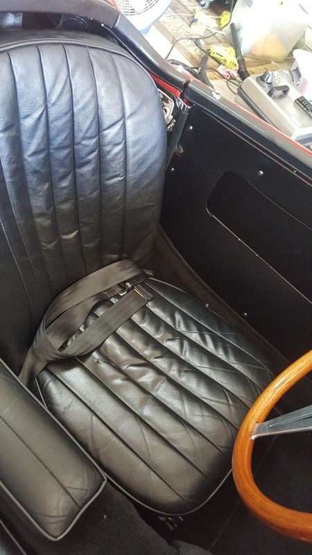

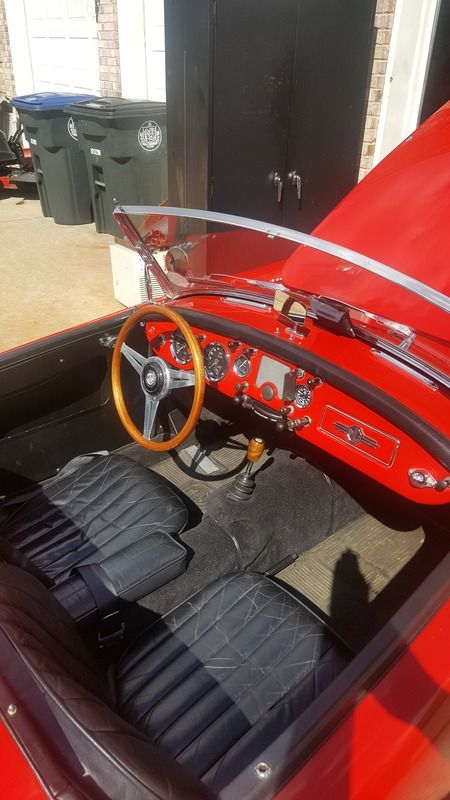

Gave the interior a knock out punch with an 18 hour application of leatherique

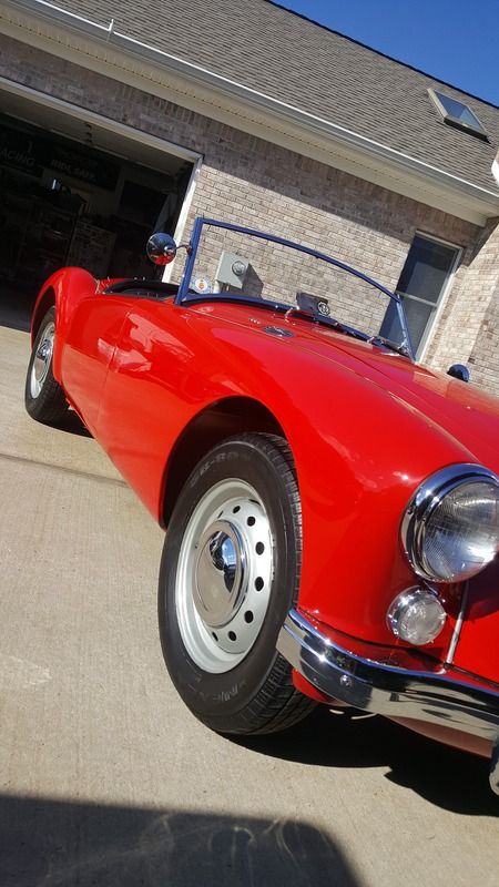

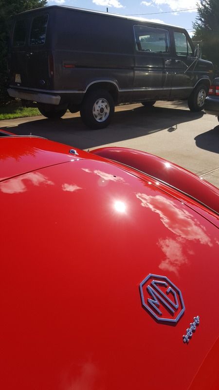

Finished Product!!!!

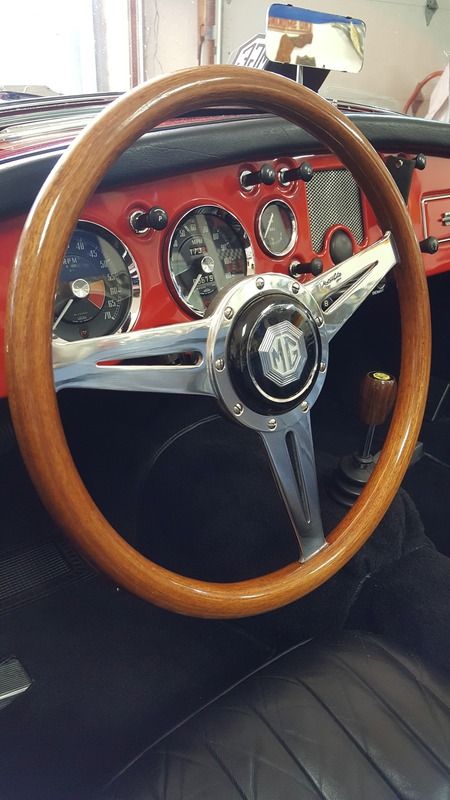

And here's the steering wheel after polishing. I didn't want to make it a mirror finish
