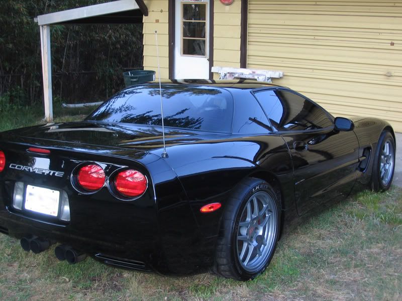

At least three years since it was waxed

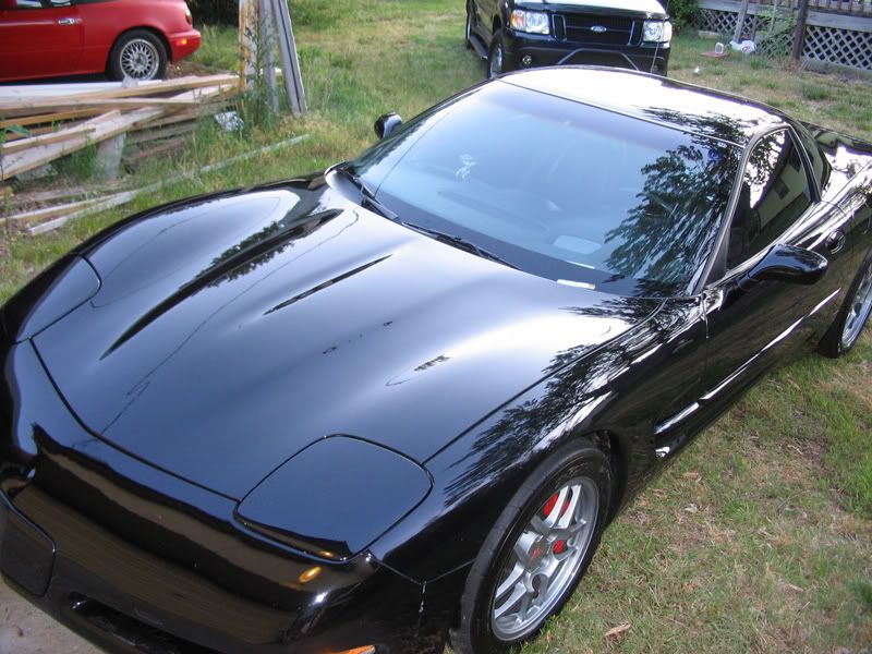

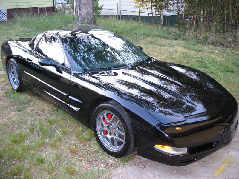

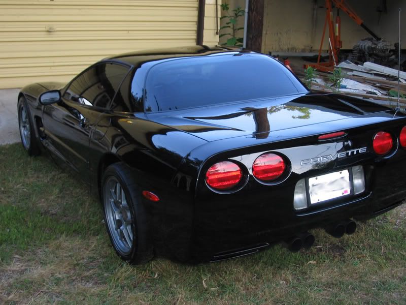

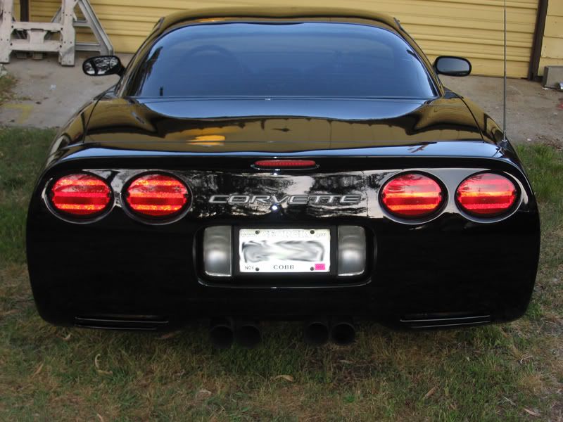

This vette has been neglected, only washed a few times in the last three years. This black FRC has TEA heads/Futral Cam & Tuning 436hp/415tq and a few more mods.
Interior
DP Interior Surface Protectant on dash/door panels/console. On the leather was Pinnacle Leather Conditioner. Inside windows I used Diamondite perfact vision glass cleaner.
Tires/wells
Foam gun with a mix of Op car wash and dawn. Black shmitt and the 16" deep reach wire wheel brush. Wells and tires received no touch
The Gameplan

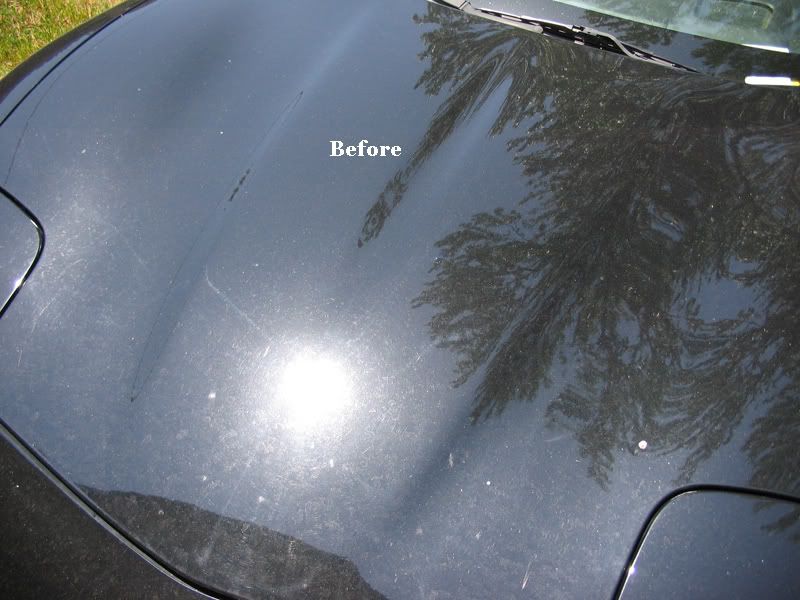

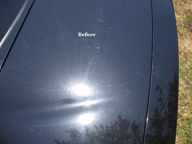

The foam gun with the same soap mix. Since the paint was a wreck, I used the Black shmitt. It was also clayed. Dried it with the WW, then taped off the trim. I used the rotary with a yellow wg pad, and 3M heavy cut. Speed at about 1800rpm. It still had some water etching left. And then used the Optimum Polish with the green edge pad on the pc. Topped it with my new favorite Pinnacle Signature Series II Carnauba Paste Wax.
