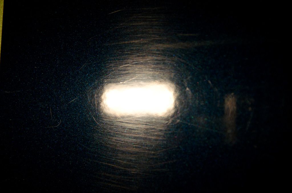

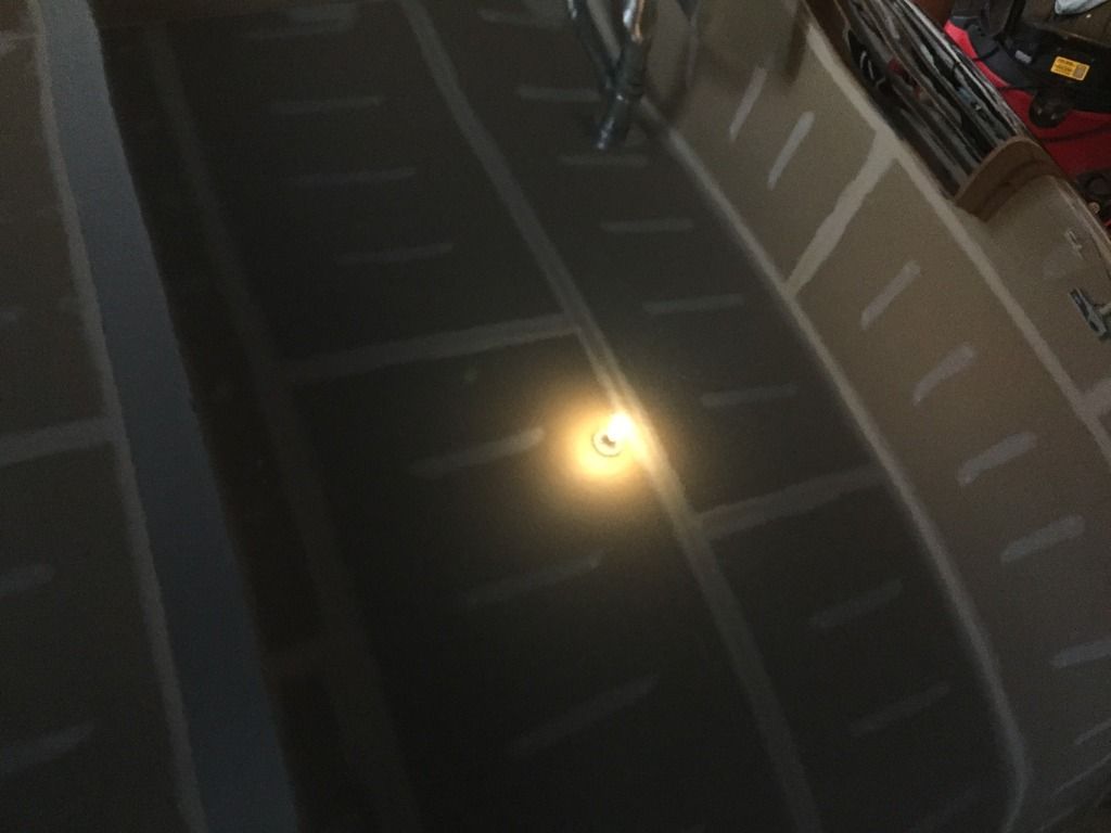

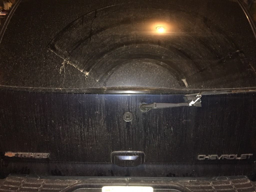

Customer came in for exterior full detail before they put it out for sale.
WASH
  • Pre-soak with CG citrus, using foam gun
  • Two bucket wash with CG citrus.
  • Iron X
  • Tar X

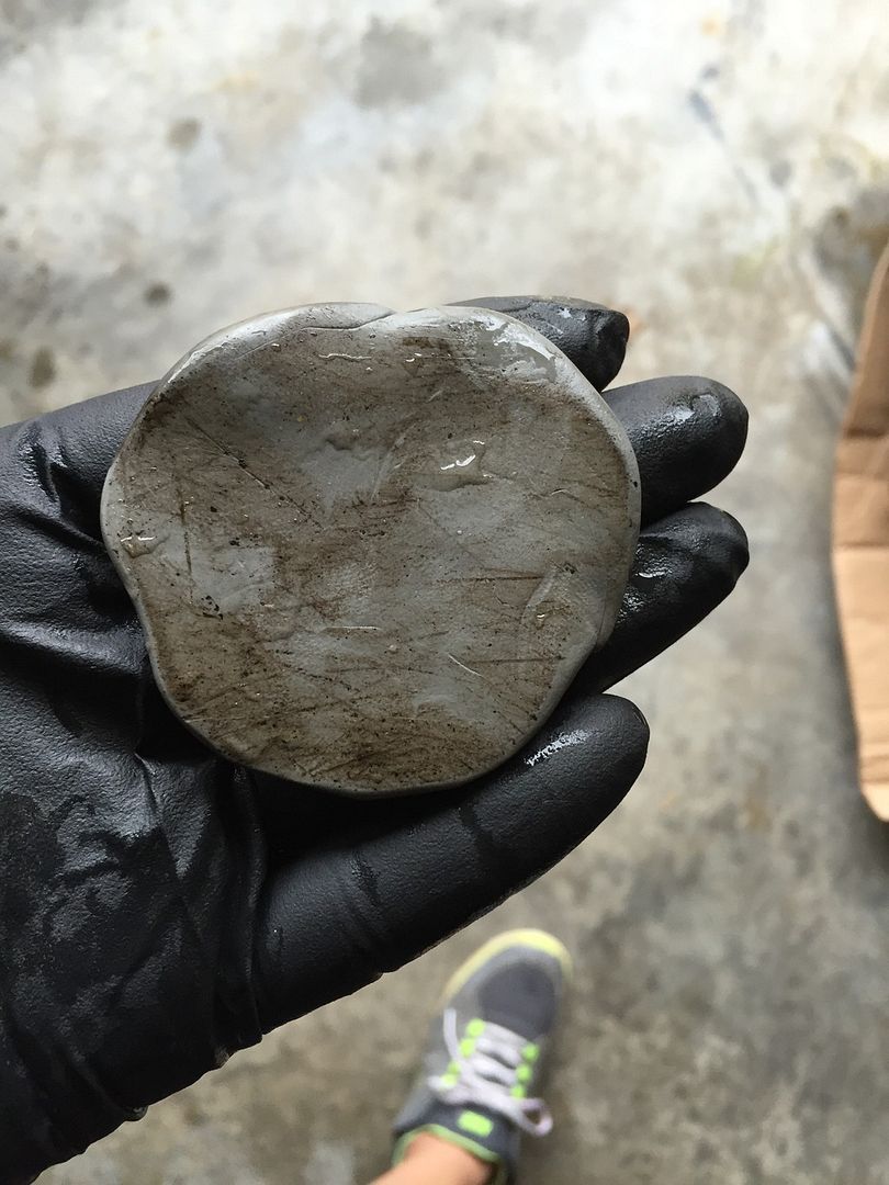

  • Blackfire aggressive grade claybar
  • HD glass cleaner
POLISH
  • PC 7424xp
  • Megauirs D300 with meguairs microfiber DMX pads.
  • Menzerna SF4000 with LCC hydro orange pads
LSP
  • Blackfire Crystal Seal Paint Sealant
  • Wolfgang Exterior Trim Sealant
  • OPT-Bond tire dressing.

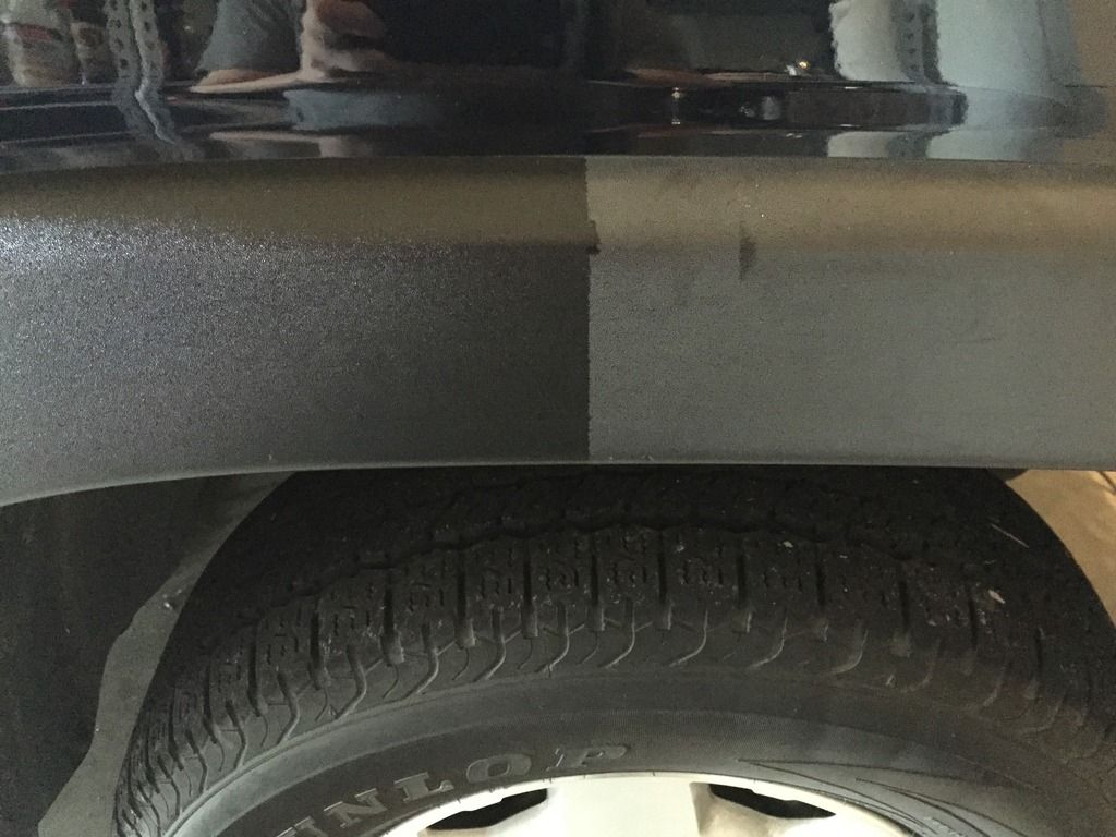

Before
[/IMG]

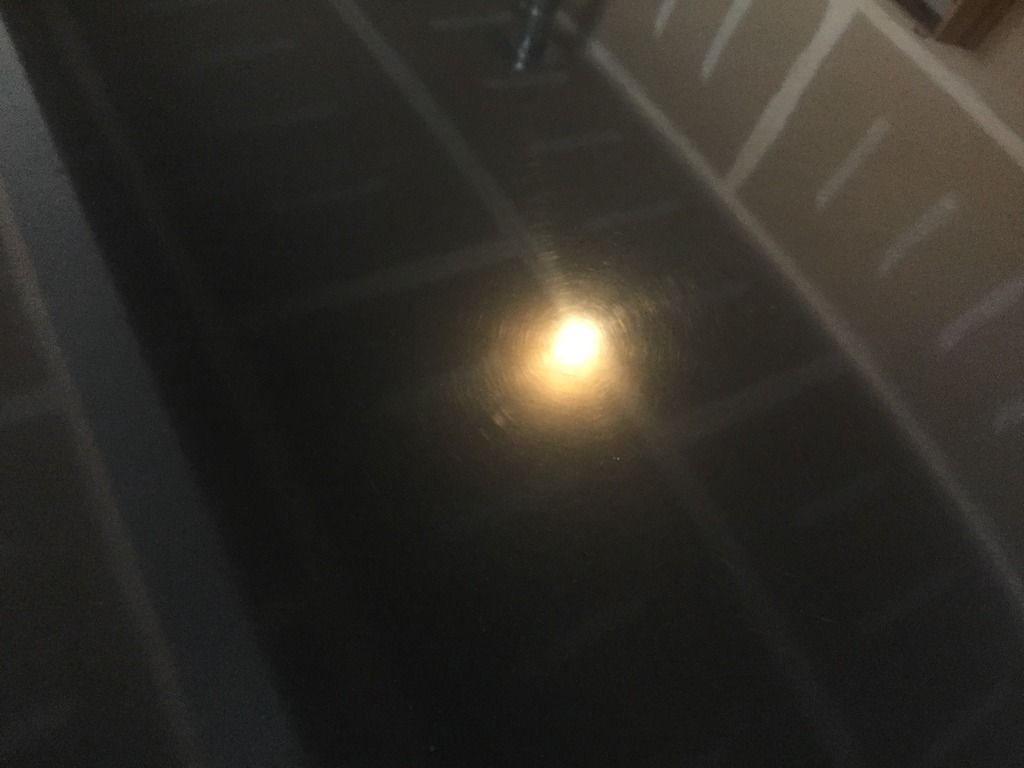

After
Great transformation. It really looks good.
Ed
Thank you,
I am glad owner was satisfied.
Nice job!
Those 7424XP's can still correct!
haha yes! I dont know why people are complaining how "under power" it is.
with D300 and DMX pads, all I had to do was 3 passes and get it ready for polish it.
I have rupes 21es, but I find myself using PC more than rupes.
(not that I dont like rupes, just 21mm long throw makes it hard to work sometimes)
People who say that the PC 7242XP is under powered don't have the proper technique. The PC needs to be slow with a 2' x 2' section with downward pressure. Although I have a Flex 3401 and GG6". The PC is what Imrelearned how to correct paint. In my early years I used a rotary with wool pad and corn starch.
Ed
Thanks all,
and yes with proper technique, PC can correct most of paints,
only time I had trouble with PC was correcting hard paint, (jet black BMW)
but thanks to all these great MF pads, nothing can really stop me with PC now xD
