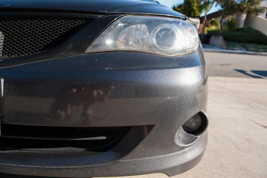

My second detail :)
This is my friends car who is also a photographer, so i was able to get some great shots.

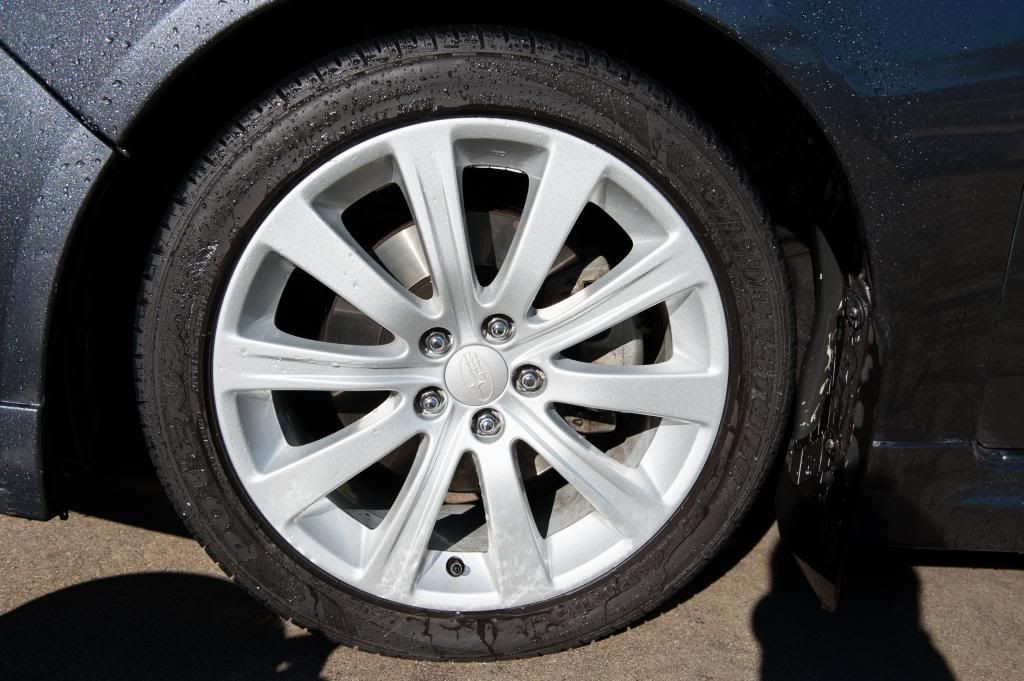

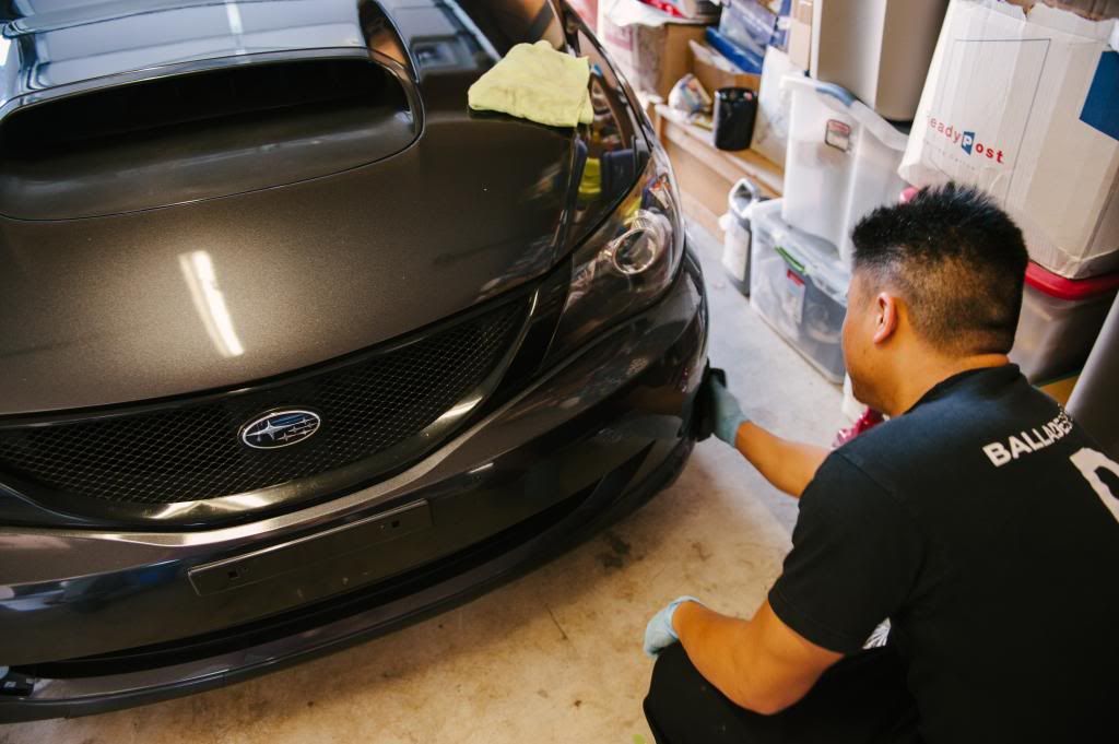

start off with the wheels...
Wolfgang tire/wheel cleaner, CG APC+, various brushes, Iron X, WGDG Spritz sealant, pinnicale black oynx tire gel....

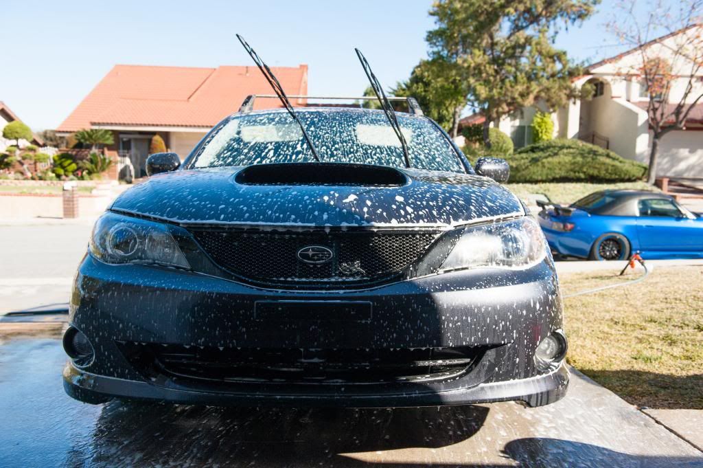

wash and decon...
Gilmour foam gun, CG mr. pink, CG APC+, ironx, speed prep towel...

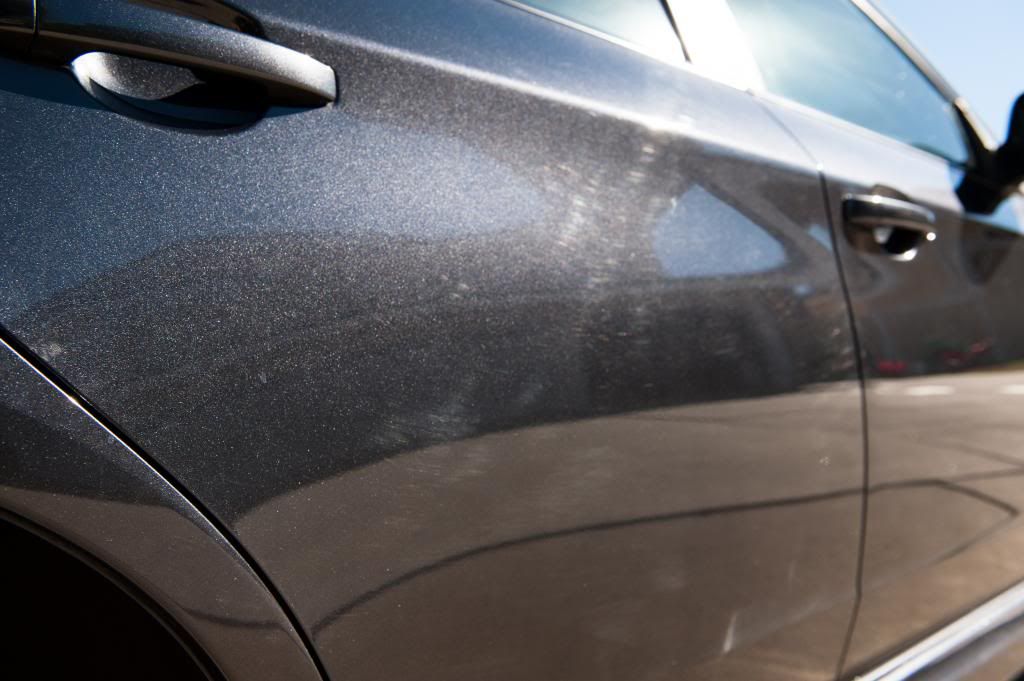

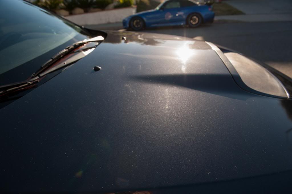

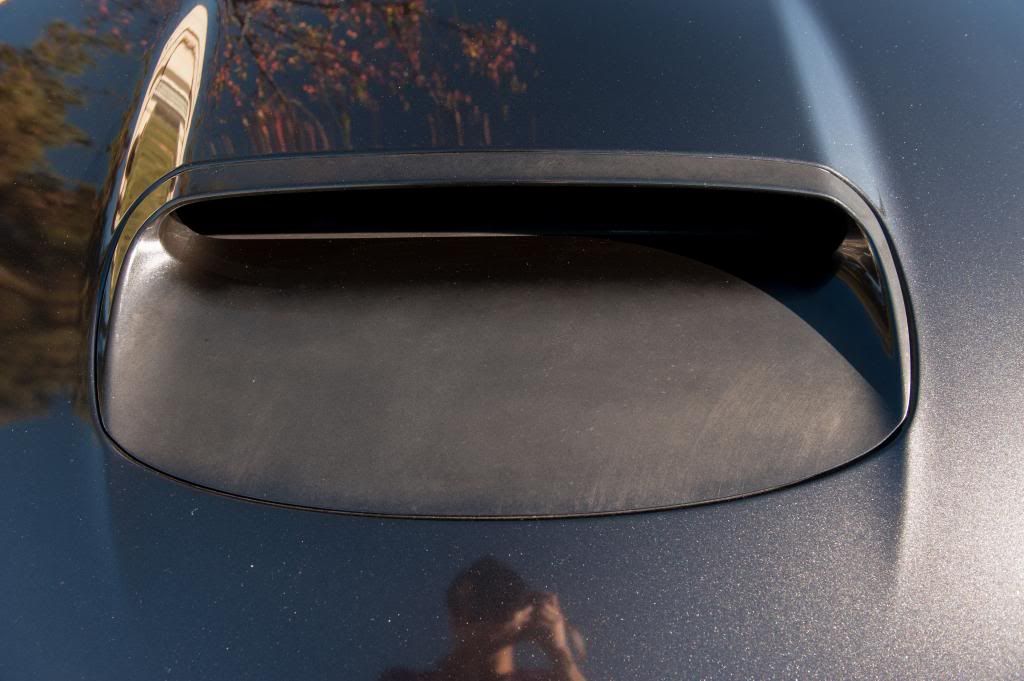

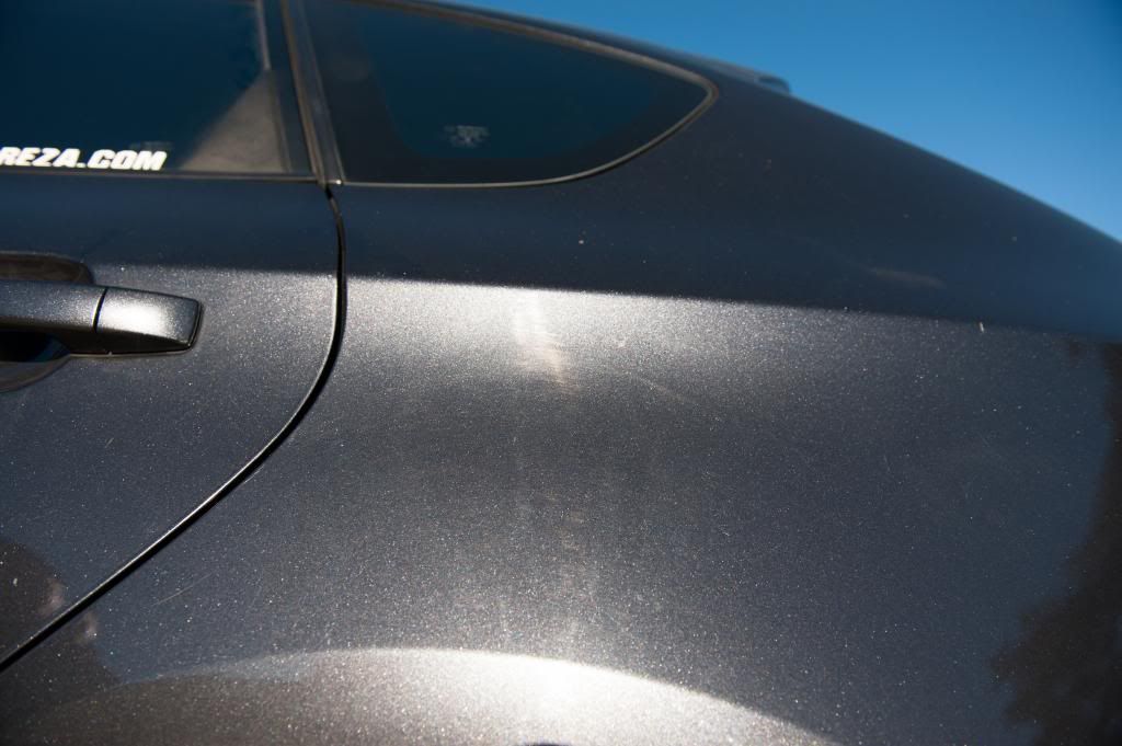

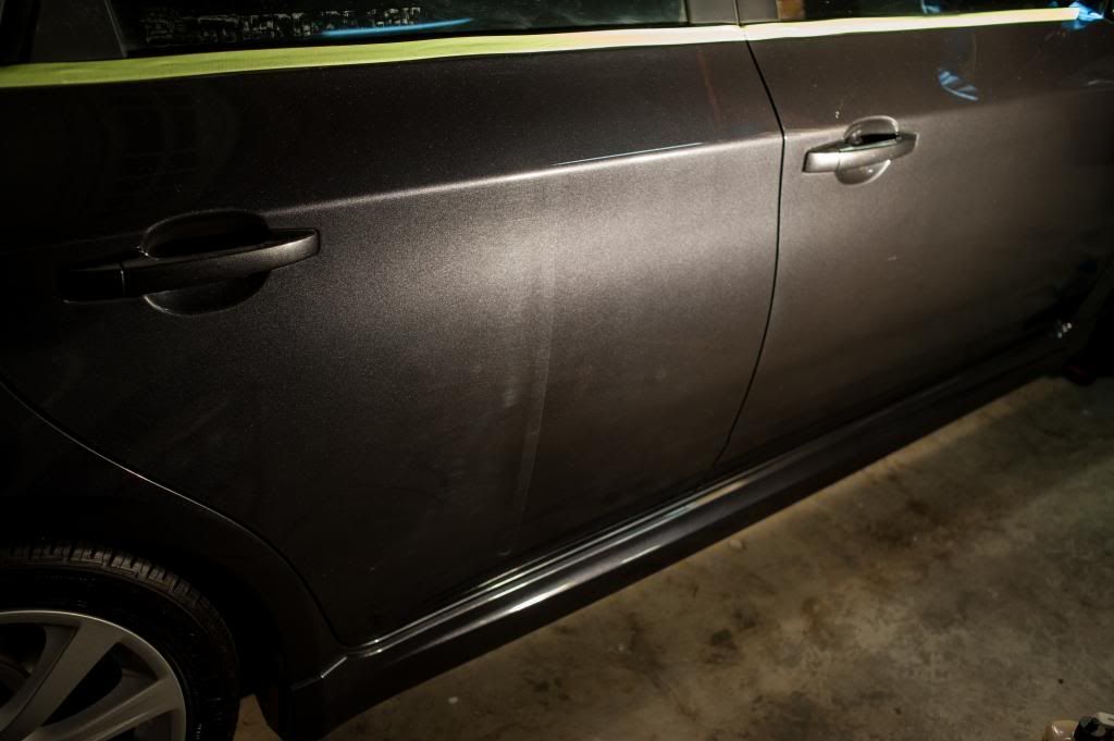

Now for the defects

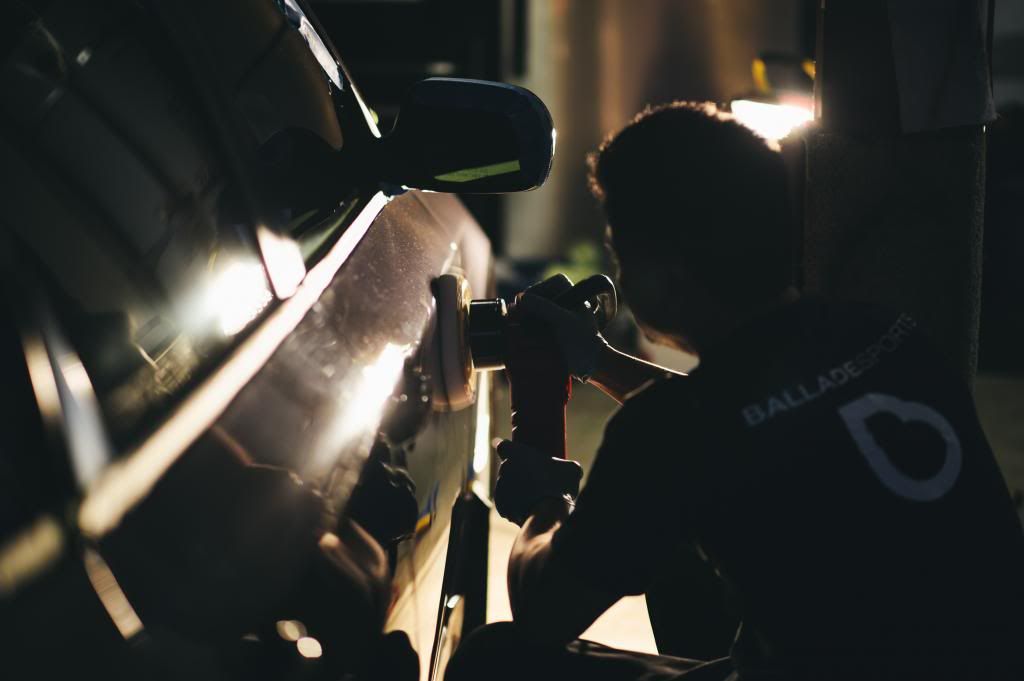

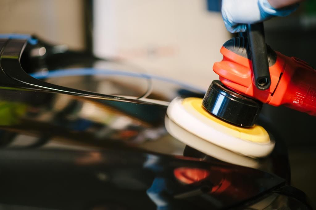

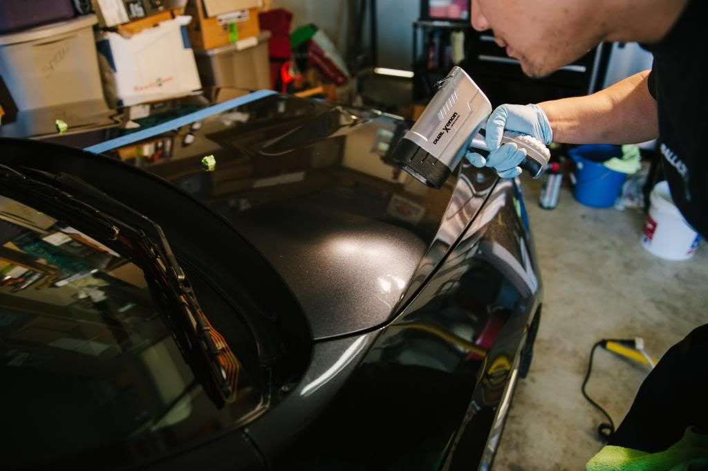

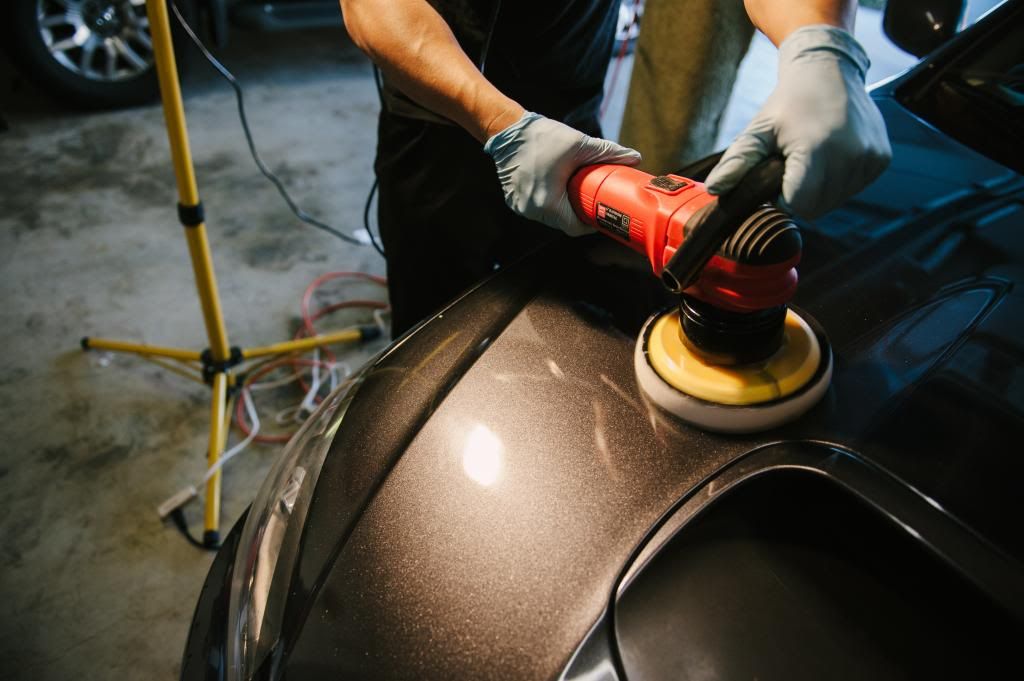

Correction process...
GG6, GG3, LC white CCS, LC grey CCS, Megs 205...

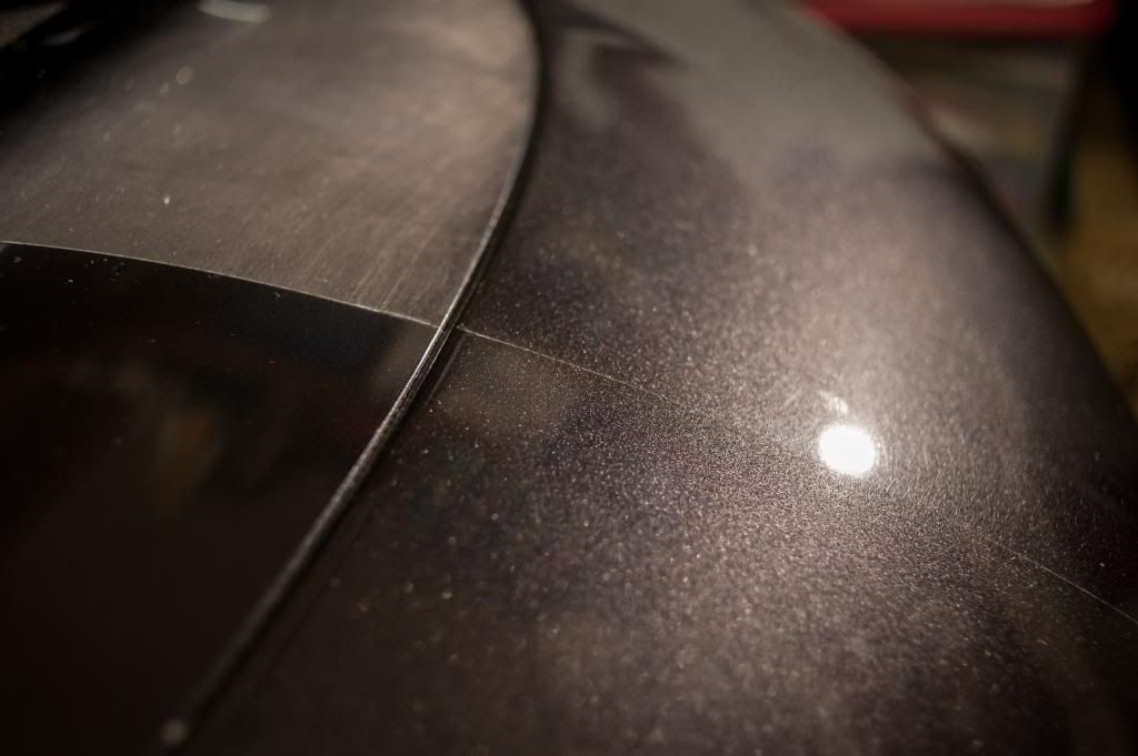

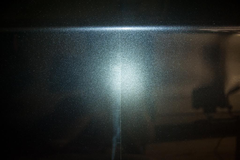

50/50...
continued...
Before and after...

Great 50/50 pics, really shows how bad it was.

That is some solid work right there! Good choice with the 205 and LC white pads. I used that exact same combo on my 2003 WRX a few weeks ago and it removed almost all the defects being that the paint is so soft. 205/white is a good one step Subaru combo from what I have heard and seen!

I spy a white X5 and a nice looking S2K in the background.
Strong work. My 2012 Impreza is the same color and its amazing how easy Subaru paint swirls.

First time working with 205 as well lol But defiantly worked great some areas were corrected with just 1 pass :xyxthumbs:
X5 is my brothers car the s2k is mine :)

Since the paint is so soft this is a great combo...you defiantly want to start off with the least aggressive products you have in your arsenal when working on this type of paint system.
