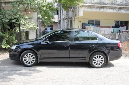

here are a few pictures which are the "afters" since i worked alone and couldnt handle the DSLR with dirty hands [i love my camera and photography too]

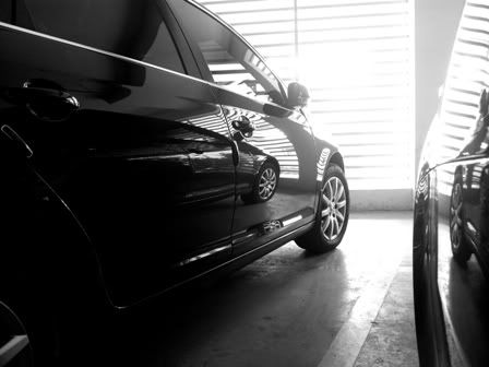

I like the reflection of my friend's black jetta on mine.. do u?
car on the left is mine

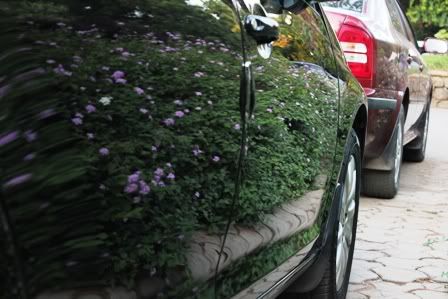

reflection of a small plant with lavender coloured flowers....

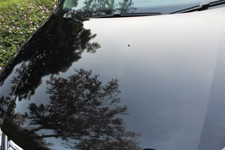

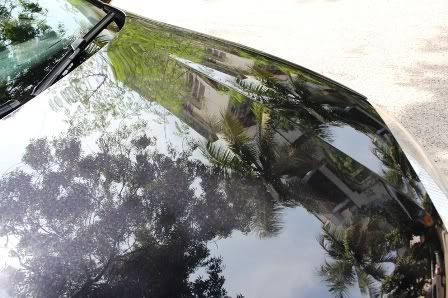

i like the reflection of a crow flying on the bonnet with trees reflected well too

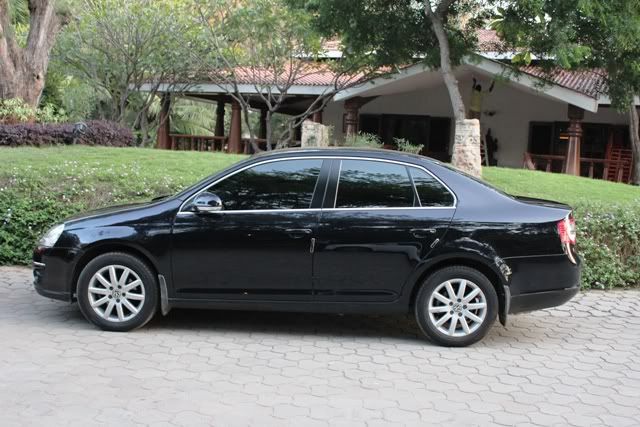

finished "wetter" look reflecting the evening sun at the rear quarter panel

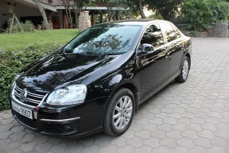

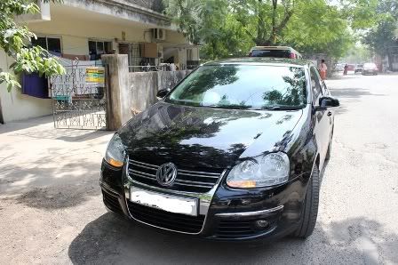

finished and standing outside home

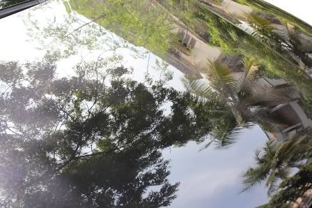

reflection of a tree outside home - like the colors reflected

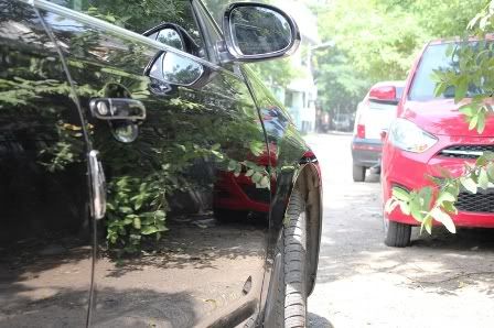

reflection of the wife's car wihch is my next project[red one] and a small plant
