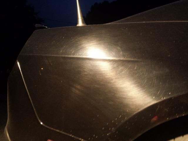

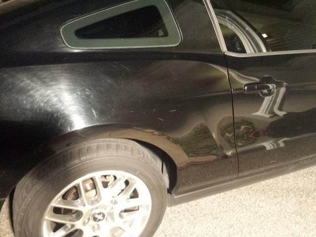

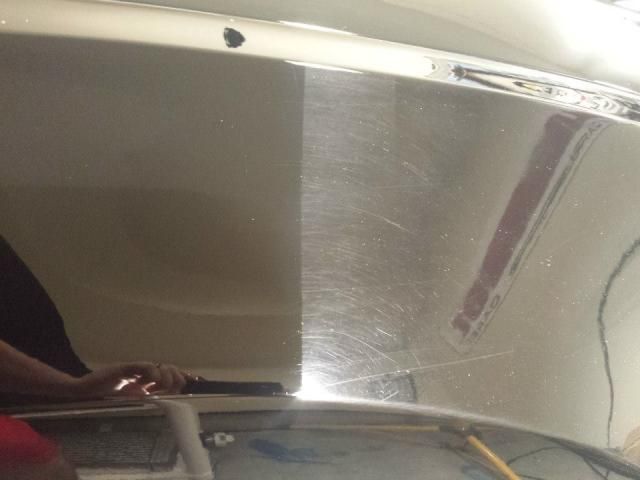

I was contacted by the owner of this 2012 Mustang GT to get the car ready for sale. I was told it was in good shape, but had been run through a local automatic car wash since it was new, I knew those two things could not go together. Upon arrival, and inspection, We both decided that a 1 step correction and sealant would be the best option for his needs. My steps were as follows.
Foam with Nanoskin Green Apple Bubble Bath
wash using 2BM and Bubble Bath
Clay using Nanoskin Medium grade towel and Glide
Polish with PC7424XP using 5" BP, LC Orange Flat pads, and Nanoskin Nano Cut.
IPA wipedown
Seal with Gtechniq C1.5 Silo Seal.

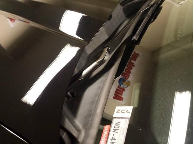

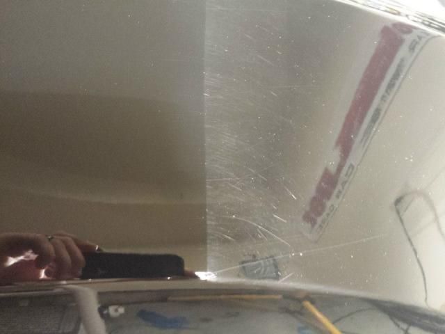

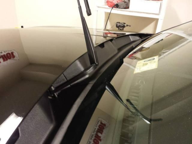

Wiper cowling restored with Solution Finish

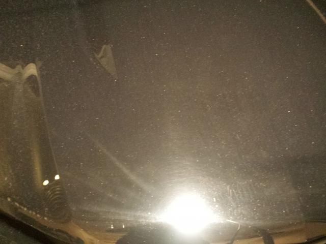

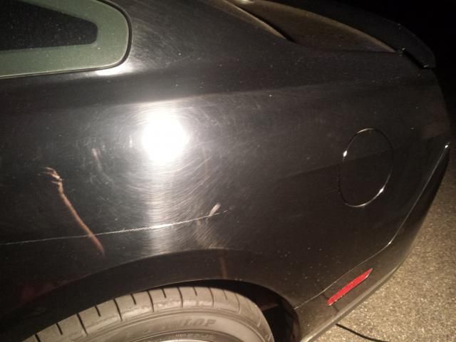

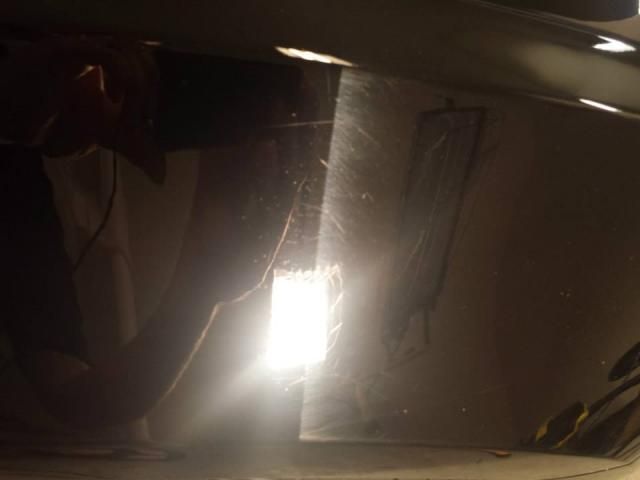

Before

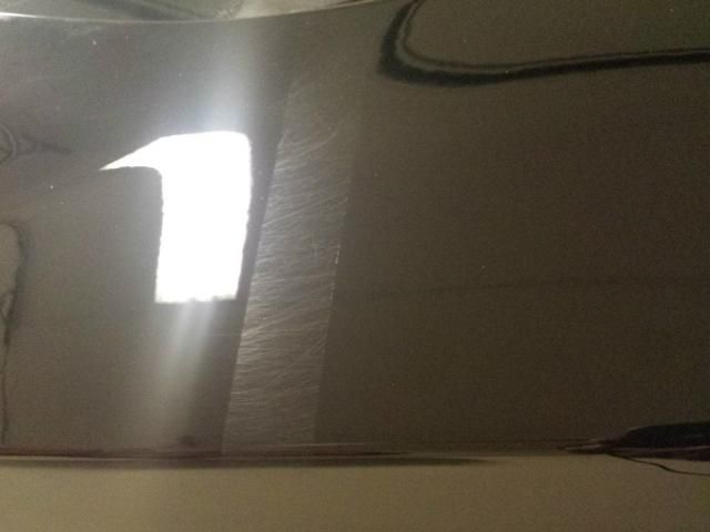

50/50's
Wiper cowling before

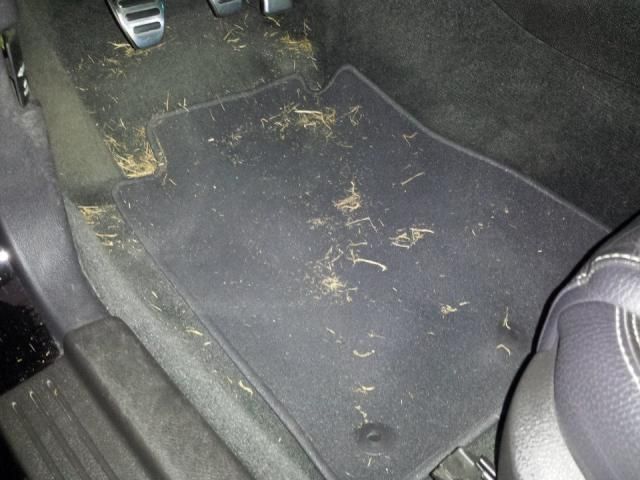

Interior before
Interior after

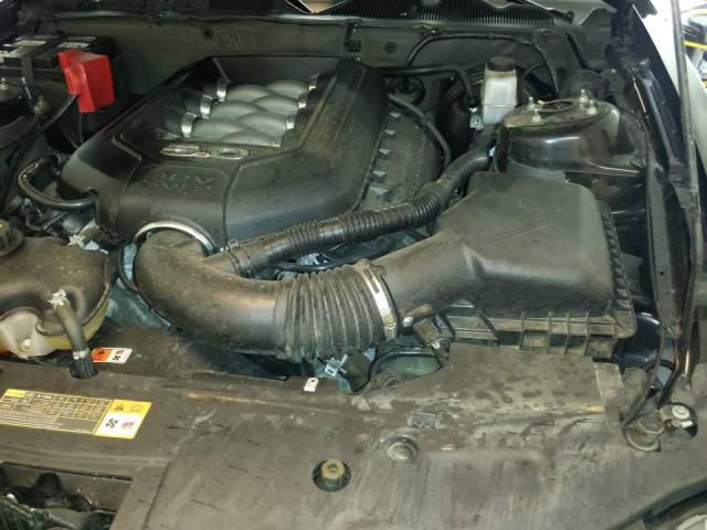

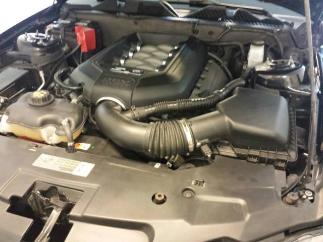

Engine bay before
Engine bay after

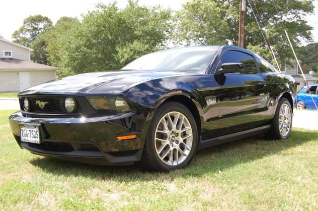

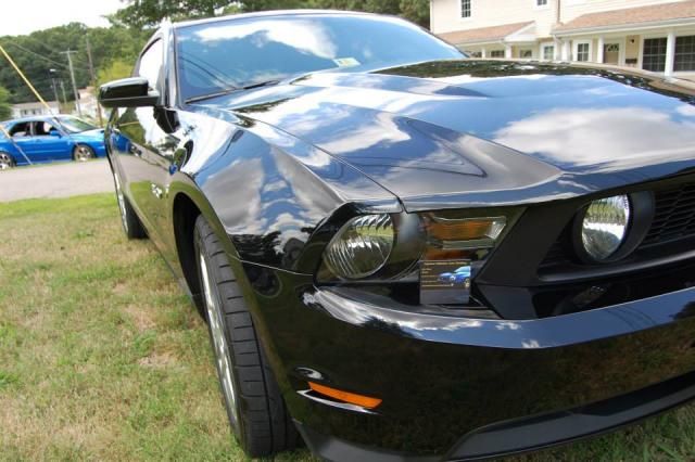

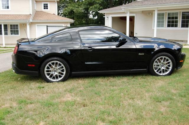

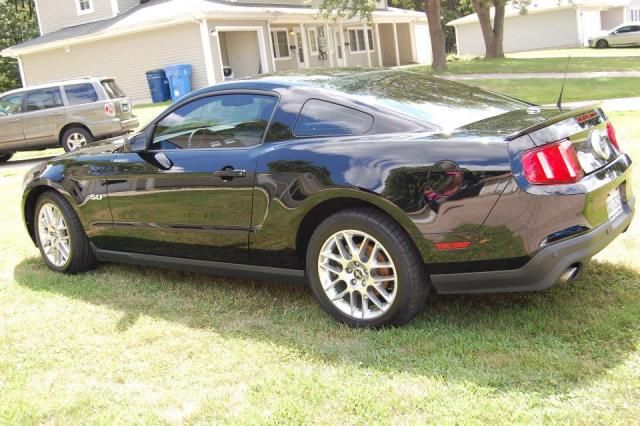

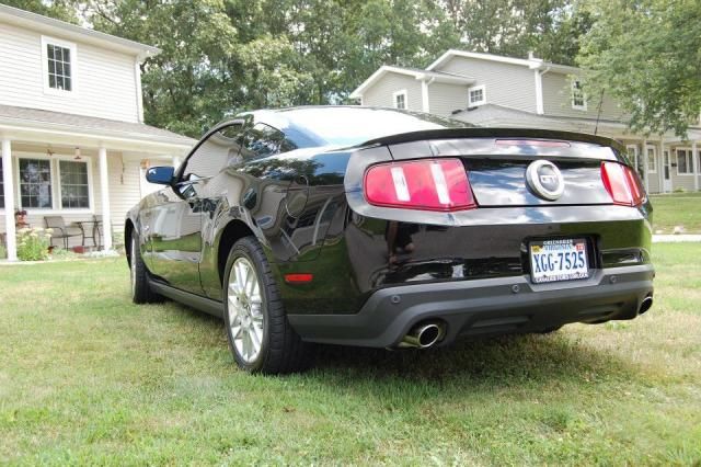

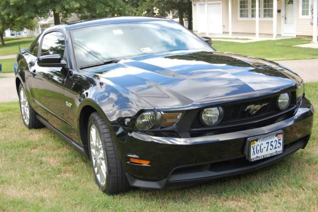

And the beauty shots

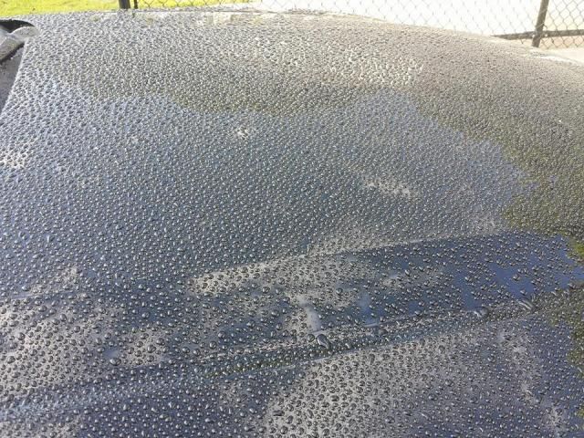

Owner was VERY pleased, and coudn't believe it was the same car he dropped off :) It is now for sale. He did come back for a dust off(is parked next to a softball field), and I got to get some beading shots. To say I am impressed with C1.5 would be an understatement.
Very nice Save! the 50/50's show the hard work! :dblthumb2:
Wow that was in rough shape but you polished it very nicely.
