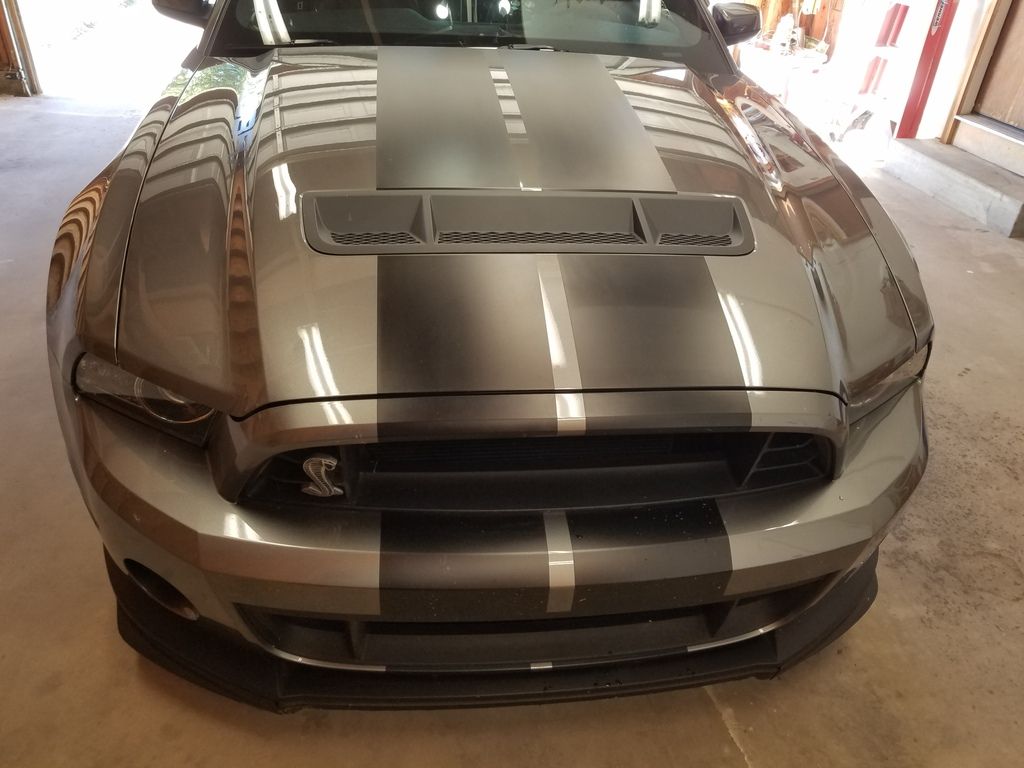

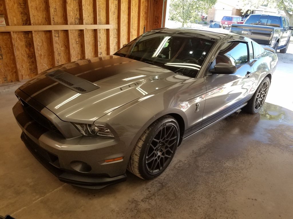

How it arrived:

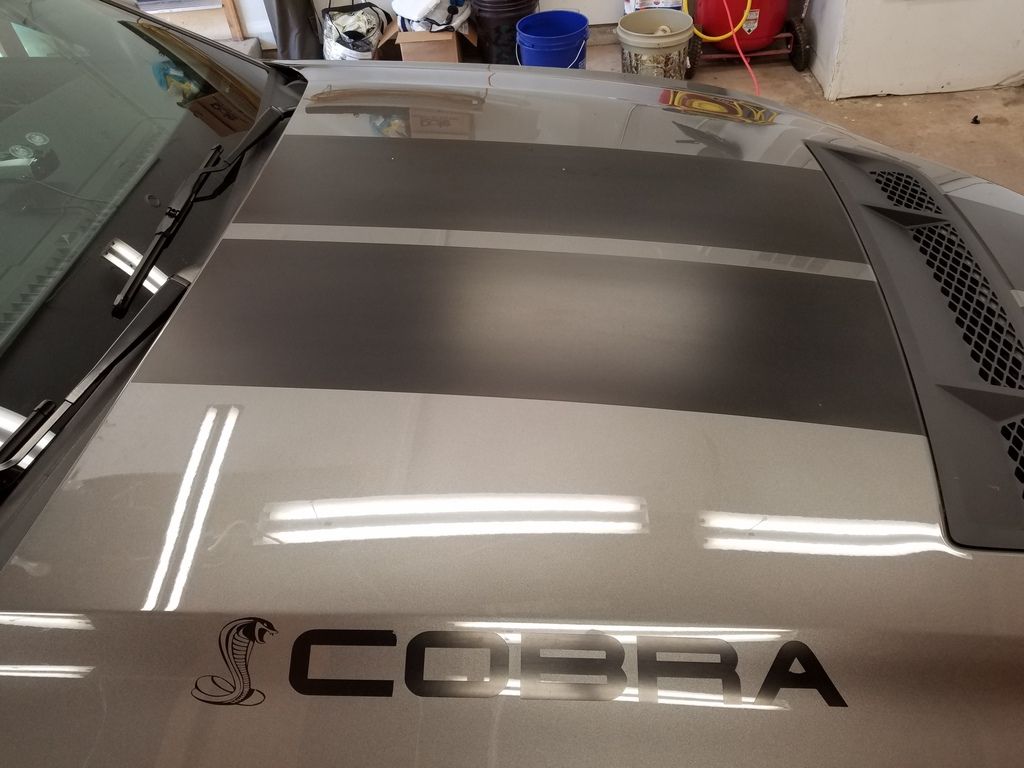

Owner requested I remove the aftermarket vinyl:

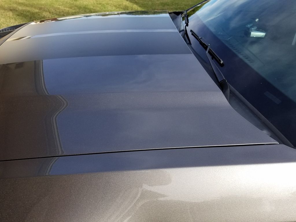

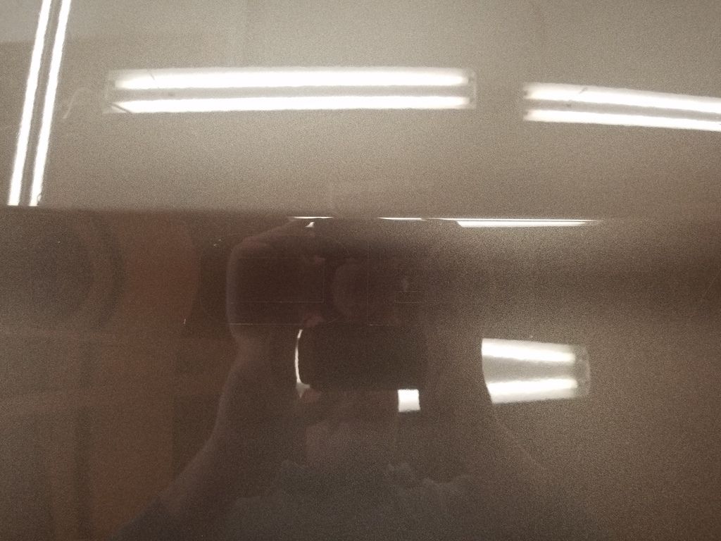

Left with ghost lines: These were actually bad enough I had to use some extra pressure to compound out the lines.
Streaked and water etched matte stripes:
Test spot in an attempt to restore the look and get rid of the shine the previous owner gave them with whatever product was used:

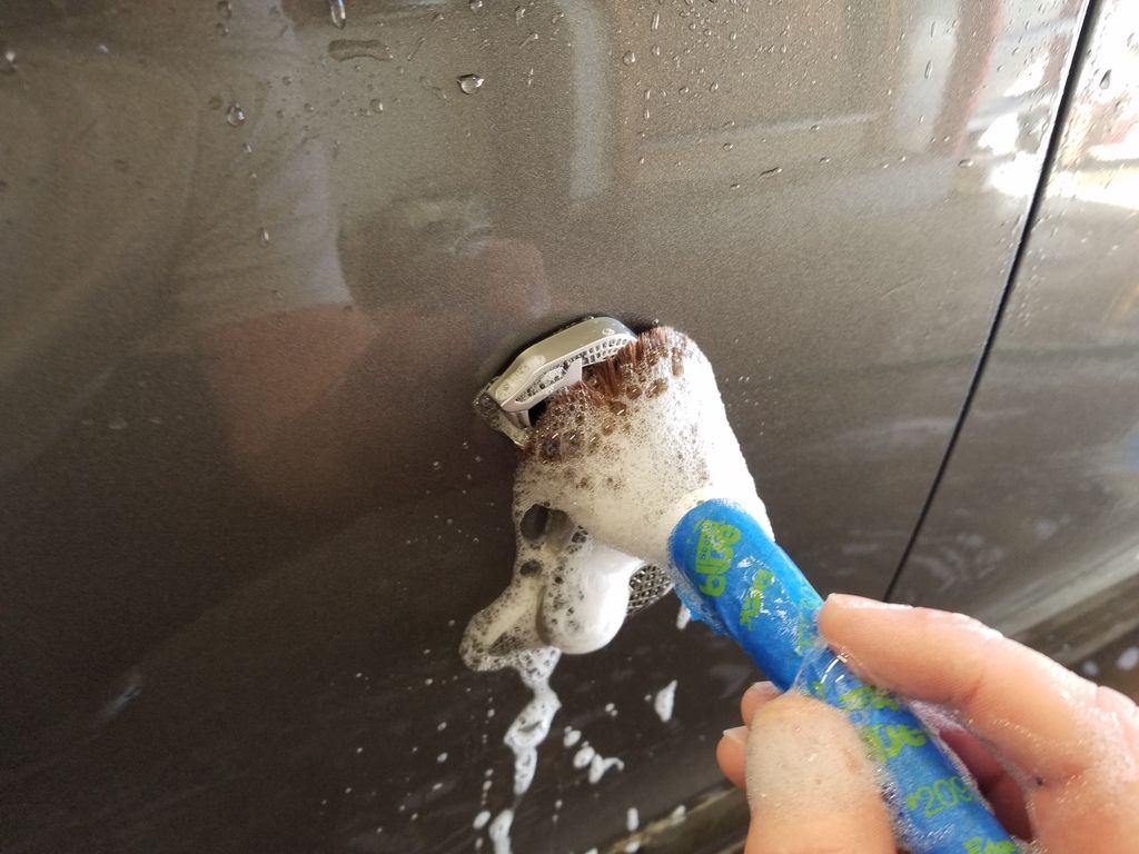

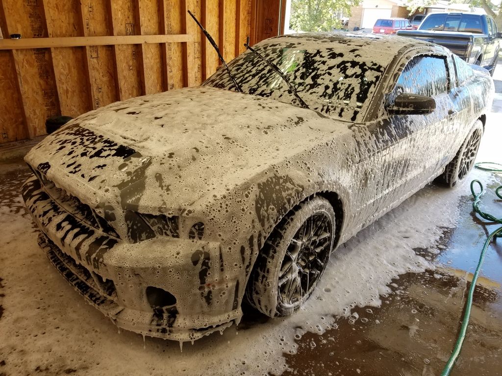

Foam Gun w/Mr Pink:
Looked fairly clean, right? This is just half the hood.

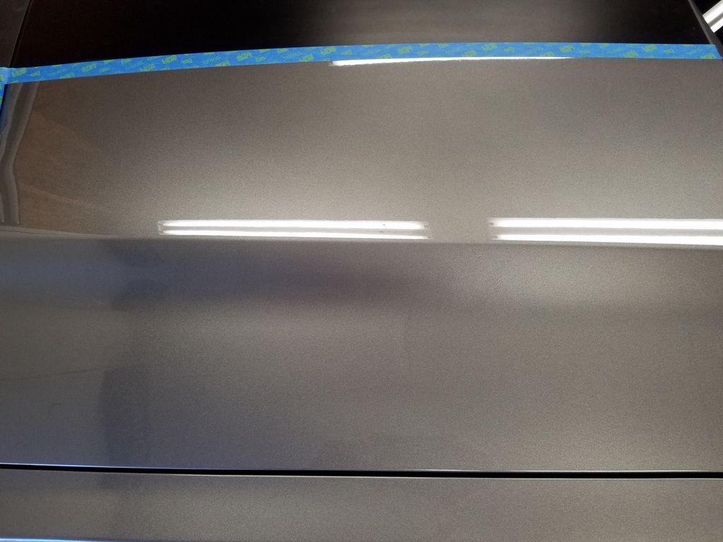

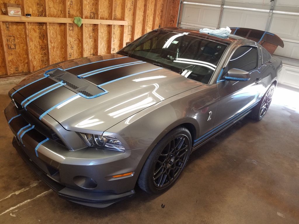

Taped off:

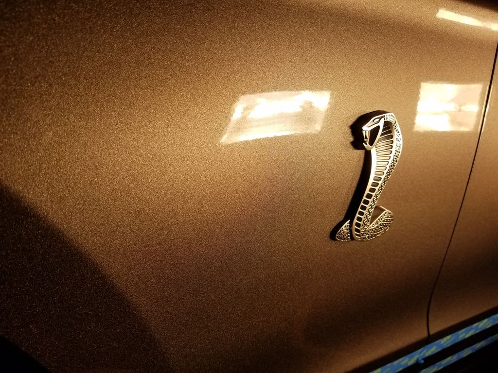

Like I said, I wish I would have grabbed some better before and 50/50 shots but this is after hitting the front fender:
No more ghost lines:

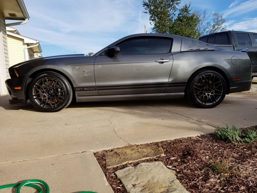

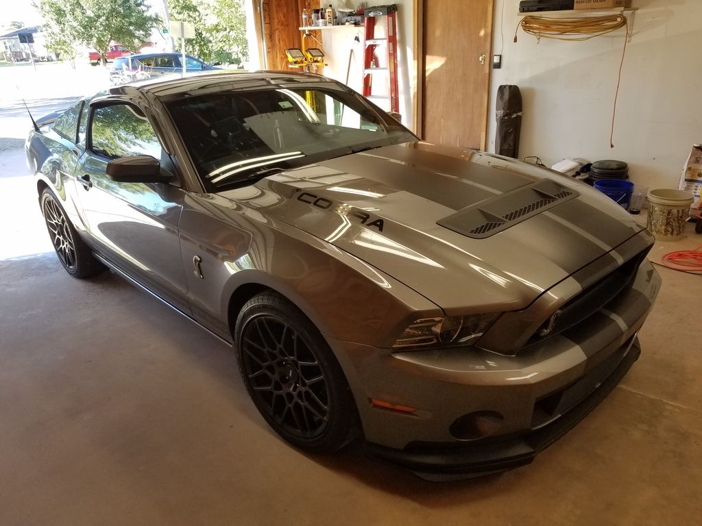

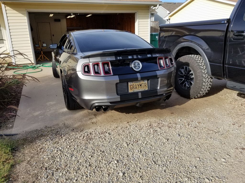

Driver rear 1/4:
Random inside hood shot:

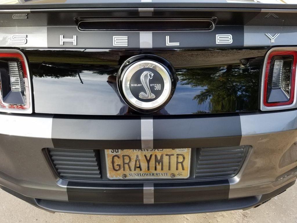

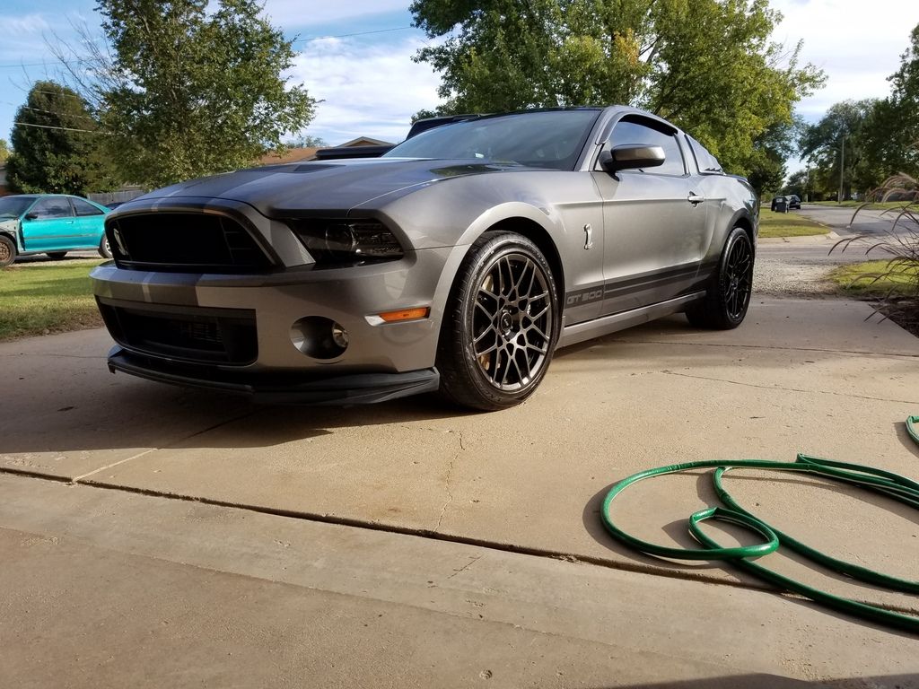

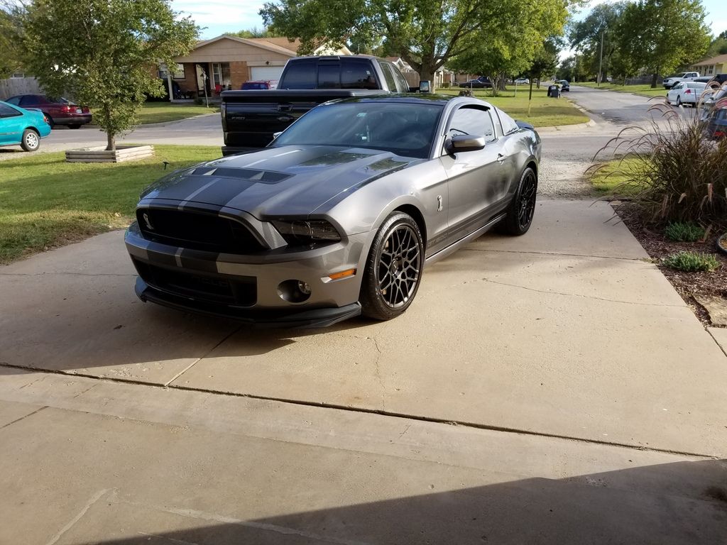

....And outside final (really wish I was better at take pictures and had a better place than my driveway)
Plastic panel was horribly scratched along with the black plastic around the tails. Now roughly 95% scratch free.

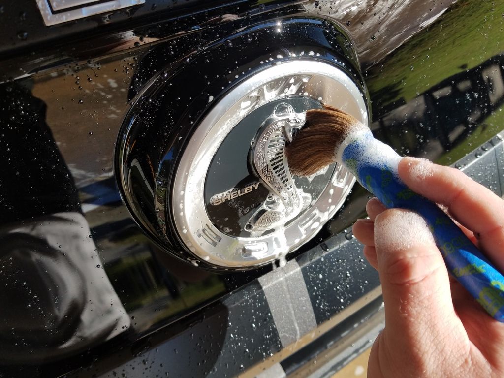

Nice work where did you get that brush that you used on emblems?
Thanks guys, it was a good weekend for Mustang details. Especially since I am a Mustang guy at heart. Both the Shelby and the Roush went directly to a car meet after leaving my house.
It's actually a make up brush. I'll have to do some digging to see which one but over the years I've tried several different ones for various jobs. This particular one is soft enough for paint but has stiff bristles for emblems.
