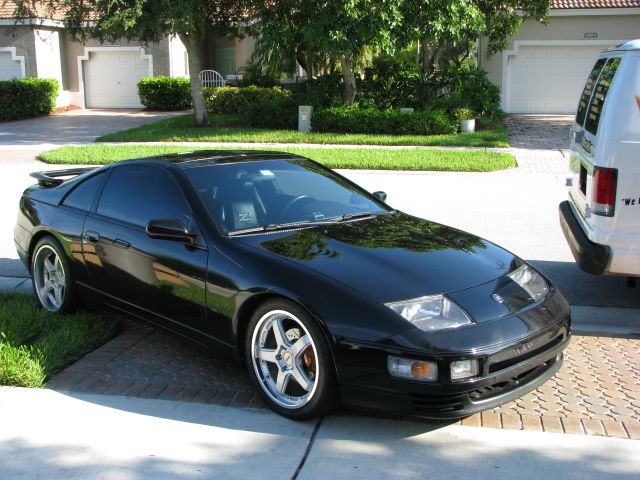

This guy is very into his cars and he definitely keeps all of them very clean but he was also aware that he needed to do more to the ZX than just a wash and wax.
He waited about a year to call me because he wanted to finish other projects, as you can see the interior is flawless, he put on new wheels, stereo system and engine work.
I definitely spend way more time on it than anticipated, mainly because there were issues i had not fully evaluated and this must have been some of the softest paint i have worked on in....forever.
In many of the pics you can see the swirls removed but still see plenty of patina in the paint. Every time i wiped off polish residue , the towel would create some lines in the paint again. Very frustrating, but in the end he was very happy.
