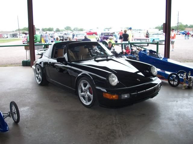

Just bought this 91 Porsche 911 Targa about 3 months ago. Love the car and use it as my daily. Paint job wasnt perfect so I repainted the whole car and wetsanded with 2000 grit to make it look real slick. PPG base/ clear paint. The car turned out great but no matter what I do I cant seem to get out all of the buffing swirls. I used 3m ultra cut compound with a wool pad to get my scratches out. I then turned to a black foam pad with m205. Then I used a blue finishing pad on my rotary with 3m ultra fina. I only see the swirls in the sun. Paint is now cured enough to wax but I dont wanna wax it or glaze it just to hide the swirls and they come back after a few washs. Here are some pics of the car but you cant see the swirls cause its in the shade. Any help or advise will be apprecited. Also what wax should I use? Thanks in advance
