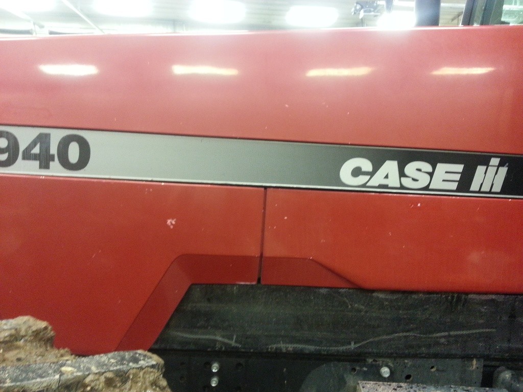

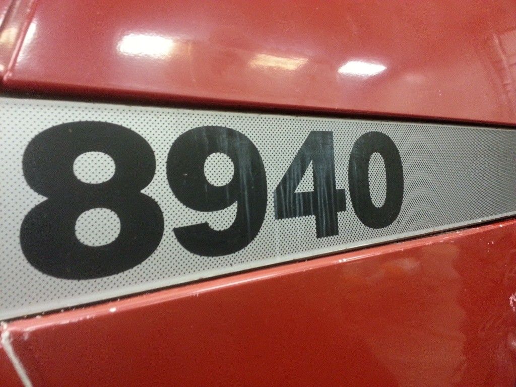

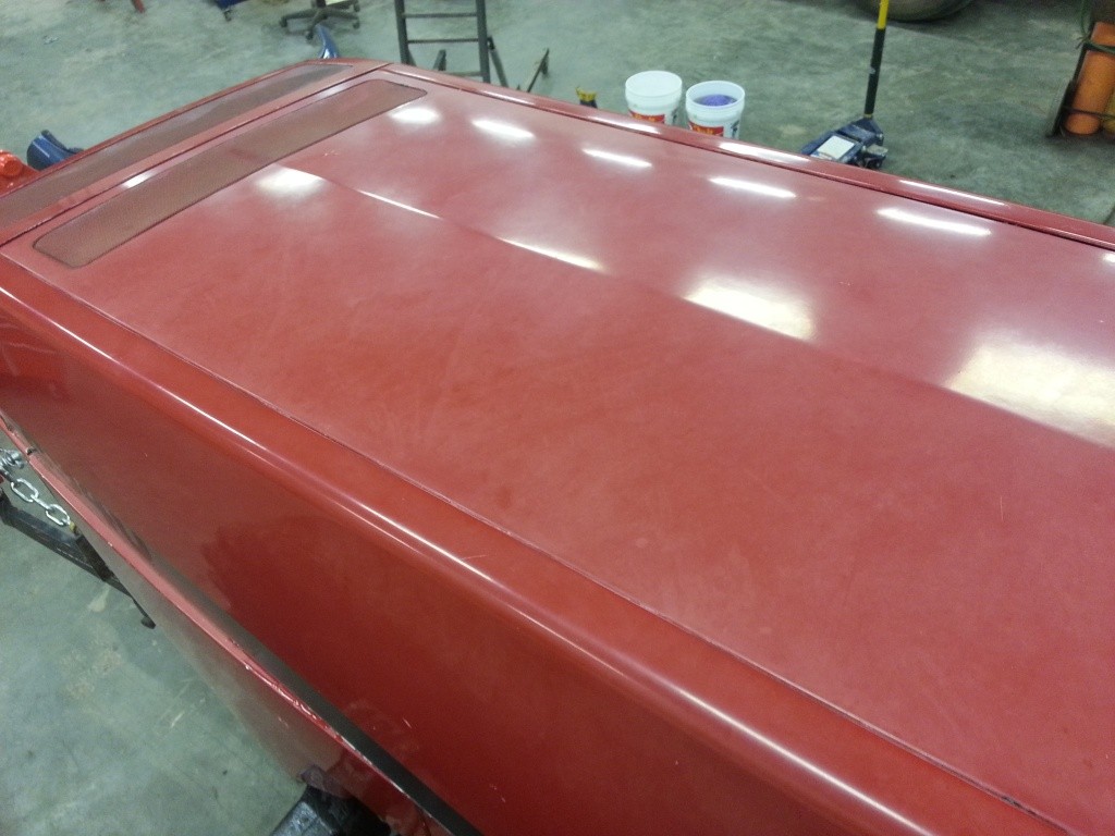

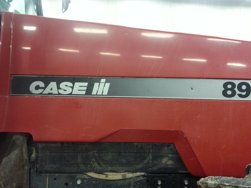

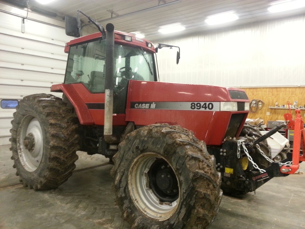

Just finished a sun beat 2010 dodge ithasca.It took me 3 hours just to wash this thing.This finish was flat as Sheetrock.Buffing solely wasn't gonna get the job done properly.Dampsanded with 2000 then sonax cut compound with a wool pad on a gg6, then refined the gloss with menzerna fine cut and gloss on a orange thin pro pads.If you care to look it's on my Facebook page st lucie auto spa.It took 13 hrs for a 2 step cut and polish came out like glass.sonax came through on this one and the mighty gg6.
I don't have any experience with these, but like paint try a test spot or four if you have some products to try.
You could work a couple of sections next to each other with the same combo in an area that is not consistently faded and see what it looks like. If it is inconsistent looking, maybe it would be better to wet sand it?
Did the coating that the detailer applied add any gloss?
Could some quick fix "cover up" coating, if it were used, cause him/you any problems?
Heck this thing was so bad I sanded over the graphics.probably one of the worst I've done never been washed since 2010.Sat on a farm forever.
