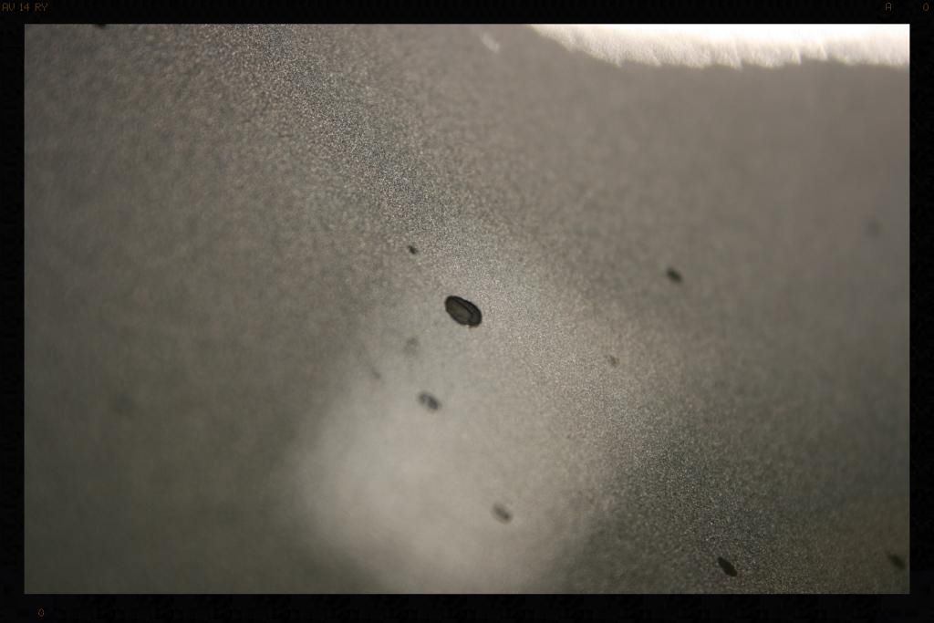

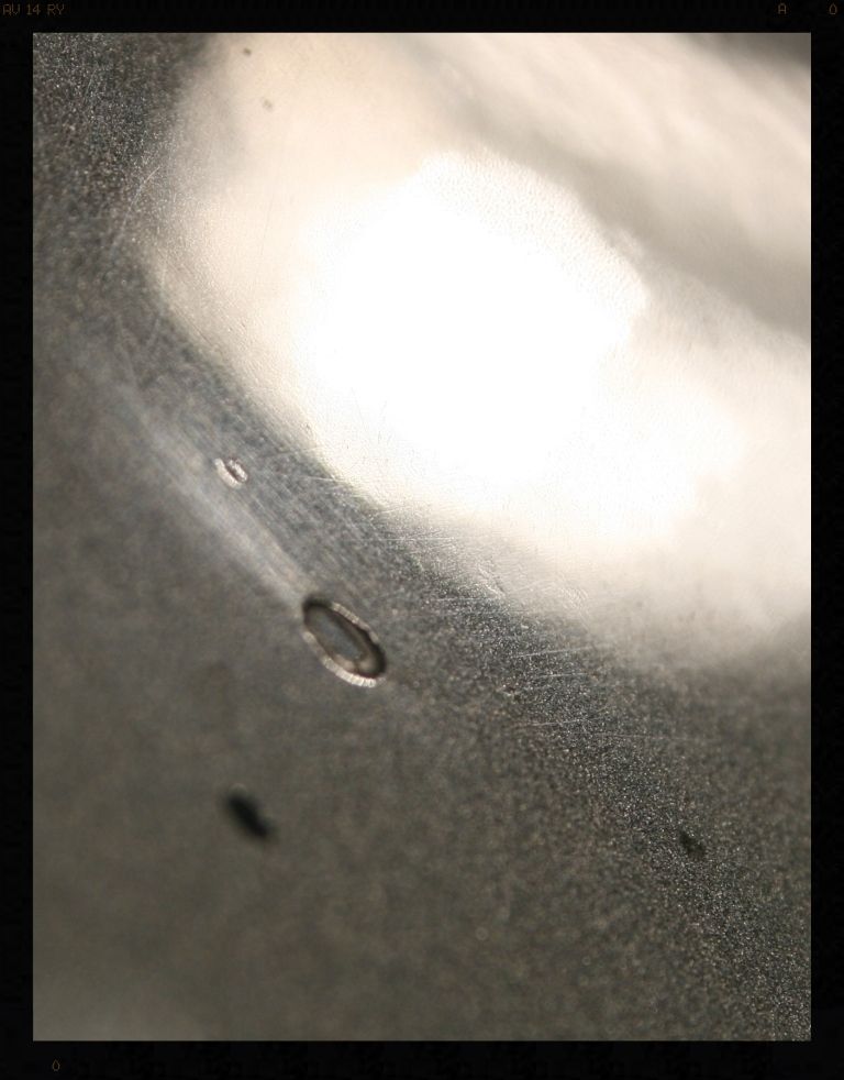

Anyway, I then pulled out my camera and snapped a close up of another spot, and then I realized why I could not get rid of these marks...
zoomed in really close you can see that whatever this product is that (in my opinion) blew onto his car, it has eaten through the clear, base coat and primer down to the metal
I was obviously disappointed that I couldn't help the guy out, and he was absolutely gutted knowing he is in for a full re-spray on the entire car....

Thank you for the follow up.
Those pictures really answer a lot of questions.
