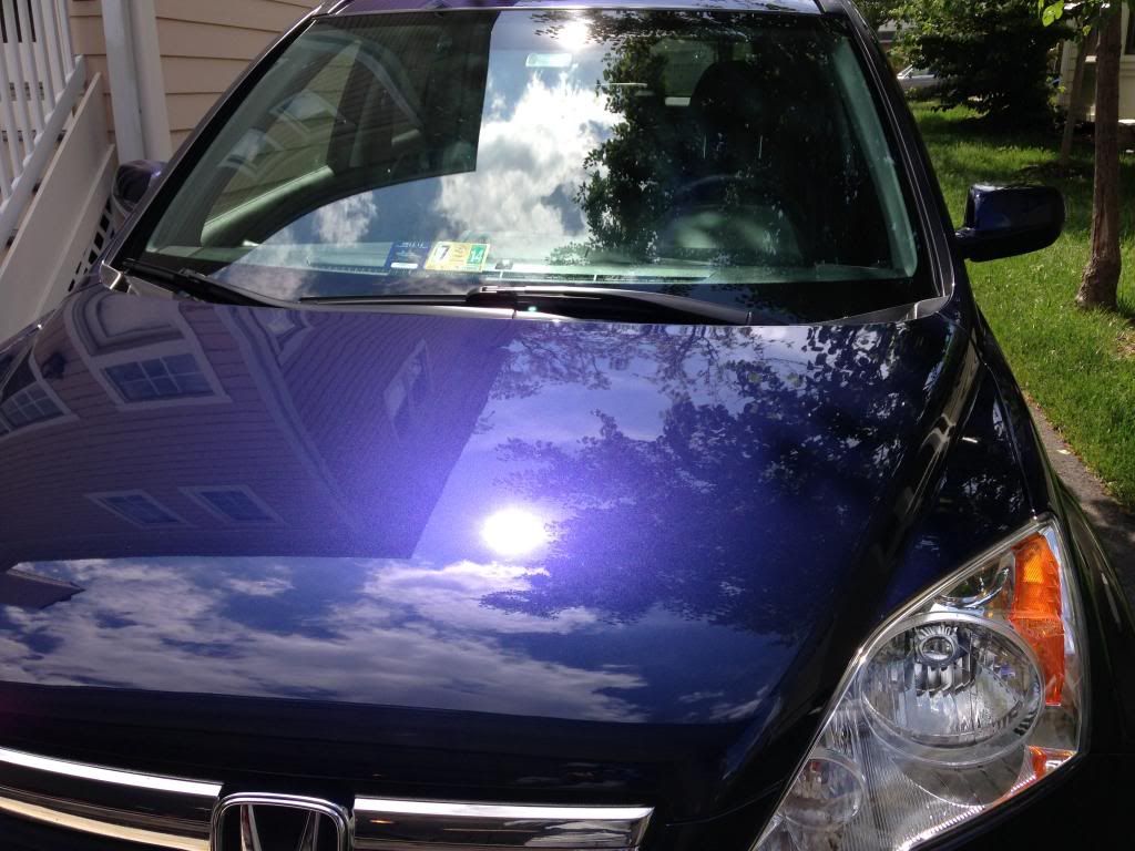

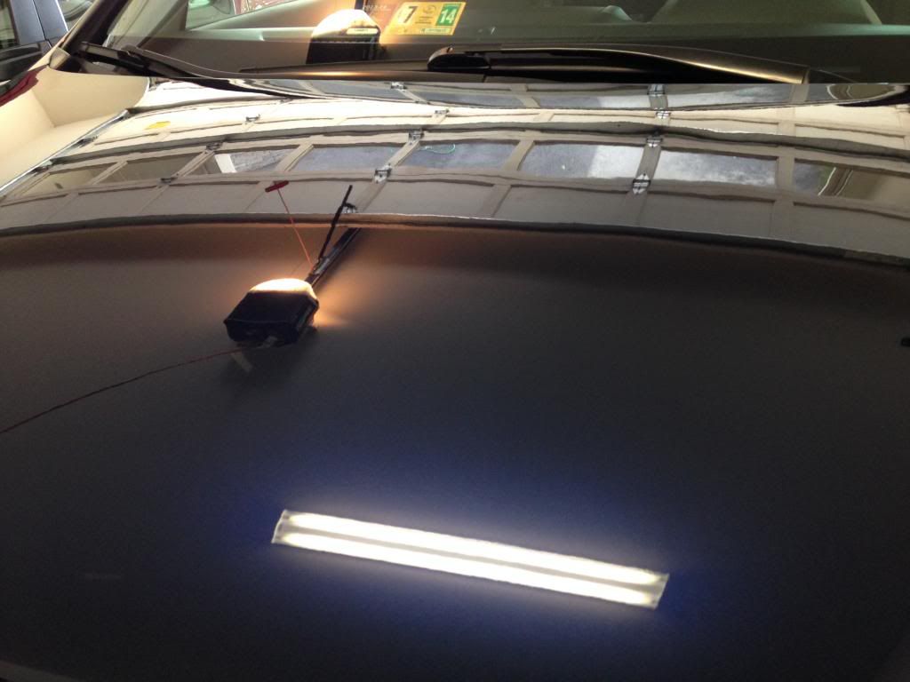

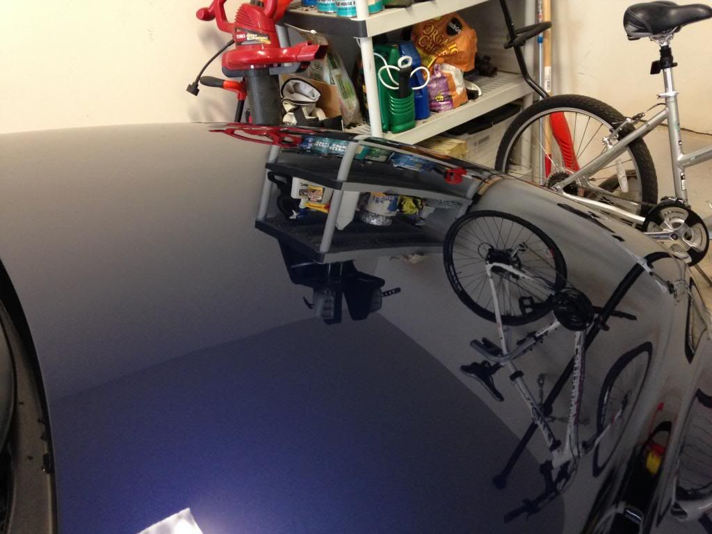

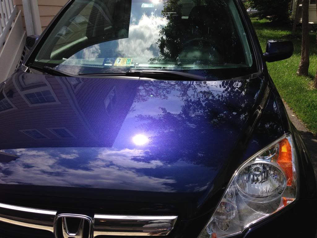

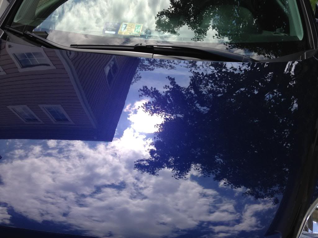

So after washing my daily driver this weekend I noticed that some sap had etched the paint on the hood! So I had to break out the griots and the ultimate compound to fix her up. Afterwards, since I had all my stuff out, I went ahead and ran a pass of Car Pro Reflect finishing polish over the hood. Wow, the gloss and reflectivity were brought to a new level. Attached are some pics under direct and indirect light. You can really see the flake pop where the sun hits it directly.

I actually primed the pad, so maybe that was a no-no, however it wasnt soaked with product by any means. After each section the pad felt like it was dry, so maybe I didnt use enough to mess it up. I used 3 dime sized drops, and my sections were rather large to be honest, the hood above was 4 sections. I just kept going until it sort of soaked into the paint and then easily wiped off the small amount of left over residue. I had the Griots on 4k and used moderate pressure ( not correcting pressure by any means ). The Honda has very soft paint so it isnt very difficult at all to correct or to polish.
Just wanted to add that there was some sort of extra pop to the paint I have not noticed before after using this product, almost like it brought out a lighter shade of blue around areas of direct light, for instance where the sun hits or a strong overhead light. The paint is a very dark blue, perhaps its the flake being more noticeable.
Also, I dont know why the sun isnt doing one of those sparkly things where it hits like I see in other peoples photos - using an iPhone camera BTW.
Sun "stars" come from using a small aperture (f/11-f/22)... not something you can control on an iPhone... not even sure if it would work well with such a tiny lens anyway.
I can assure you that the extra pop that you are seeing will probably go away once you IPA wipe the surface.
I've used this product before and was impressed by it, but a lot of the pop does go away with a wipedown.
