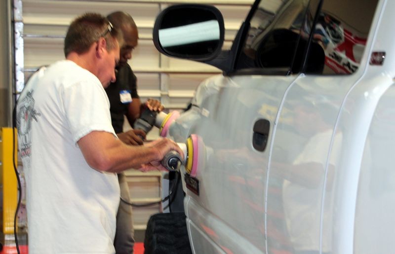

Also - the application of an LSP will create a more uniform appearance that I don't think polishing can achieve as there are a few variables in the polishing step that cannot always be trusted to create a 100% perfect appearance over 100% of the car. This is where the LSP will pick up the slack. Those factors would include things like
Who is doing the polishing and their skill level - pretty easy to figure out there are some people that are true artists with a polisher in their hands and a larger majority that are simply "good".
The paint itself =Paint is always the unknown variable - this means in any given detail job, the end results may not be dependent upon the person, the product or the tool, the car could simply have crap for paint. I dealt with this at my lass class.
Then other things like abrasive technology, pad choice and tool choice - but a true artist will already have his system dialed-in, kind of like any true professional car painter.
Number of pads used - can't create perfection when pad structure changes and or becomes contaminated. Too many people using too few pads from what I've seen over the decades.
