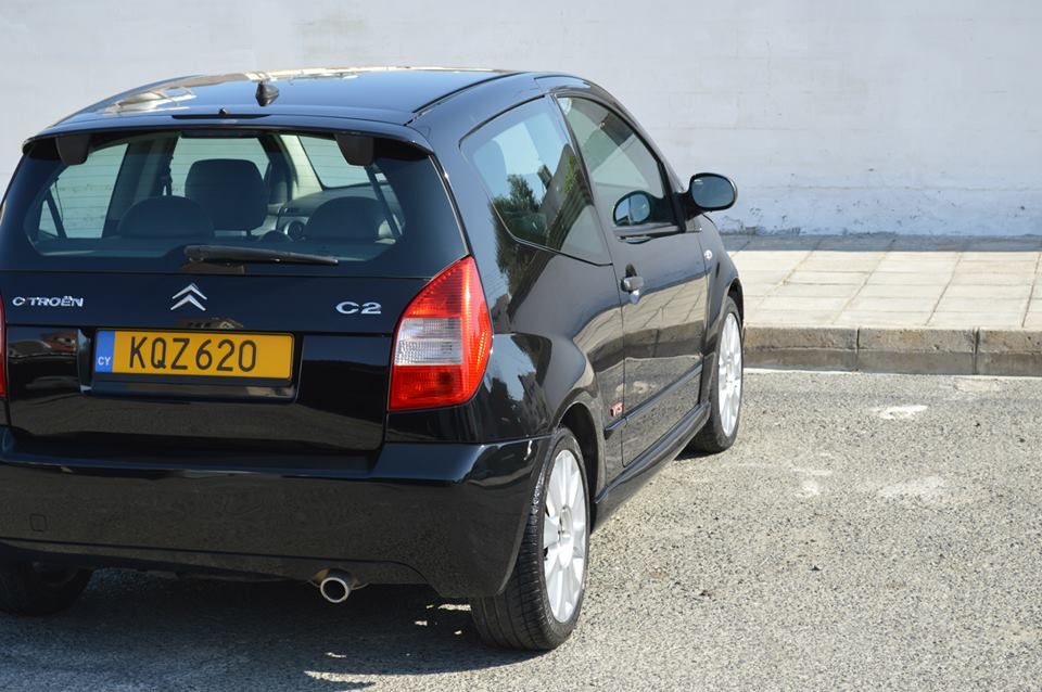

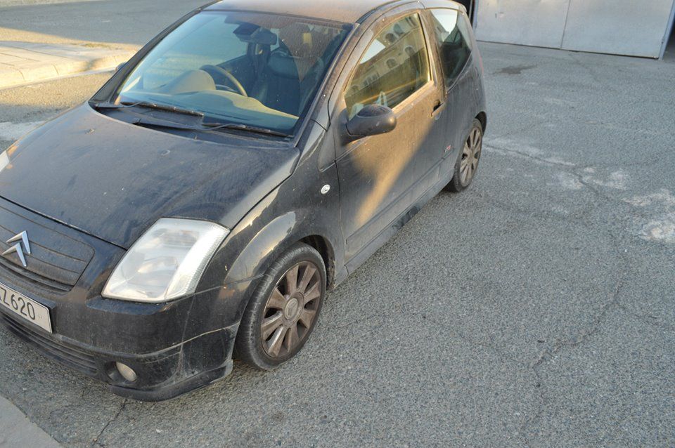

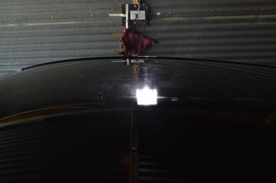

So the car on arrival

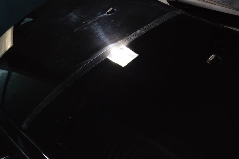

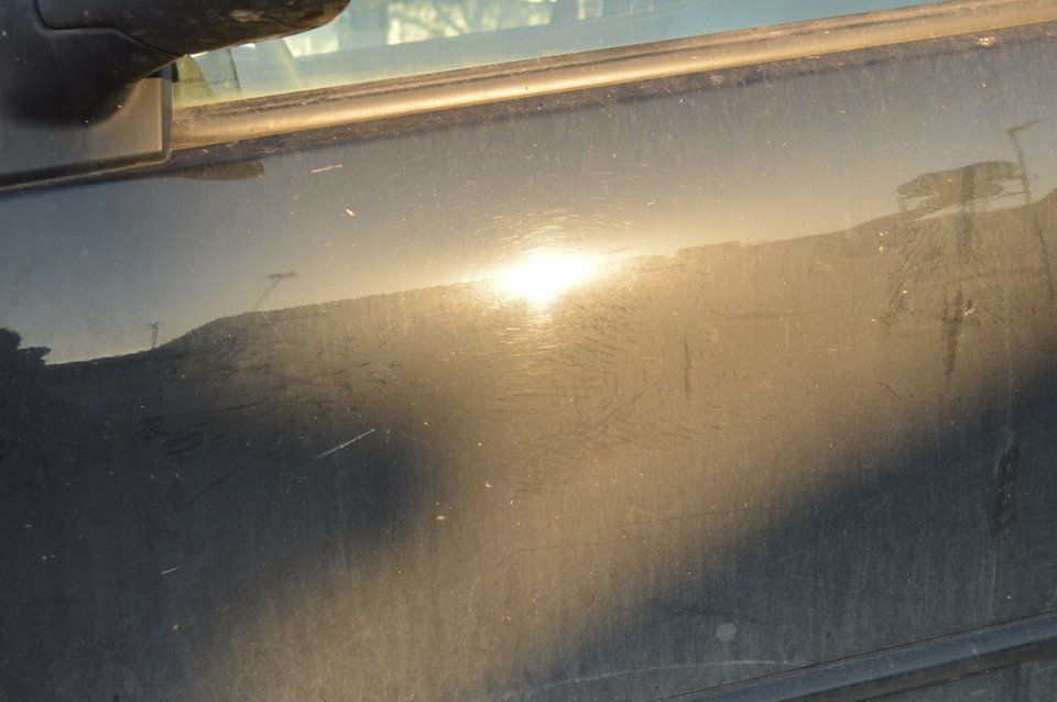

You can see also the swirls hiding under the dirty panels at early sun . 6:30 at the morning

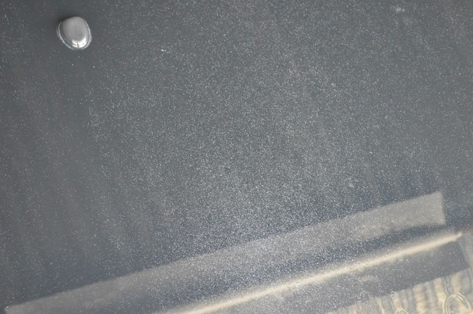

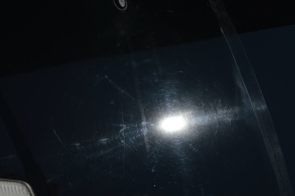

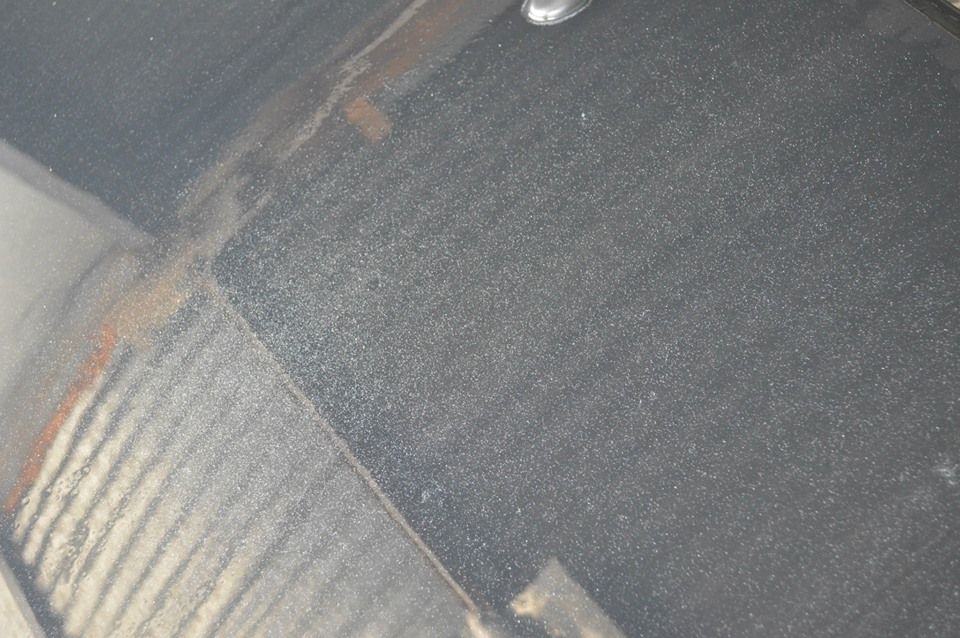

i thought that will this will be as easy case because of the size of the car .. After washing the car and spray all the car with iron x i inspect the vehicle
If you look carefully you can see the dry sand ,industrial polution ..My friend now work in a sand mine so the car was parked outside .. I try to get rid of the sand with Artdeshine clay cloth .. Was brilliant (sorry no pics )

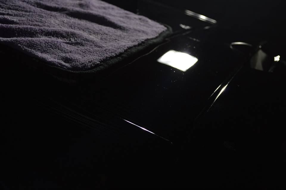

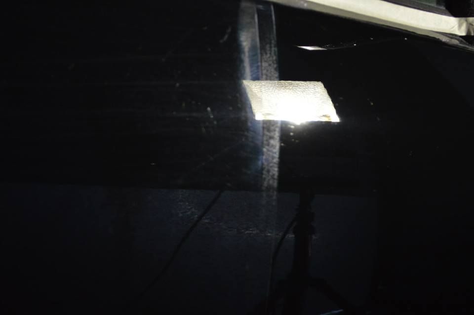

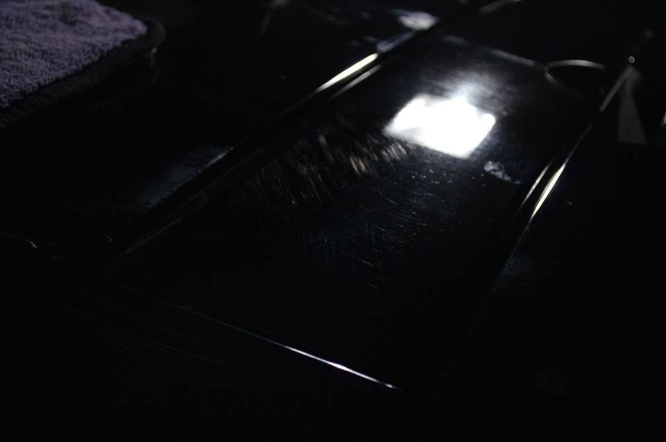

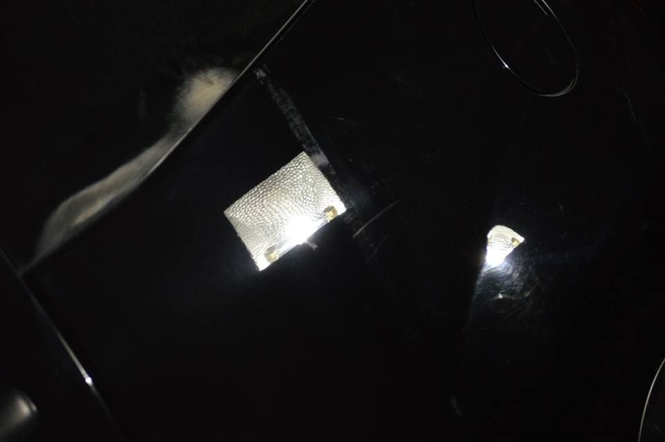

So i get the chance to try my new toy .Rupes 21 . The car was full of oxidation so i put a microfibre pad and m101 ( paint readings was from 130-160)
A few 50-50
before
After

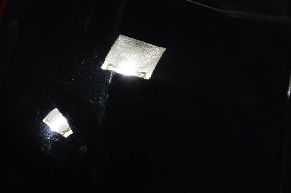

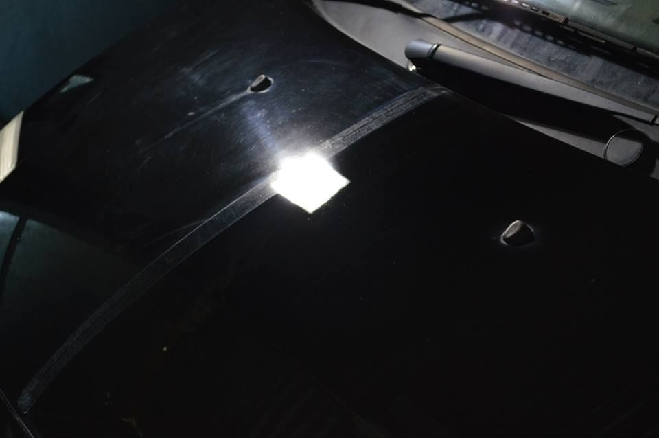

Checking my work in the sun 50-50

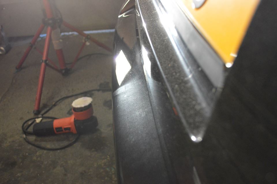

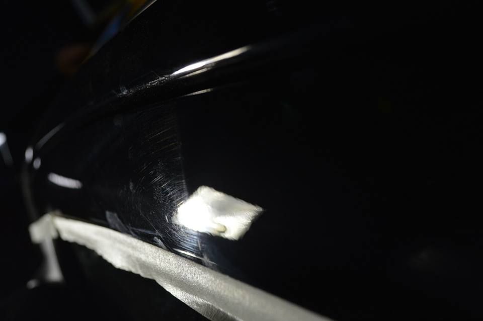

Bumber also need some love .I use my kestrel pro 6 with mf pad

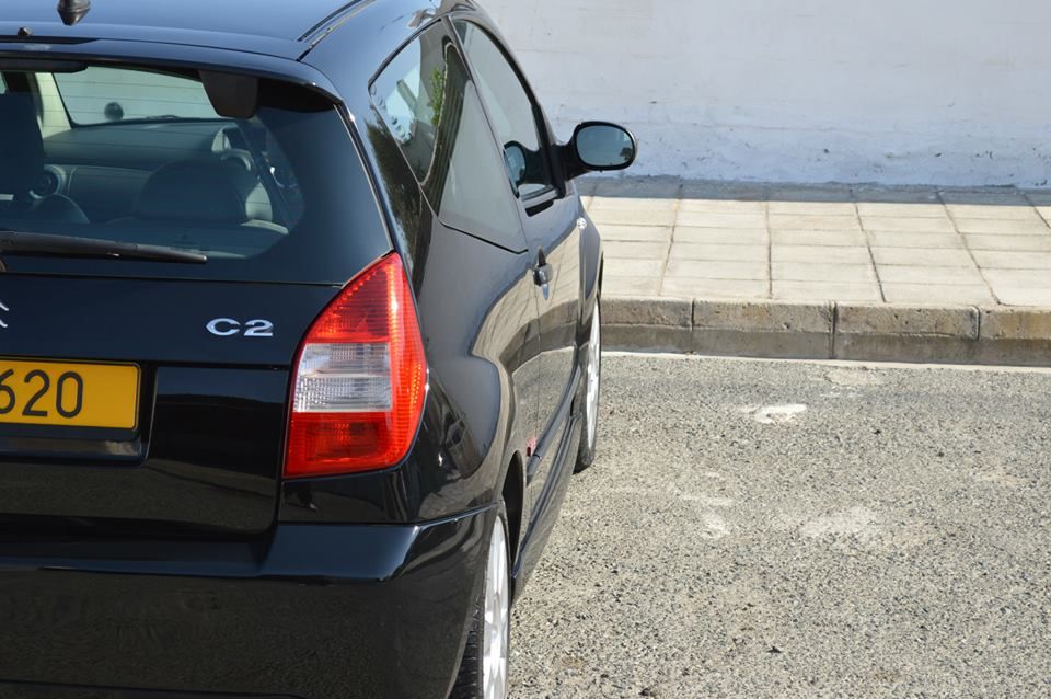

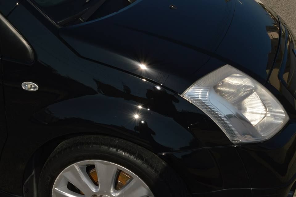

And some finished shots after 2 days of work ..

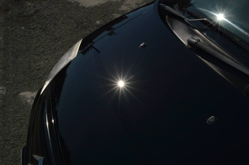

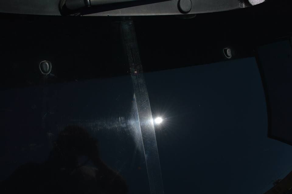

Some before in the sun
And after
The refined stage was farecla black foam with 205 ..Protected with hd wax and 3 coats of Artdeshine Nano gloss paint (30 minites between each layer)

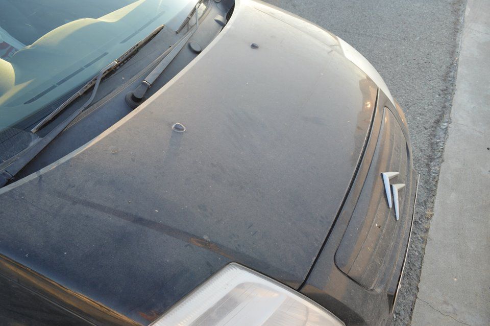

A few 50-50
before
After

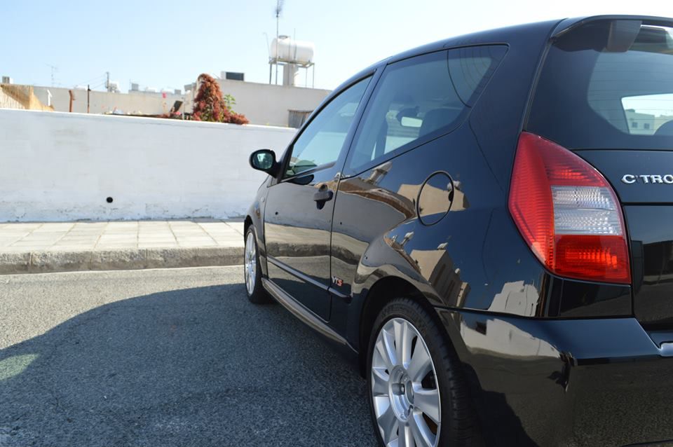

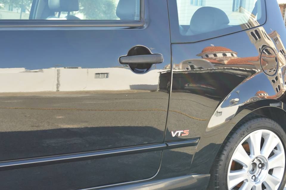

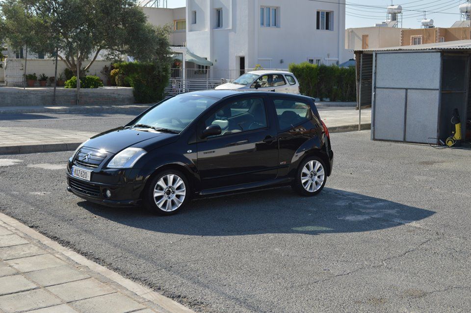

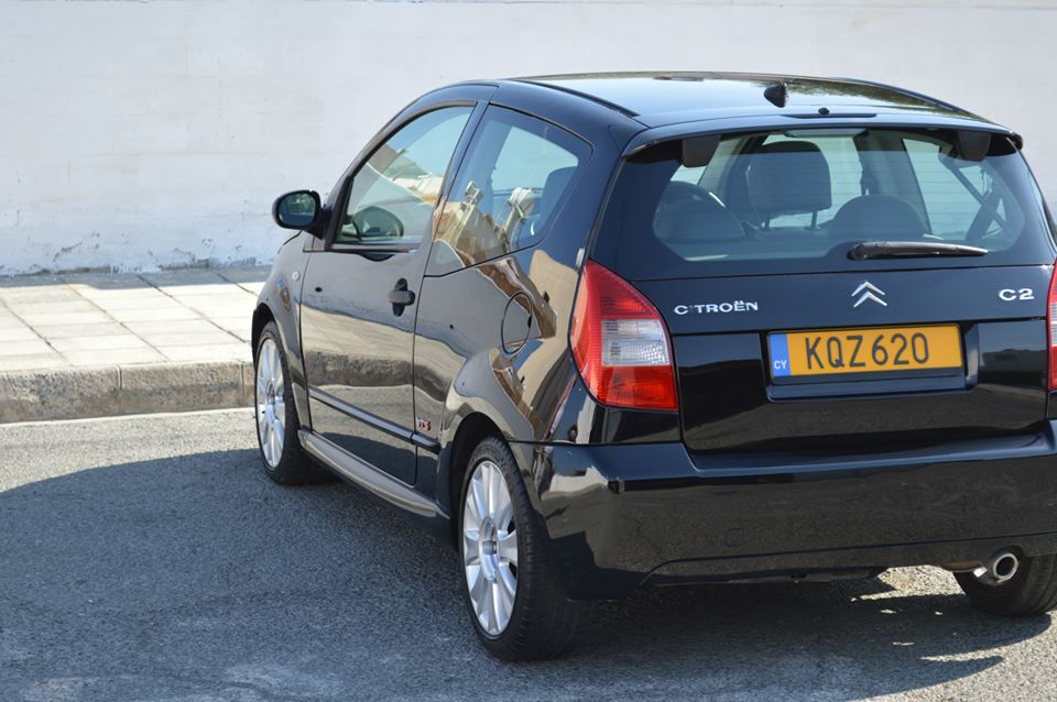

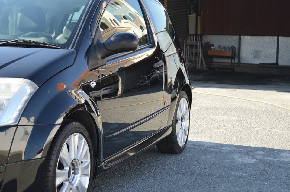

And after
