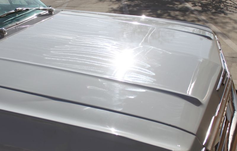

Here you can see the circular cloud on the left, almost looks like product on the surface.
Here's your picture, I took 15 seconds to download it and then upload it to your gallery here on AGO so it he picture could be "inserted" instead of "attached" as it makes it easier for everyone to see and discuss.
It's kind of hard to see but I think what I'm seeing is called micro-marring
watermark.php
If I'm seeing it correctly, I drew a line around it....
watermark.php
