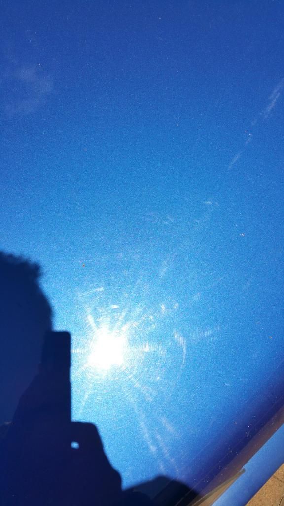

Just wanted to see if i could get the paint damage better.

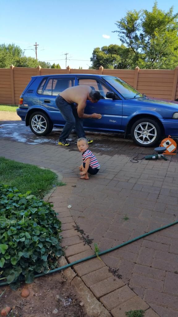

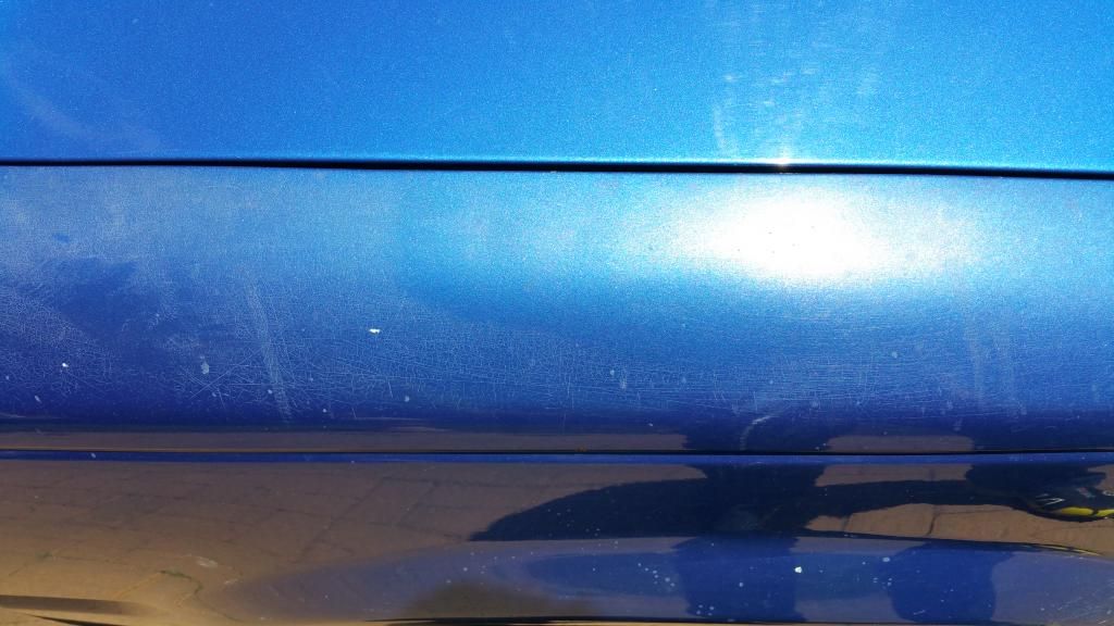

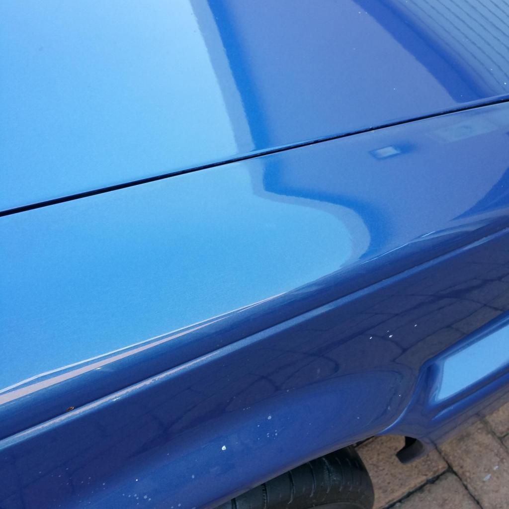

The car was standing next to the road a while back after overheating and some idiot stopping to help made the water spew all over the RH side fender and thus destroying the paint work. Hard to capture on phone camera but hopefully you can see the damage to the paintwork. My dad tried to polish it by hand but did not help at all and the polish residue got stuck inside the cracks.
Measured the paint on the affected fender and it measured a healthy 195Microns while the others were on average 95microns so i was glad which meant i could wet sand it and then compound it with my mezerna wool mit and Mezerna FG400 aand the follow it up with Mezerna 2500 and Red Chemical Guys Pad and My cyclo single head DA polisher to end up with this. Not perfect but better.

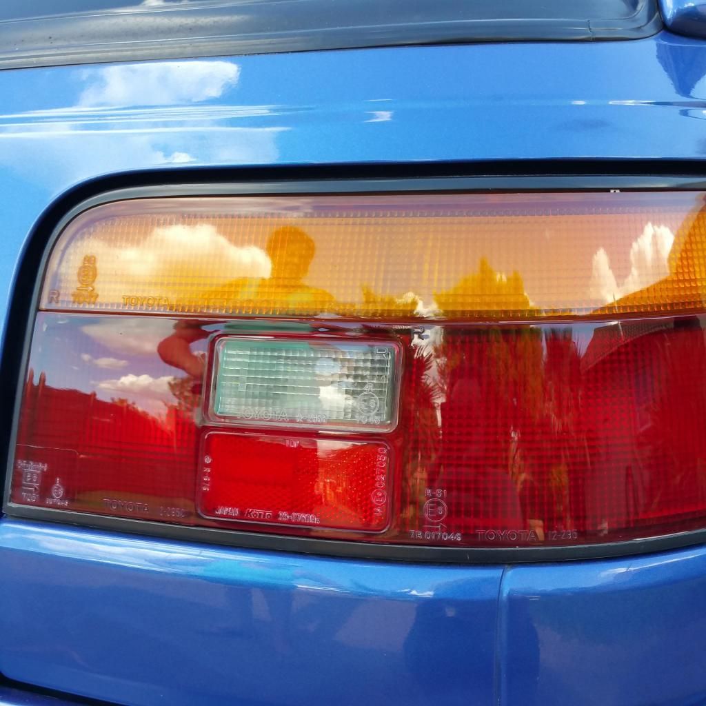

The rest of the car was then washed and decontaminated and the rear tail lights was also compounded with the Cyclo DA and the Orange Pad with some Mezerna 2500.

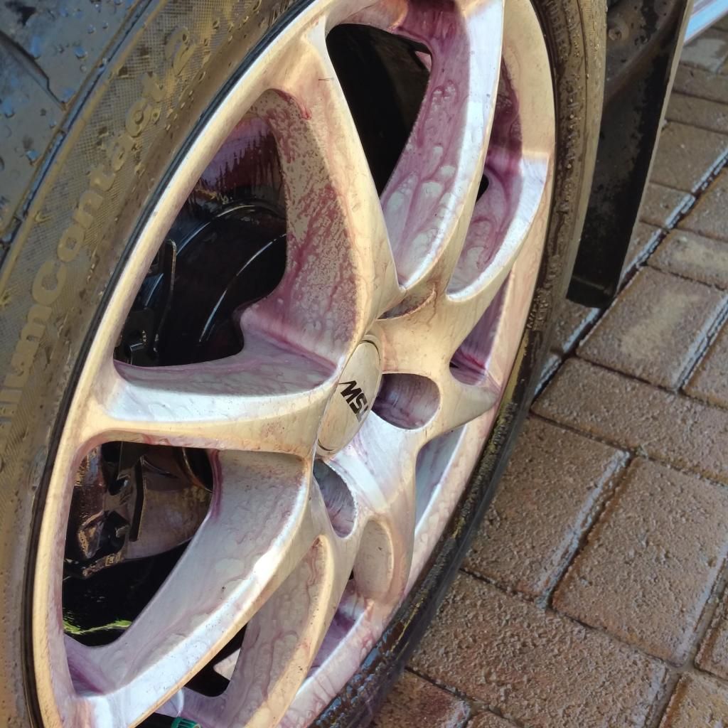

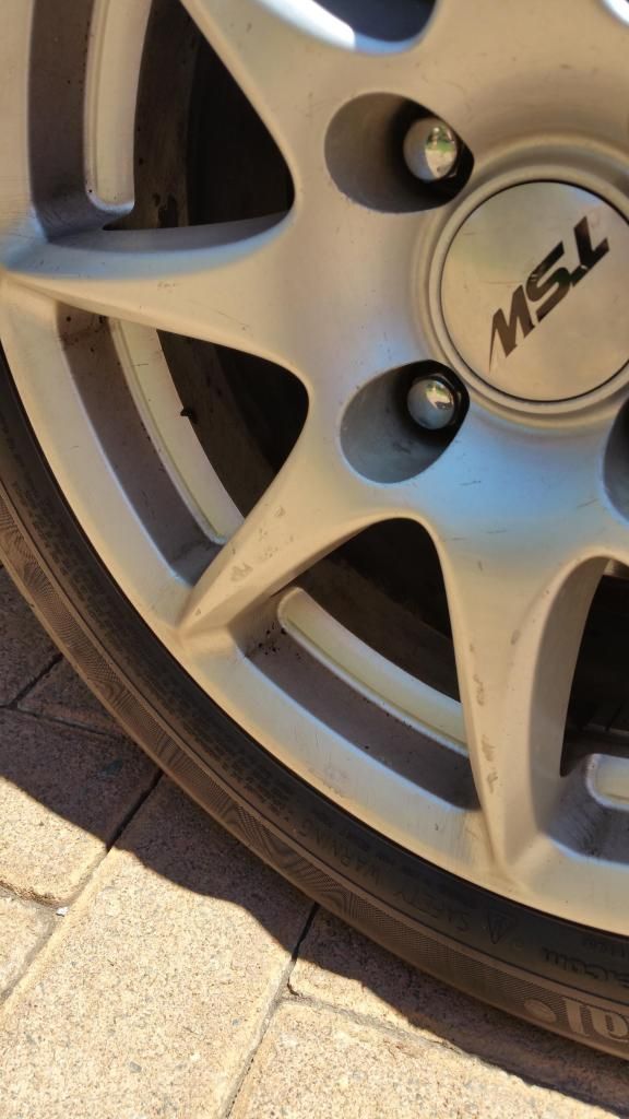

Nice to see a wheel go from this :

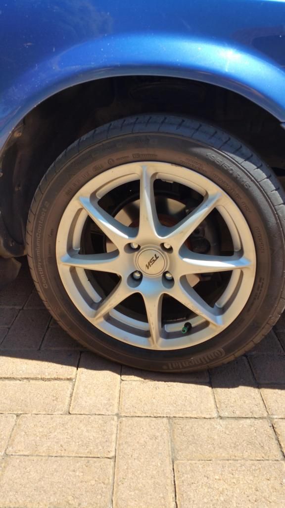

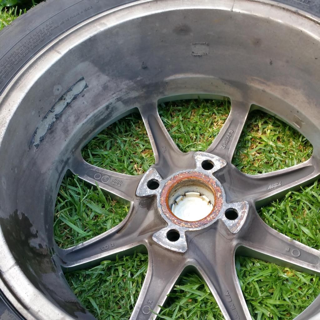

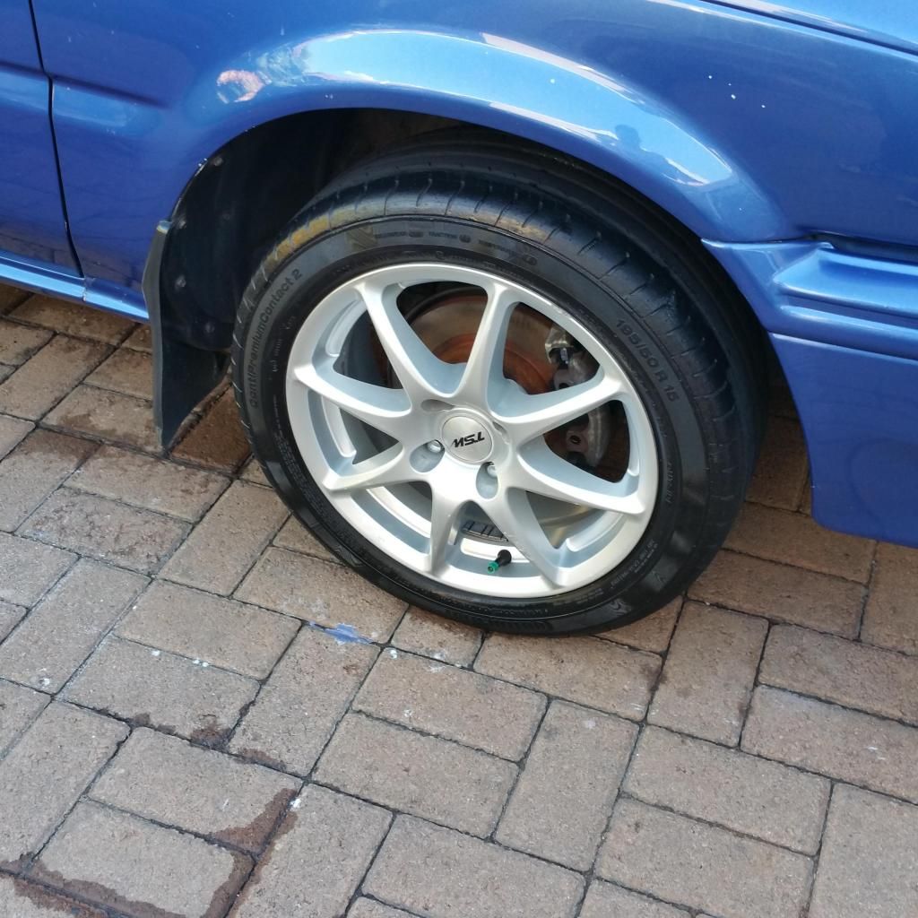

To This :
Pic of the tail lights before :

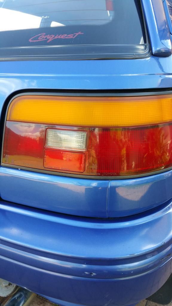

And After

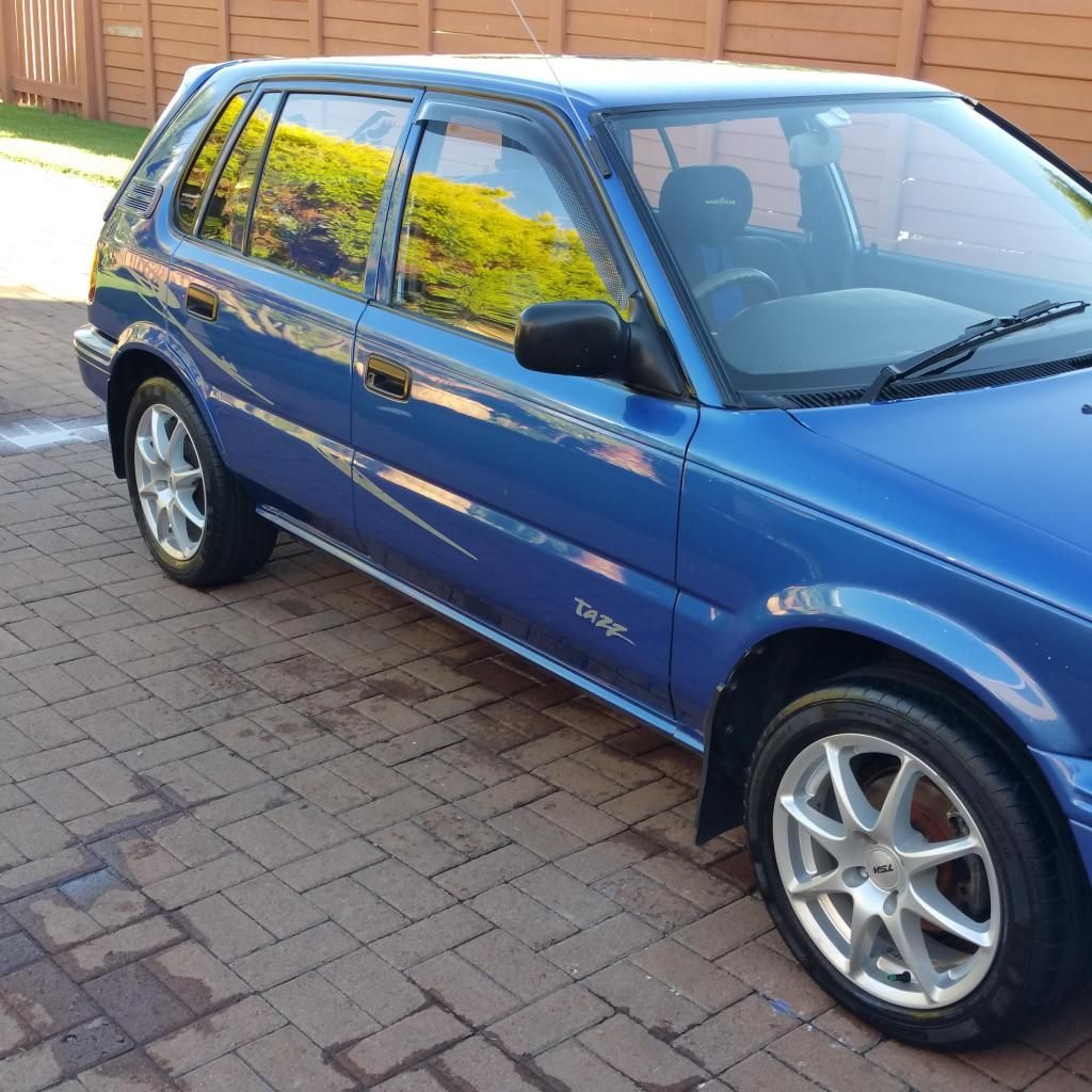

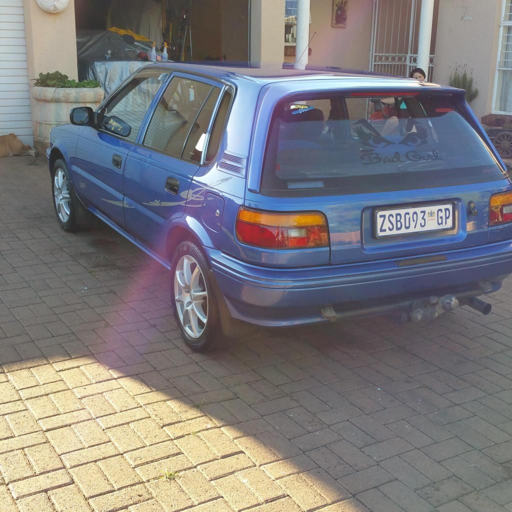

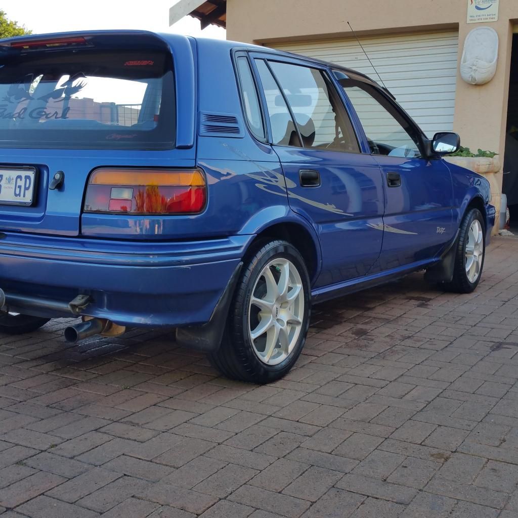

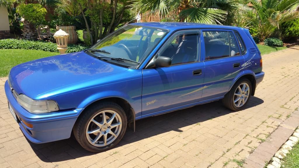

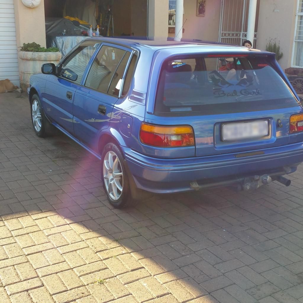

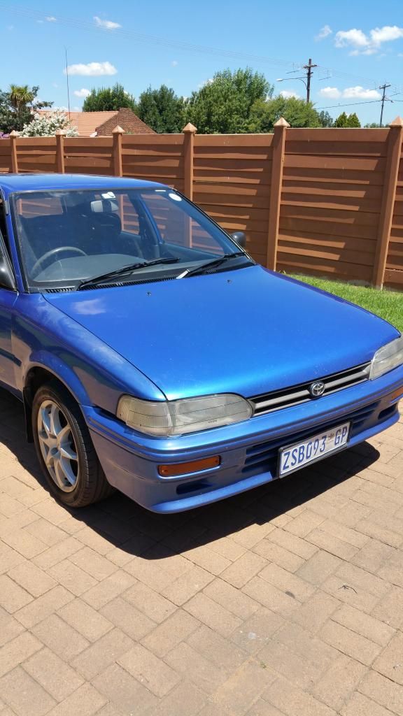

and some afters of the car
To This :
