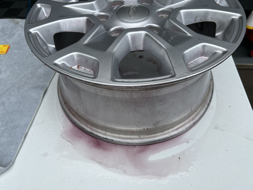

Woke up to pouring rain and thunder again today, so I aborted the plan to wash the Ranger and instead started on the new wheels.
I started with an iron remover, this time Opti-Coat Ferex. Probably one of the better iron removers I have used, even if it has no attempt at disguising the stink.

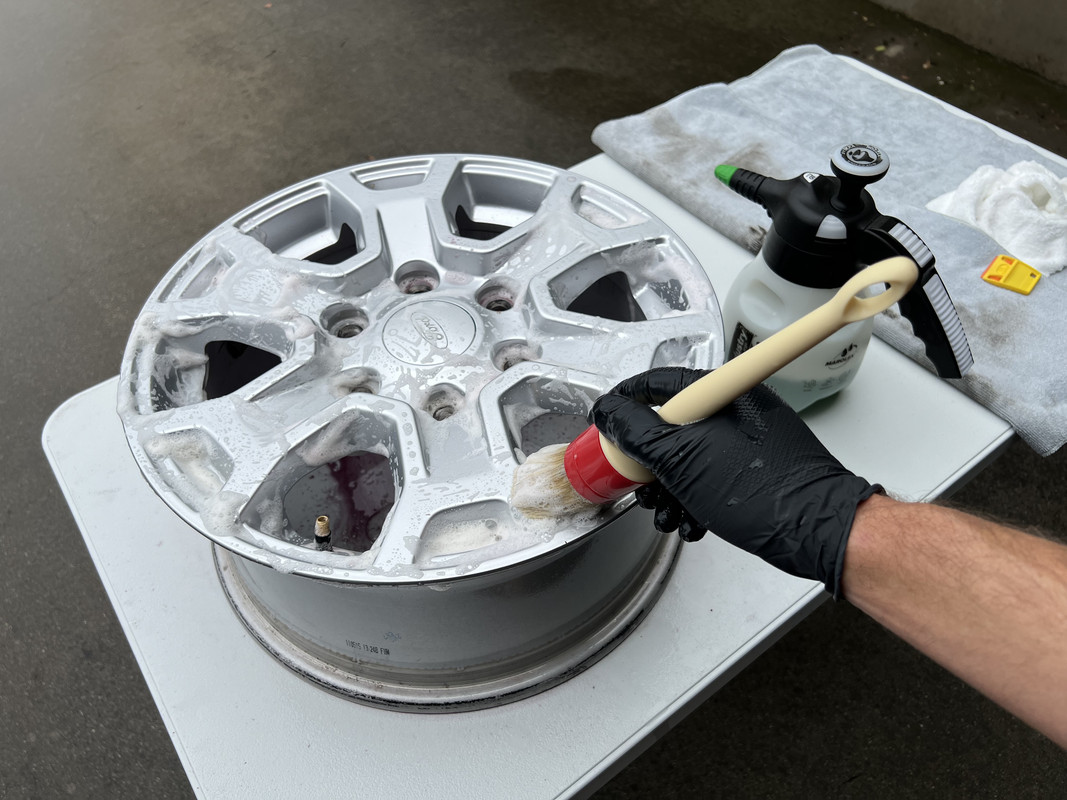

Once left to dwell, I hit the wheels with Shine Supply Wise Guy, which is traditionally used as a tyre cleaner but is now able to be used on wheels. In this case, I selected Wise Guy for it's alkalinity and teamed it with a boars hair brush for extra cut.
It's then I had to get aggressive in removing tar deposits, old wheel weight adhesive and baked on grime. I used a combination of a plastic razor, Carpro TarX, KCx Eulex AND Eulex M to remove the tar, rubber residue and adhesive. I then clayed the barrels using Bilt Hamber Medium Clay, which is very aggressive stuff that I would normally avoid, the wheel faces I did with a standard mild clay. I then went over the barrels with a magic eraser and more Wise Guy to remove what else I could. Be mindful that using a magic eraser is extremely abrasive, so always use as a last resort. In my case, because I'm polishing, it accepted the risk.

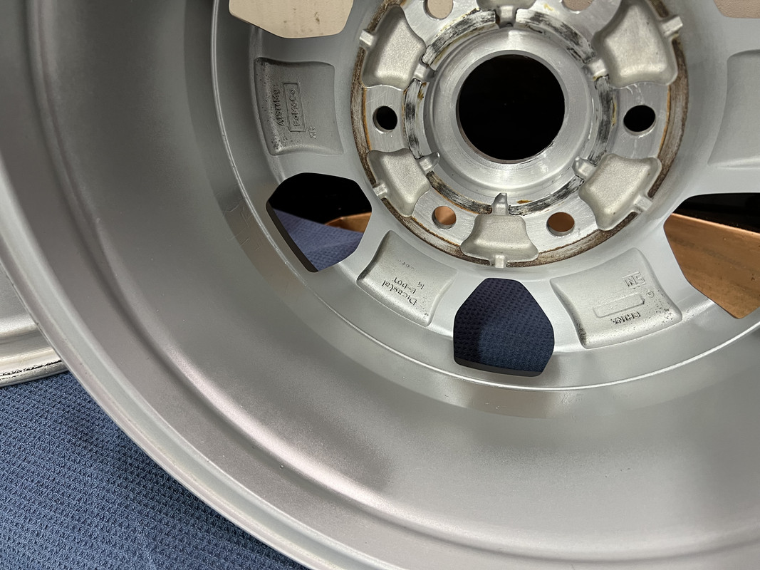

The wheel faces came up fine, a nick or two but acceptable. Once polished, they will look quite nice. The barrels I'm not happy with. There are scratches down to the alloy where someone previously scraped off the wheel weights, only just visible through the spokes but I know they are there. I actually lightly scuffed, prep sprayed and then applied a light dusting of silver touchup paint to fill and disguise these areas. Once the barrels are polished, they should be acceptable.
Because of the barrels, I almost chucked it in and gave up on these wheels. My other option is to buy brand new versions from Jefferson Ford, who have these same wheels listed at $990 each, which would be $3960 + delivery.

Having slept on it, and inspected my handiwork, I think I'm happy with them now.
The light dusting of paint I applied yesterday on the areas that were scratched has come up better than expected. The colour match is not identical, but it's virtually undetectable when viewed from front on, which what I was going for. At least now the scratches don't stand out.
Not sure if polishing the barrels will make the colour difference more detectable as the OE finish is quite marred, and the new paint has some gloss to it. As I said, the when looked head on, the paint I added yesterday does not stand out.

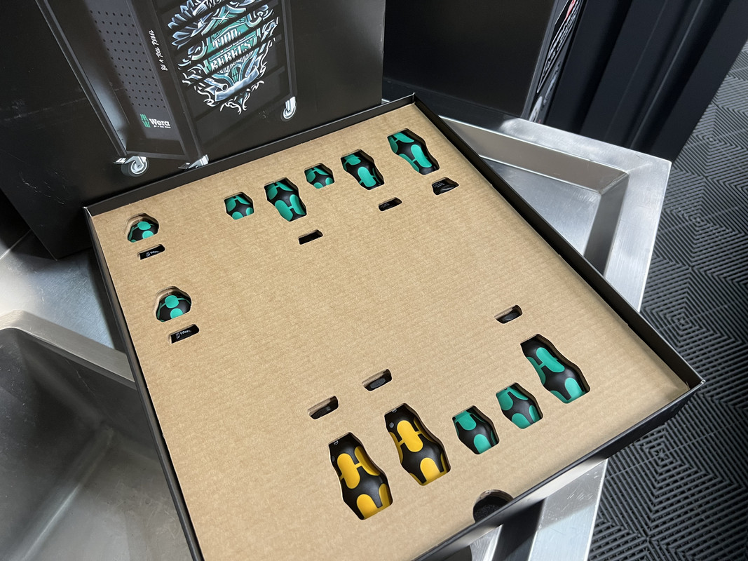

This is the foam insert set of Wera's screwdrivers. Did I need them, not at all. Did I want them, most certainly. These screwdrivers have a knurled tip for added purchase on the fastener, and the yellow handle versions are impact resistant so you can hammer on them like a chisel.
Now I have to figure out what to do with these?
I actually like the Stanley's more, so I'll probably keep them and sell off the Kincrome items...........or give them to my Dad.
