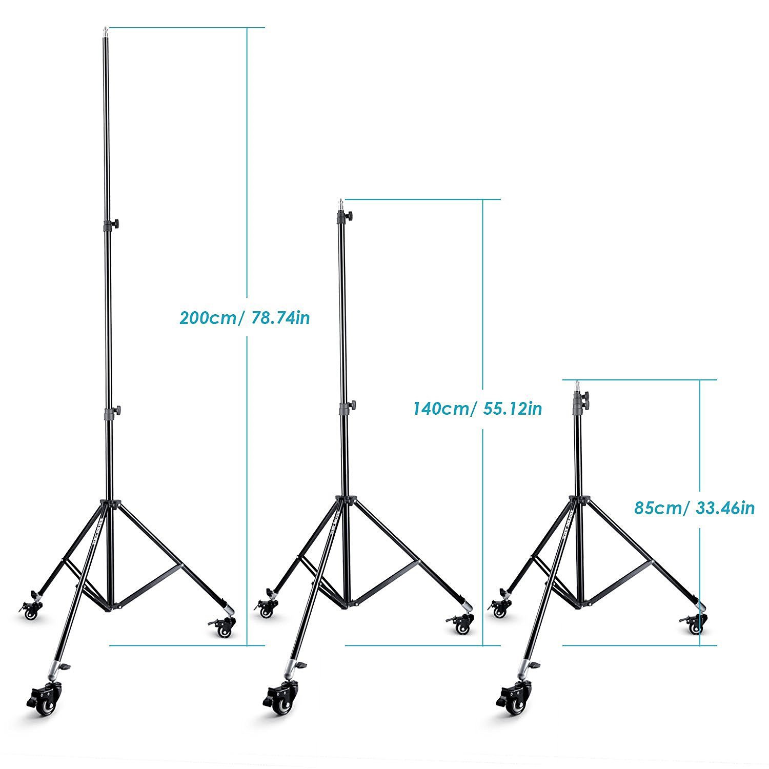

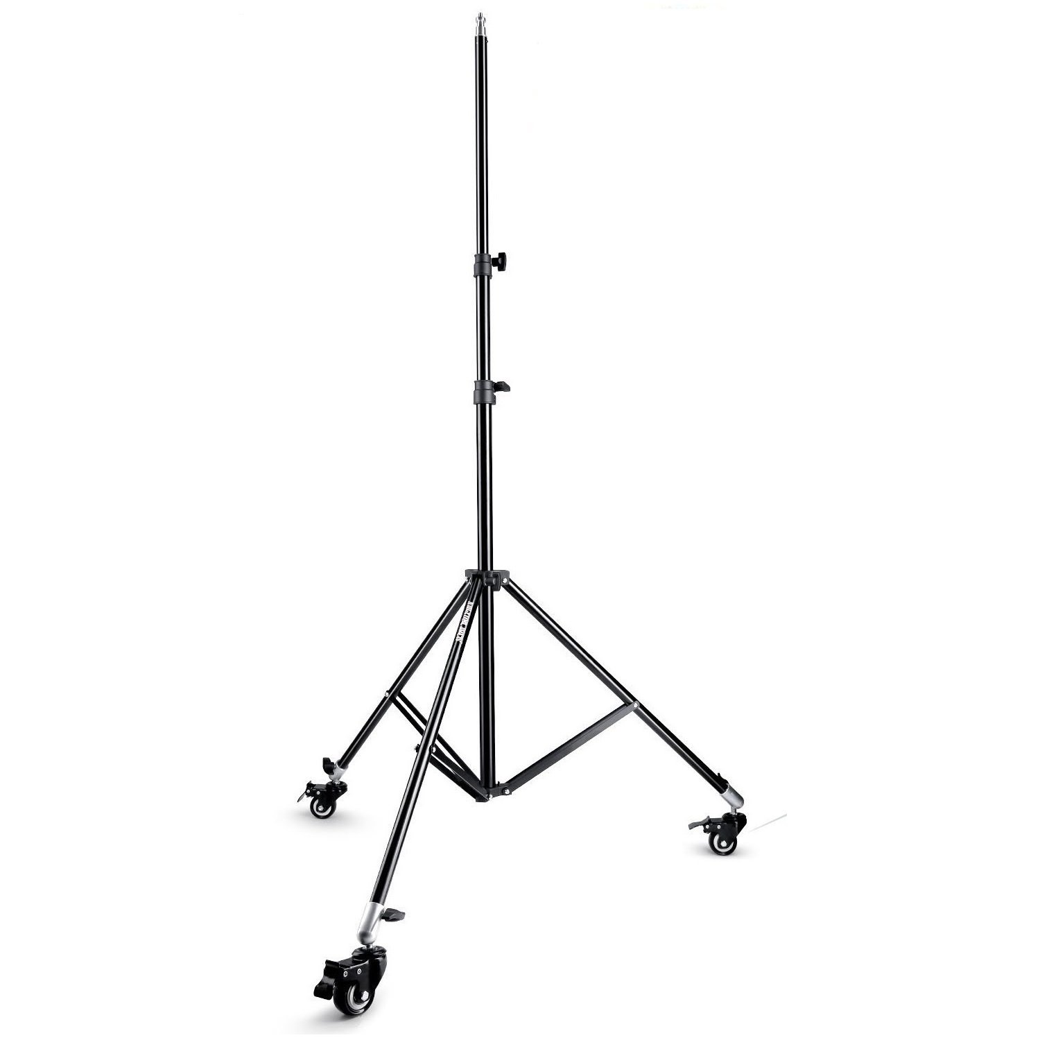

i saw this stand which extends from 3' 8"- 8' 5" and has built in locking casters and sells for $29.99. i would imagine it would help stabilize the stand...
i think it will. wheels add a little weight. you can always add an ankle weight strap to the opposite leg
Big thanks to everyone who added to this one over time... I put my light together and used it for the first time this past weekend, and it was excellent! I had a mic boom stand already, so just bought a dolly to add wheels/weight and the other necessary equipment (bulbs, adapters, etc). IMO, it would be hard to beat the flexibility of this setup.
