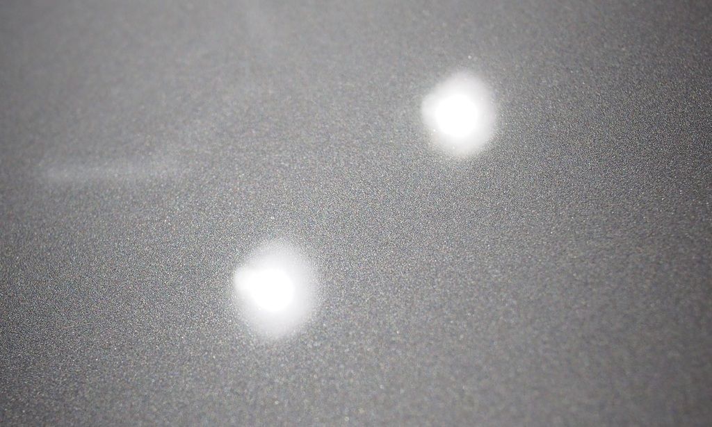

Here is a pic. To the right of the sun you can see there are little tiny 1/8" 'tick marks' around. These are consistent over the hood, fenders and top of the doors. I'm assuming whoever did it at the dealer didn't worry about the sides.
I am willing to use whatever product necessary, obviously. Being in Canada it's a little harder to find some of them. The Wolfgang stuff is not too bad to find. The ones I listed earlier are easier to find but that is not a deal breaker.

That looks like micro marring to me. Griots correcting cream should work well and finish excellent on hard paint.
I do find it strange that complete compound with an orange pad is leaving micro marring on hard paint.
I agree and I’m not sure why. On my wife’s Wrangler it worked great.

So I did a couple test spots today, the Sonax seems to be working. It’s a little hard to tell because there was no sunlight today and my LED light is only average but there is a definite improvement at the tape line. I tried a white pad with decent results and an orange pad with better results. Two passes of medium speed heavy pressure low arm speed, then four to five passes at high speed and gradually lower pressure and higher arm speed. Seems to work. I’ll do the whole car in about another month then seal it up for winter.
