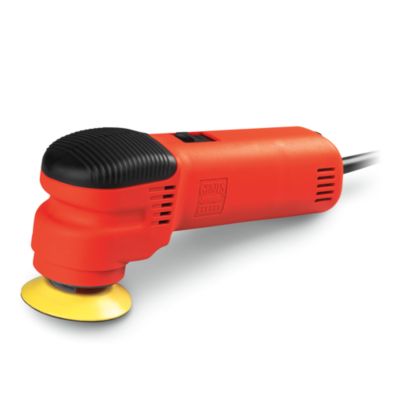

The Griot's 3" Mini Polisher doesn't have the power to do any major correction work like most think of doing on their car. I'm going to guess it has to do with mass and inertia of the rotating components in the drive mechanism that makes it too easy for the leverage the pads have to stop the pad from rotating when too much pressure is applied.
That said, they
can do correction work and allow me to prove it with post I made back in November of 2009
Note the below was done with a medium cut polish, I could have done the work faster and easier with anytime more aggressive but wanted to prove what could be done by not using a true compound. Also, these were "hand" sanding marks, machine sanding marks are always easier to remove when using the same grit level.
