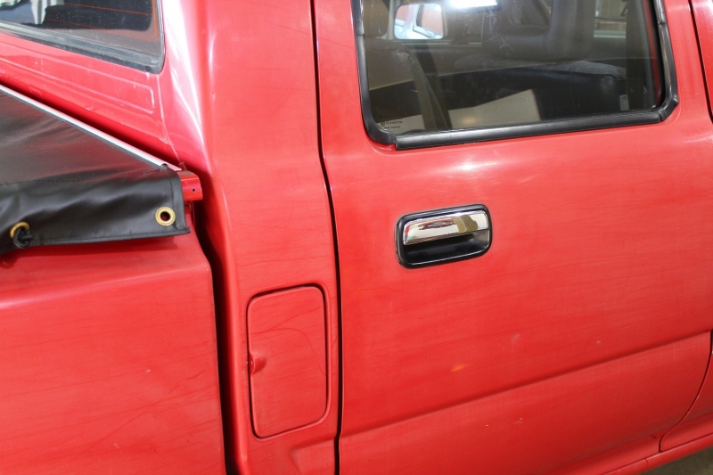

While this Toyota Hilux isn't all that old, & not exactly "antique" it does have single stage paint that required some love & attention. All but the two front guards (fenders) were original paint but at least these were painted in single stage too, & for a twenty year old "bush basher" it was fairly straight & true. After a thorough wash/decontamination routine a test spot revealed my process. Meguiars M205 on Lake Country Orange Hybrids on Flex 3401s, followed with a loving hand massage with Meguiars #7 & LSP - CarPro Reload. Now I know this strays a bit from the heavy soaking of #7 first method, & Mike can probably explain why I went this way better than me but the oxidation wasn't as bad as it looked, time was a factor & I have had better success doing it this way on more modern single stage paints.
Right - pictures!
As the Toyota Hilux arrived -
Poor thing! Right lets give it some shine. Sorry, no pictures of the work in progress as this was a limited time project . . . under eight hours from start to finish but here are the pictures of the results -
