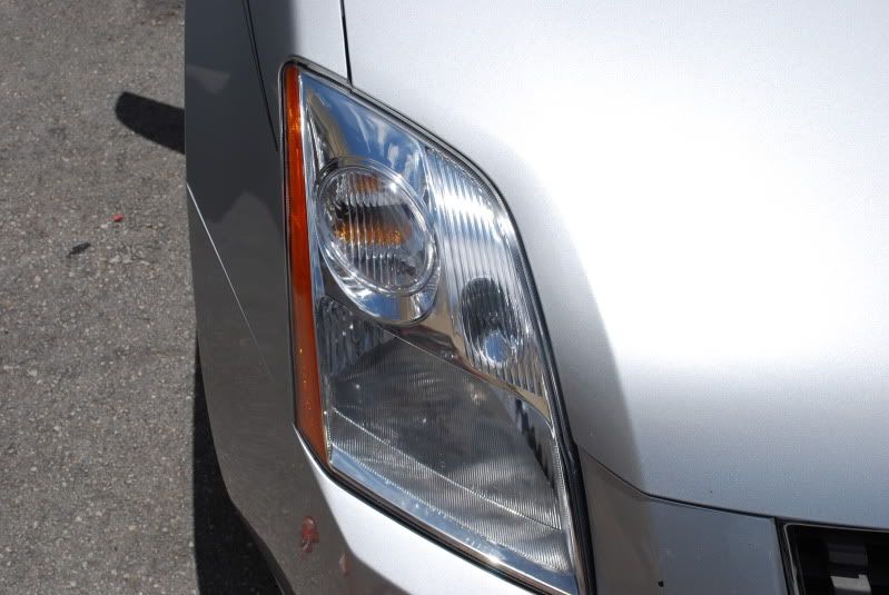

Before:
After
Nissan Sentra
Before:
After
Helmsman Urathane with mineral spirits mixed 1:1 (50/50)
Sent from my PC36100 using Tapatalk

Looks great man! I followed your same process (almost to a T) and didn't get quite the same results on my Mustang lights.
I used:
320 wet
600 wet
800 wet
1000 wet
1500 wet
m105/ Yellow CCS
m205/ Orange CCS
I'm thinking I may need that 2500 and another step of polishing.
any pics? i know M105 is great for removing sanding marks, but IDK about 1500 grit marks on plastic. i would say your right, use 2500 but you shouldnt need another polishing step tho
Polished out a set for my friend last night, they were not in too bad of shape, but I did polish out 1500 grit sanding marks with no problem.
