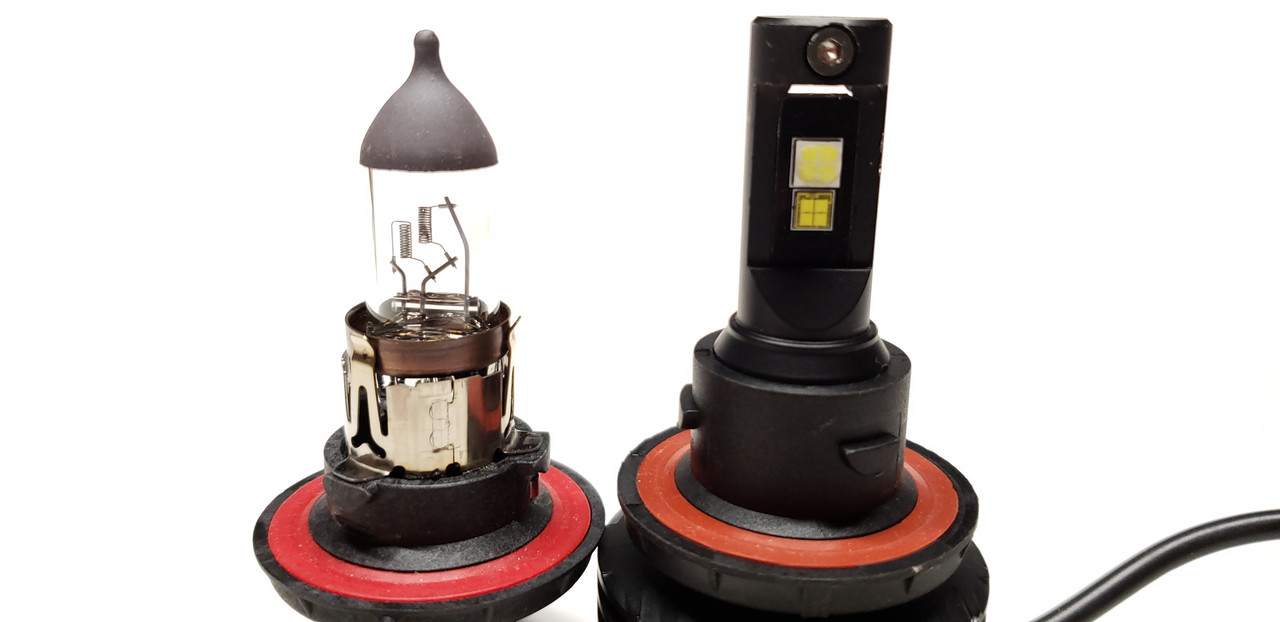

Don, this is because you do not have a H11 bulb for your Camaro. You have a H13 which is a dual-filament and completely different design.
Just because you do not get flashed does not mean that your bulbs are good. It just means that A) No one has cared to flash you and/or B) your headlights are aimed down so that there is little to no glare.

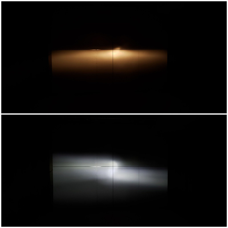

Here is an older version low beam (Cree LED) and high beam (Luxeon MZ LED). The headlamp is a H13 Chevy Cruze (1st gen).
Notice how awkward the beam shape is? Notice how high it is? This would have to be massively aimed downward to keep from glaring other drivers. Which puts the peak intensity right in front of the vehicles foreground with no long distance illumination.
