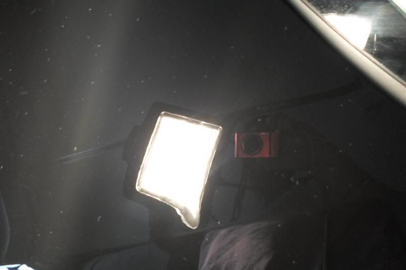

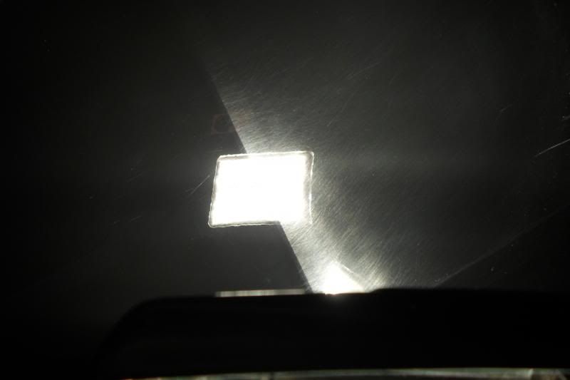

Here's my take... from the last "finished" picture, it looks like light haze or marring from the pads, abrasives and action of the tool.
Here's the first red flag.... it's an Audi. Audi has paint all over the spectrum of hard and soft and more specifically, polishable and un-polishable.
Assuming, and I hate assuming, but assuming you're finishing out using the least aggressive Menzerna polish in your arsenal, which the accurate name is,
SF 4000 – Super Finish Polish (PO106FA)
and you're still getting these kind of results...
Then I'd say the primary problem isn't you or the polish but the paint.
Here's what I would try, I would get my hands on a non-forced dual action polisher and re-try polishing using a soft foam pad like the Lake Country 5.5" black flat pad with the same polish.
Start at highest speed setting, especially if it's the Porter Cable unit and after about 4 section passes, reduce speed just a little and reduce downward pressure.
At least that's what I would "test".
I've never seen a paint system that Menzerna polishes could not finish out perfect on. Sometimes, some paint systems just don't like to be finished out using a forced rotation dual action polisher. I talk about that in this thread, see posts #31 and #32

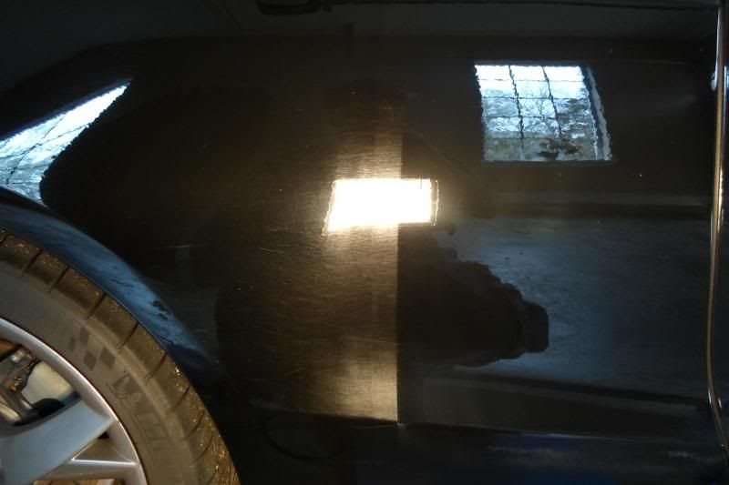

So all I did was change my compound went with the FG400 and it pretty much solved my problems..
50/50 After it was hit with the FG400

Yes the FG400 was more effective then Uber Compound.. I used the same process as before just switched to the FG400..
