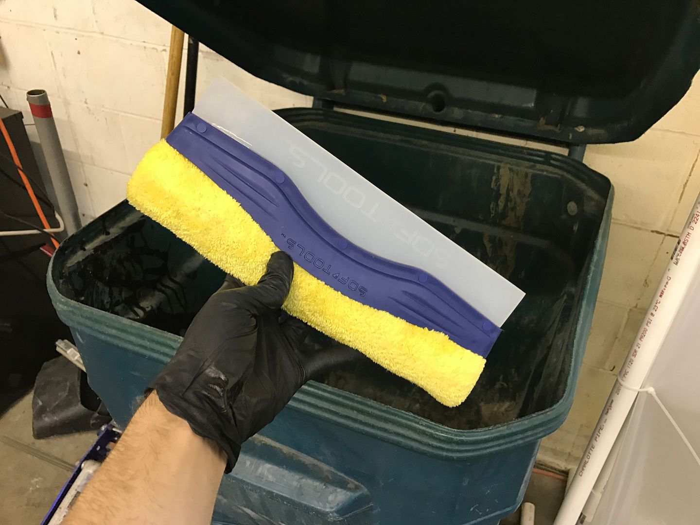

I did find one of these squeegie things inside the car, and sent the owner this photo to show him where it would be most useful...
The owner has been coached on proper care going forward, so I hope it never returns to the condition it was in when it arrived at our shop! We have seen cars that are <5 years old in similar or worse condition, so we weren't be too shocked that this wasn't in mint condition to begin with :)
