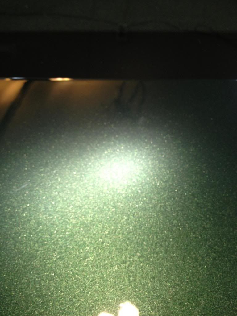

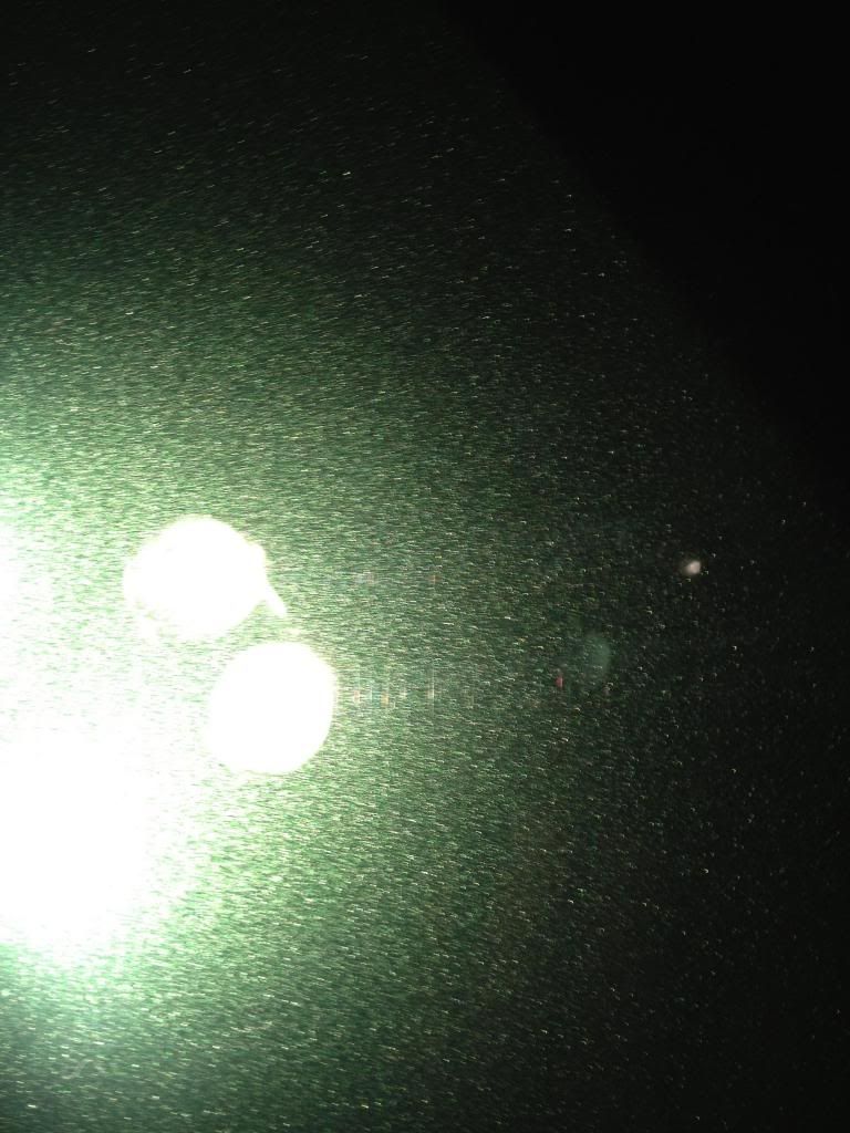

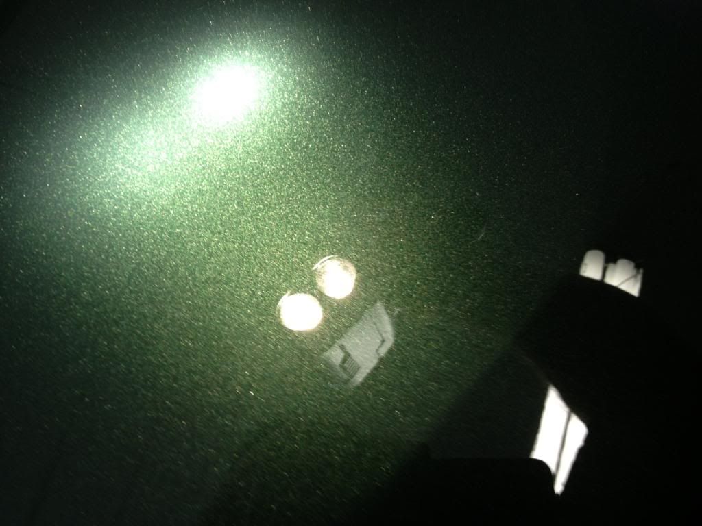

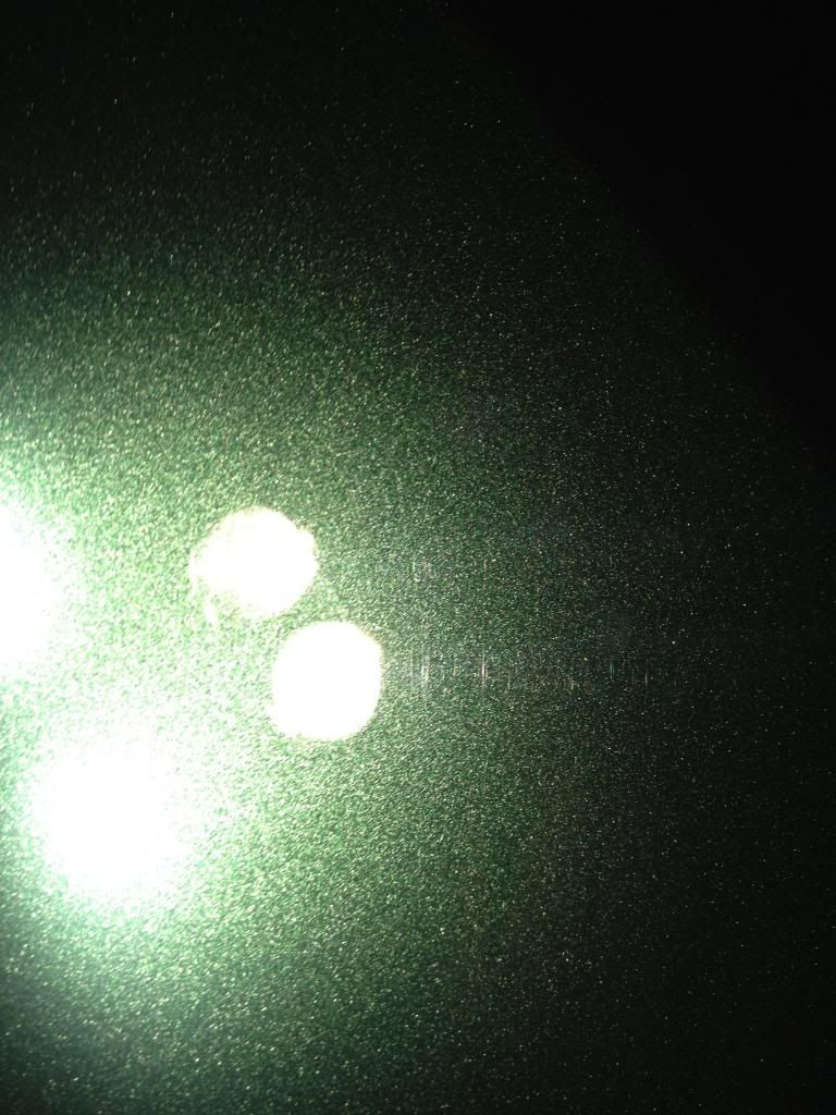

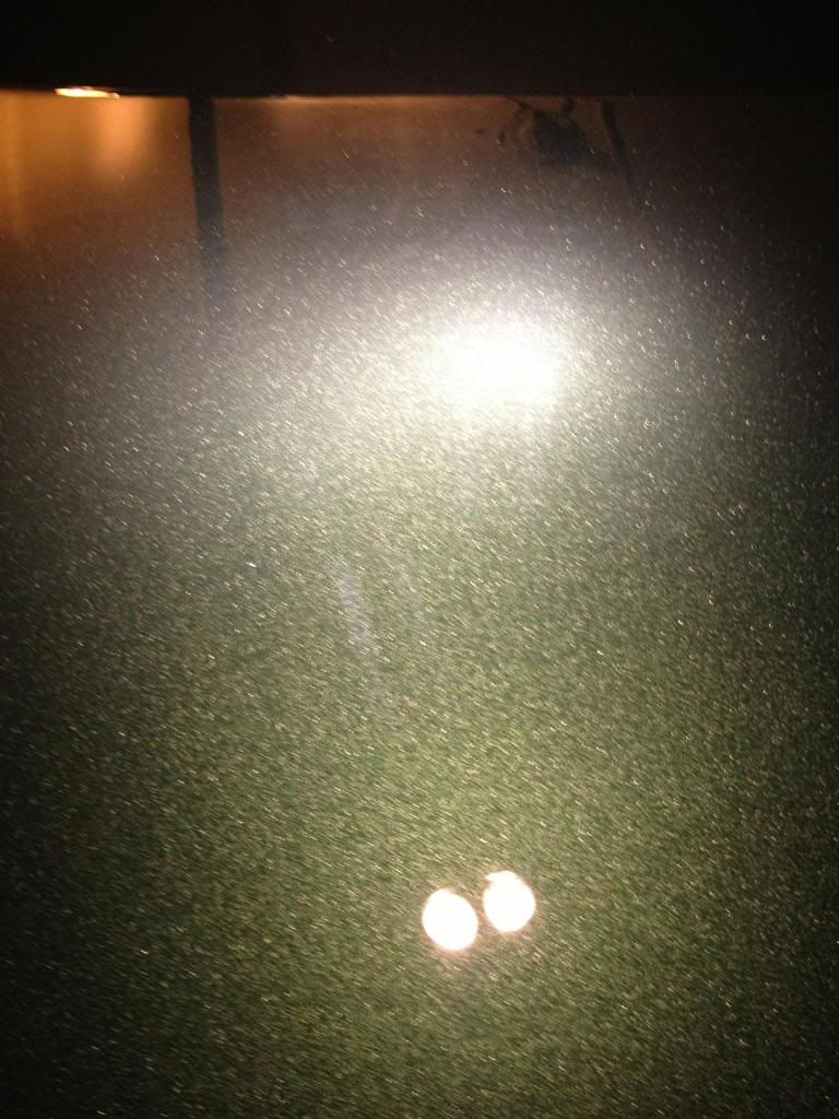

Ok guys, here are the pictures.
Left side of trunk lid (untouched)
Right side of trunk lid (polished as previously noted)

I used half of my trunk lid for a test area. The other side of it I left untouched for comparison (see above pics).

But as I have stated before, as far as it was possible to tell from the first pictures, which were kind of small, it wasn't haze from compound but scratches from something.... maybe you weren't working exactly clean on the first time and ended up putting some little deep scratches... and if that's the case (which seems to be by now), you should need to go the aggressive route as others have stated...

I think you're dealing with very soft paint. It just a matter of using the right technique, pad, and product. It's not easy when dealing with paint like this, but you'll figure it out. :dblthumb2:
If I were you, I'd stay away from M105 FOR NOW. Pick up some ultimate compound or D300.

Your photo shows like it is better, definitely go for white pad and M205 and post back.

It does look better, so I would continue with 205 and more agressive pads. If you can't get the paint exactly the way you want it and don't want to continue polishing then try a good glaze to fill in the imperfections.

that looks like compounding residue to me. compound residue can often give the illusion of scratches in my experience. i understand that youre doing an ipa wipedown but unless you do it a few times (using a new clean surface of your microfiber towel everytime) you wont get all the residue off. try "lightly" going over the places where you think there is scratching and see if they "change". if they do, that means that the residue is just being moved around causing it to look different.
also, m105 is a PAIN IN THE @$$ to remove. it could very well be reside from the m105 compound. i have personally sprayed with IPA, optimum power clean, meguairs all-purpose cleaner, wiped in between each one of these applications, and STILL had m105 residue on the car. finally i "buffed" it off by using m205 on a brand new white pad, then another clean white pad. its important to understand (when detailing) that wiping a surface with a towel is just like rinsing with water, they both simply "decrease the concentration" of whatever youre trying to remove. thats why you need to wipe multiple times with a clean microfiber surface, to ensure your actually getting the chemical "off" and not just moving it around.
also, if it is marring, you may be pressing too hard on the microfiber while removing polish/compound residue. this would induce scratches.
i am willing to bet that it is stubborn m105 residue.

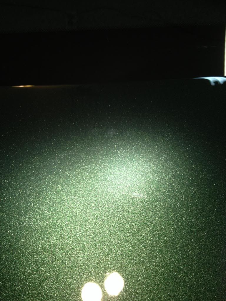

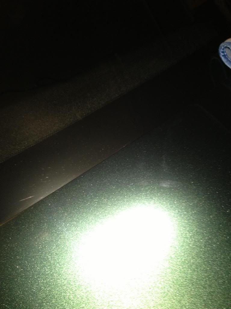

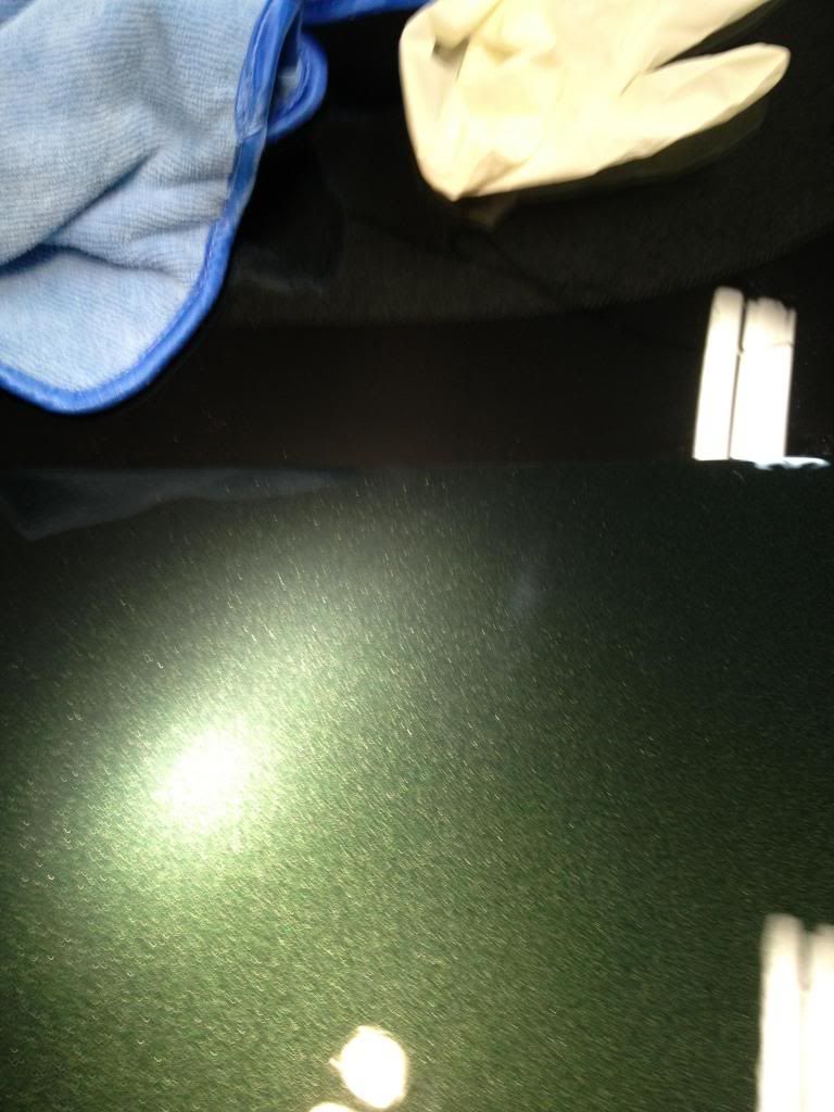

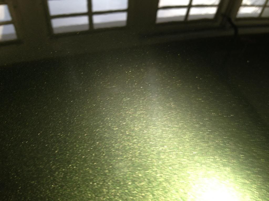

Round 3:
I've been working on the car most of the day, splitting my time between using Dr. Color Chip on the front of the car and polishing the deck lid.
The Dr. Color Chip came out pretty good, not so sure about the deck lid. I can still catch swirls with the Brinkmann but once again, the paint looks like glass under my garage lights.
I tried M205 with the following combinations of pads followed by an IPA wipe down and a check with the Brinkmann light. About half way through I started using M34 because the IPA solution kept leaving smudges behind.
Below is what I did to one third of the trunk lid today. All with moderate pressure and I went really slow. With the black pad, the last couple of passes I made were with light pressure.
8 passes with white, speed 6 - swirls unchanged
6 passes with orange, speed 5 – swirls worse
8 passes with white, speed 6 – swirls diminished from the damage I caused with the orange pad caused but back to where I was when I started.
8 more passes with white, speed 6 – very slight improvement
8 more passes with white, speed 6 - a little better
8-10 passes with black, speed 6 – At this point, I can't tell if it's any better or not.
I then compared the test section with the rest of the panel. It was somewhat better so I proceeded to do the rest of the panel with a white, then black pad. I don't think I'm able to improve on it unless Ultimate Compound would possibly help. I couldn't get to the store today, as I didn't have another car available to make a run to the parts store.

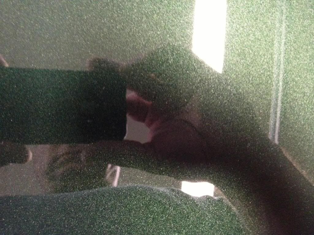

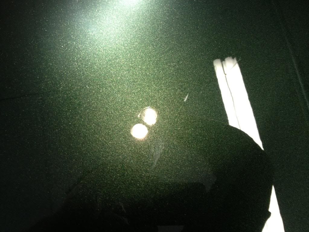

Below are a bunch of pictures, you guys be the judges. They are in the order that I took them but I don't remember after which steps. The last picture is how the paint looks under my fluorescent lights.
At this point, should I just do the rest of the car with 205, a white pad, then black and apply Blacklight, Lava, V7 and be done with it? If possible, could I toss a glaze in there that would mask the remaining swirls?
Looks better than before. Use this as a learning experience, so next time youll guide yourself in the right direction.
From those pics I really can't see swirls. Paint looks pretty good to me. IMO I would do the rest of the car with the combo you thought worked the best. Hit it with a BL, Lava and V7.
Next time you decide to do a full correction on it in the future try a different compound like UC or M101.
Those last three are pretty impressive. Just one last thing to throw out there, don't know if this has been covered already, make sure you use slow speed on final wipe down with MF towels. If your using fast hand movements the mf towels won't pick up 100% of the residue. Again that's sloooow hand movements.
