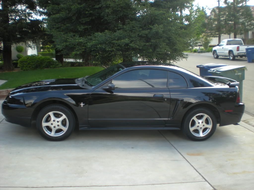

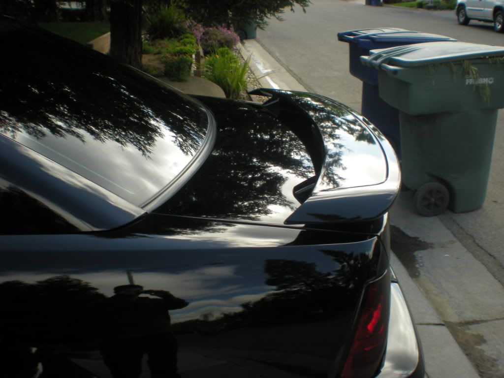

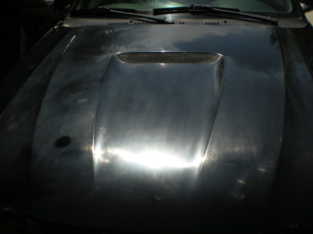

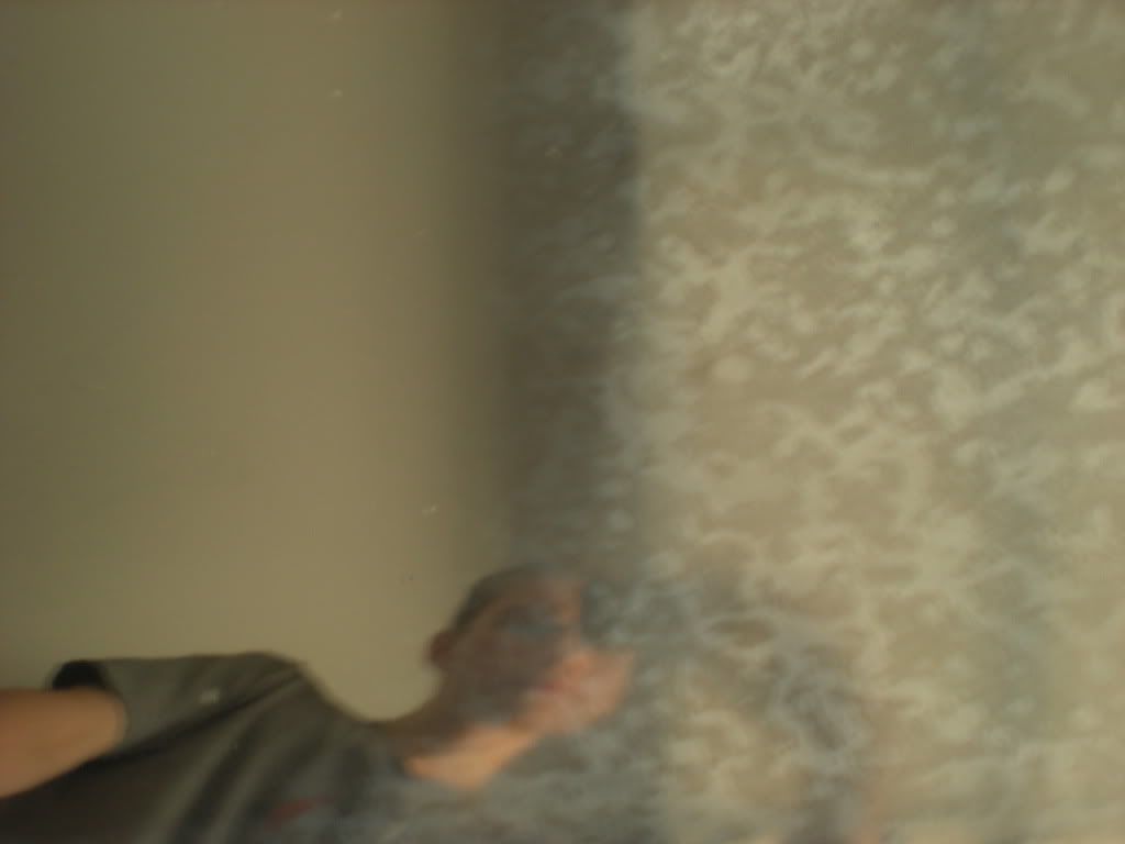

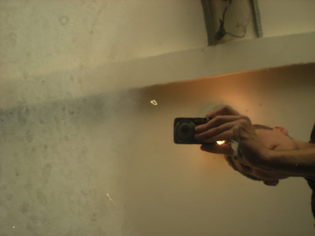

Hello autogeek this is my first post. I have been reading the forums for a while but now i finally have a car worth posting. The pictures don't really show how bad the paint was. This was the worst oxidation i have seen in person which i have attempted to correct.
The car:

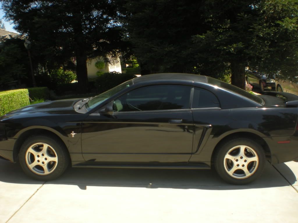

Black 2002 mustang; repainted single stage; horrible paint job as there was solvent pop and uneven surfaces everywhere. It was probably repainted by macco.
The process:

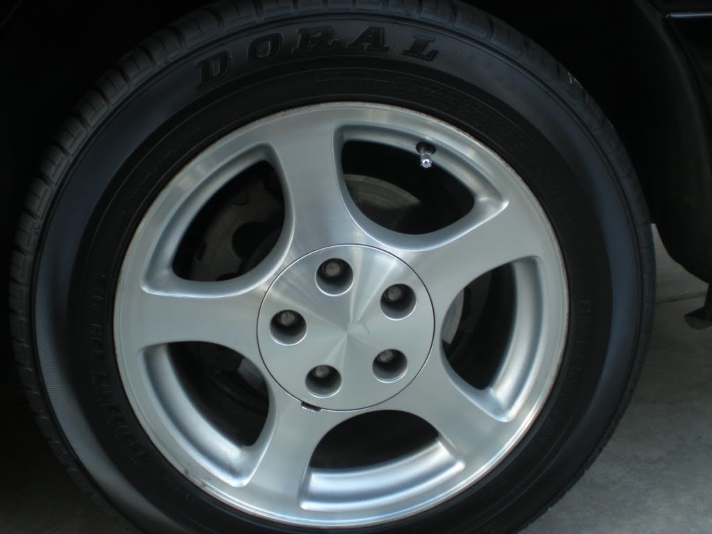

washed with Megs Gold class;

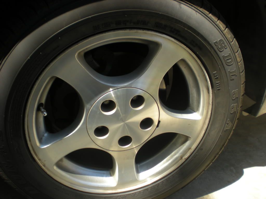

Wheels Megs apc and various brushes;
Clay bared with claymagic clay;
Paint cleaned with Colorx;
paint corrected with pc7424xp ultimate compound and surbuf pad
followed by m205 on a white lake country pad; and
paint sealed with optimum opti seal X2.

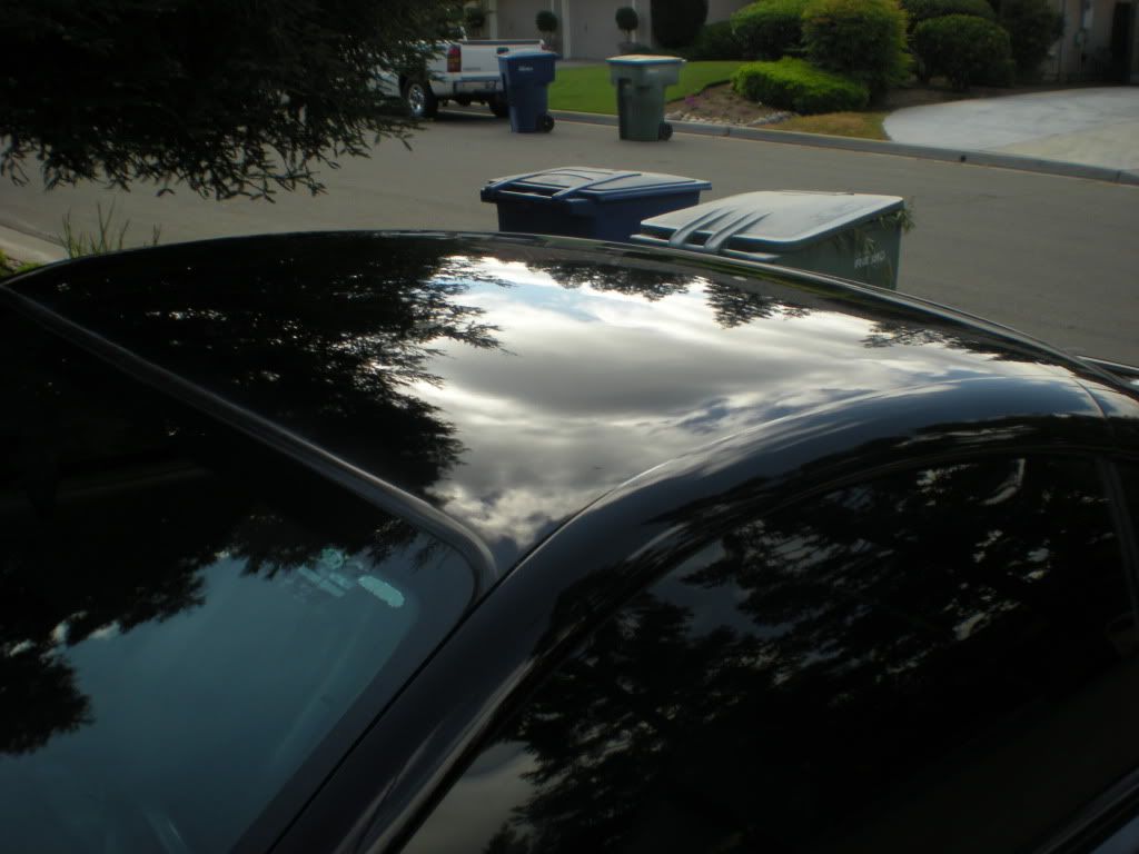

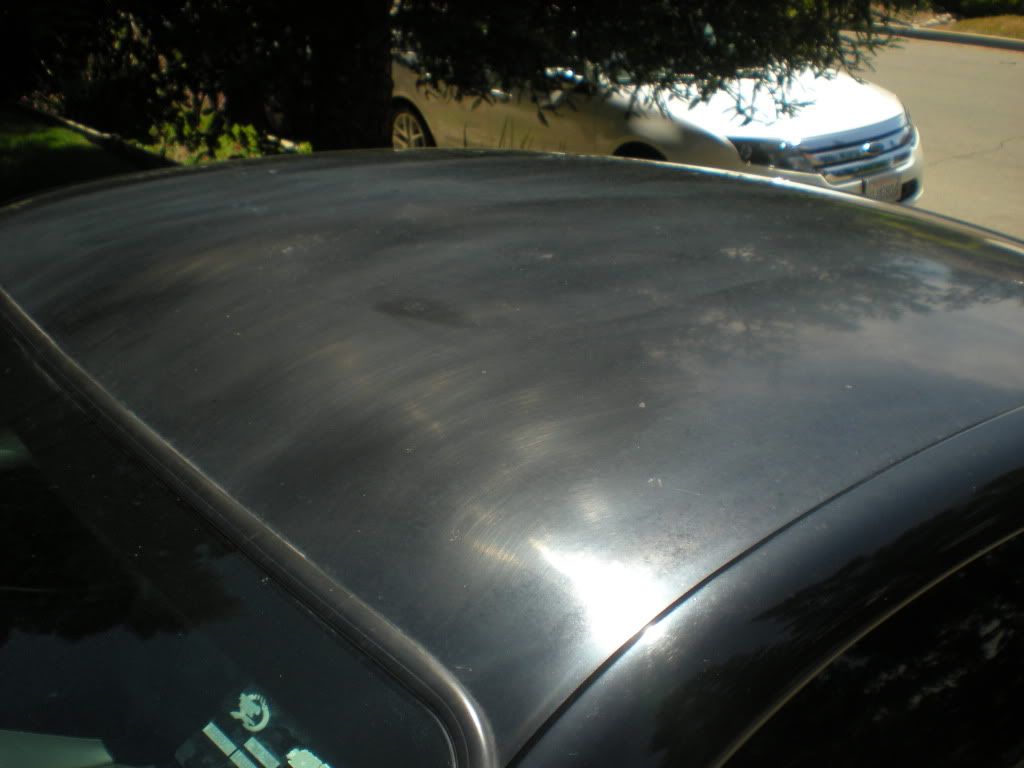

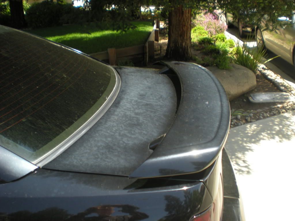

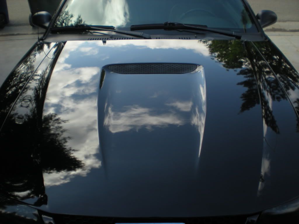

When the car when it arrived:
50/50 of hood
50/50 of roof

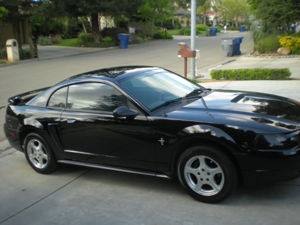

Car finished
The detail took a total of 20hrs the owner was very happy he thought the paint couldn't be brought back.
Thank you autogeek i couldn't have done it without you.

The before and after of the trunk is amazing. A really good job there.
Looks like it was painted with a brush. That is some amazing work sir!
