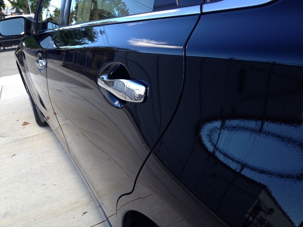

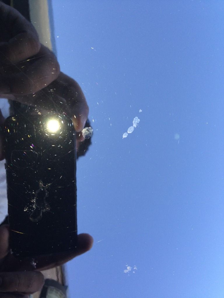

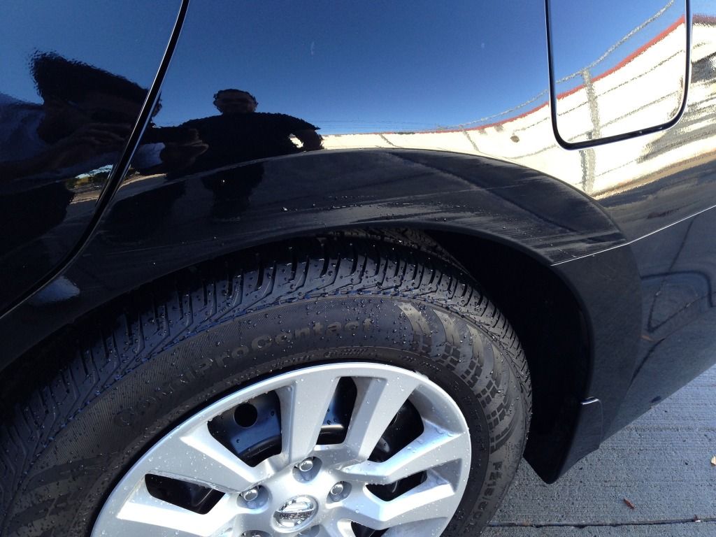

i recently purchased a 2013 Altima in super black and after having it for two and a half months and massive bird poo and tree berrys i notice the etching on my clearcoat that would not come out after i went to a hand car wash nearby.
which all brought me here to AGO and a wealth of info that has helped me almost get rid of all the spots and some swirls
tree berry and bird poo stains all over
not to mention someone hit the car while it was parked. nice discovering that after washing

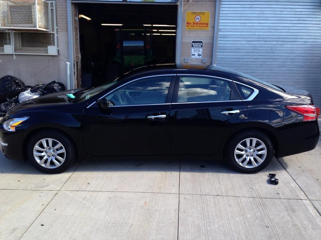

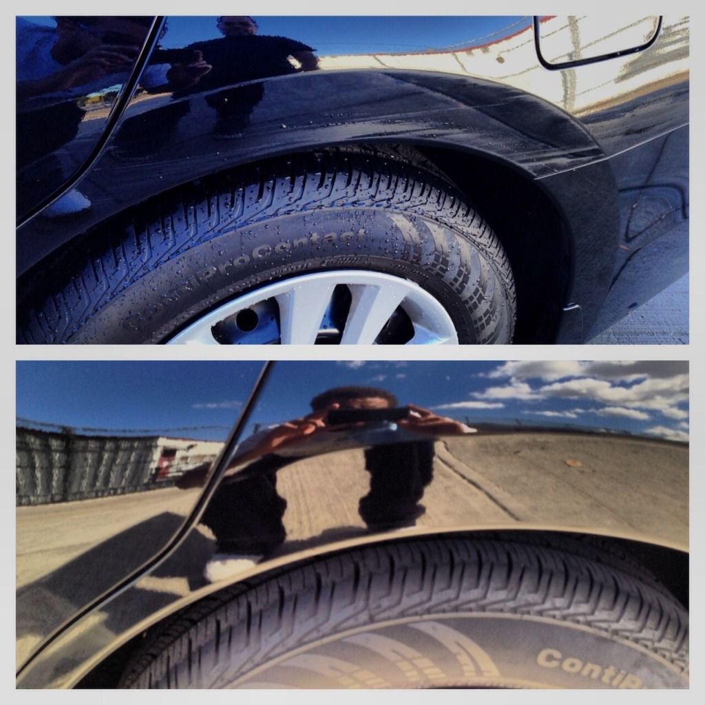

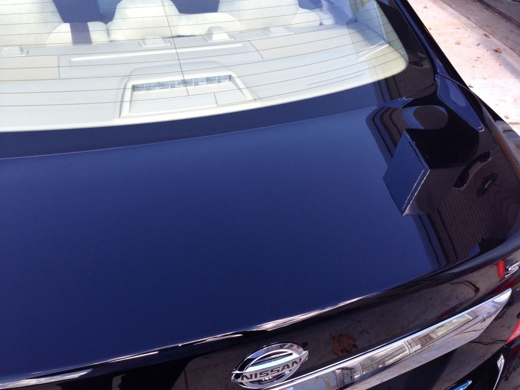

after 6 hours of washing (using junkmans 2 bucket method), claying, M105 on an orange pad using my GG 6"
and for the deeper scratches cause by another car i used M205 by hand ( was uneasy using my GG with this being my first rodeo)
and for wax i used this guy on a white pad
although there are still some swirls i am happy for the most part as this is my first time and will be doing my girlfriends lexus RX next :buffing:
again i would like to thank you guys for the info on here

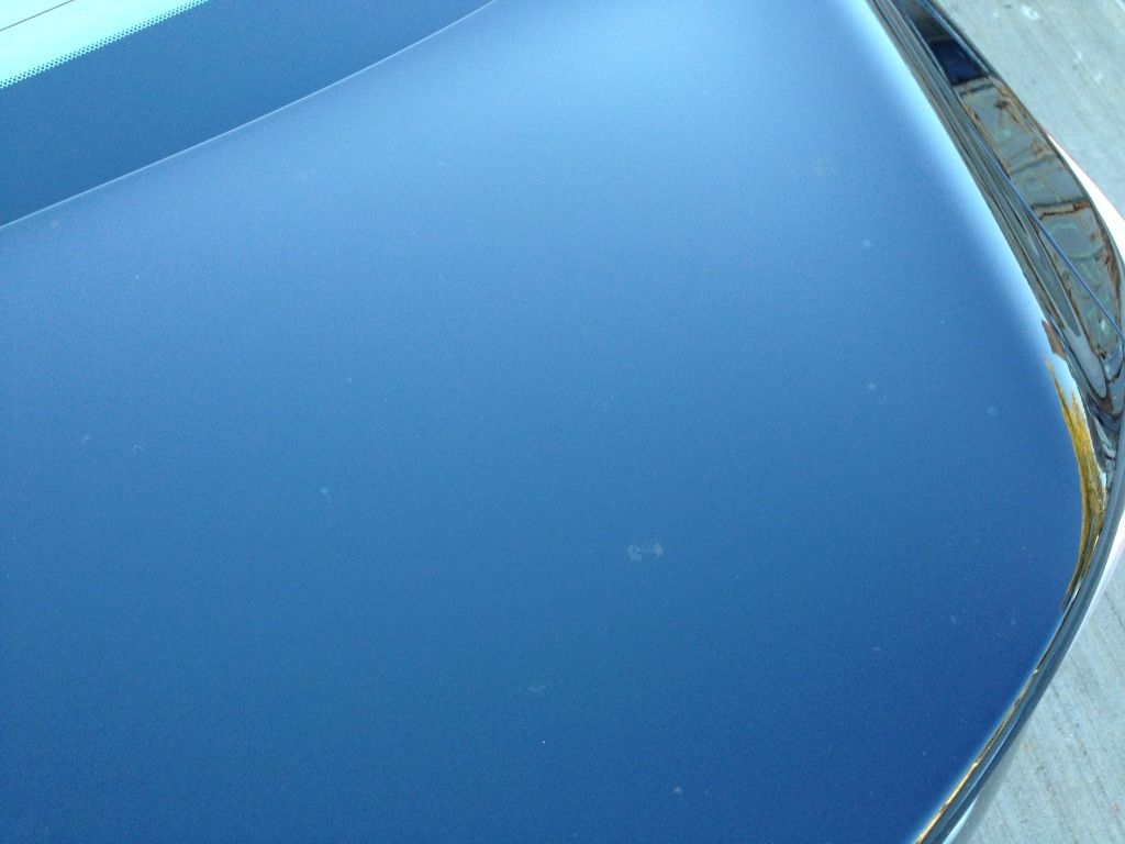

I'm glad to see you are taking a DIY approach to properly detailing your vehicle! Sounds like you have some good products, but you may need to work on your technique... practice makes perfect after all.

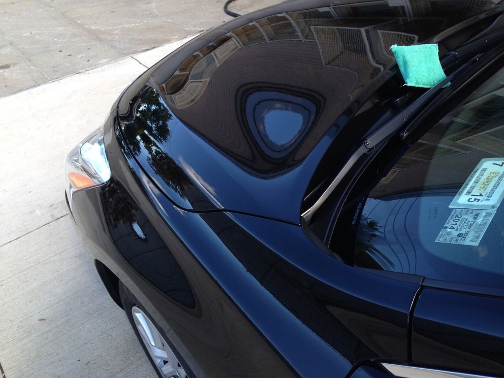

Correct me if I am wrong, but I believe you posted this as a photo of the hood after polishing?

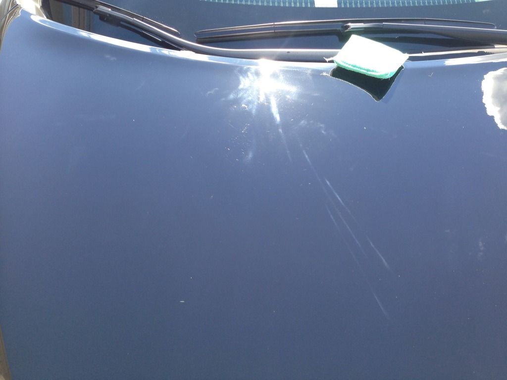

Aside from the minimal swirls that remain, it is quite obvious that there is significant marring left by the cutting compound. You mentioned that you used M105 on an orange pad, but I did not see if you said you used M205 on the entire car, or just the area that was hit?
You need to polish the entire vehicle with M205 and a finishing pad after using M105 to remove the marring/haze that is left behind by the cutting compound. Eliminating this marring will leave you with a darker and much more vivid looking black. The reflections should be completely clear and not have streaking like what is shown in your photograph. These "streaks" (<- idk what else to call them) are visible because the light is being refracted in the tiny scratches left by the M105.
Here is an example to better show what I am talking about....
^The lower portion was compounded with M105 and a MF cutting pad, the top portion was also compounded with the same products, but it was then followed up with a finishing polish and pad. See the dramatic difference in color as well as the lack of any haze/streaking appearance.
Here is what it looks like in the sun...
^You can clearly tell the area that has been finish polished compared to the surrounding areas that have only been compounded. This is a somewhat extreme example, and yours may not be as evident as this.
Afterwards, reflections should be crisp and clear!
Not bad for your first time though! Keep it up :buffing:
**A note about the Lexus you are going to work on... Lexus tends to have noticeably softer paint than many other vehicles. Remember to do your test spots, starting with the least aggressive method and stepping up products/pads as needed to achieve your desired results!**

Judging by the photo that I previously commented on, the UP on an orange pad was not removing all of the swirls. This could be due to several things - technique (machine speed, pressure, arm speed), amount of product used (too much or too little), or you simply might have needed to use something more aggressive like the UC on the entire car.

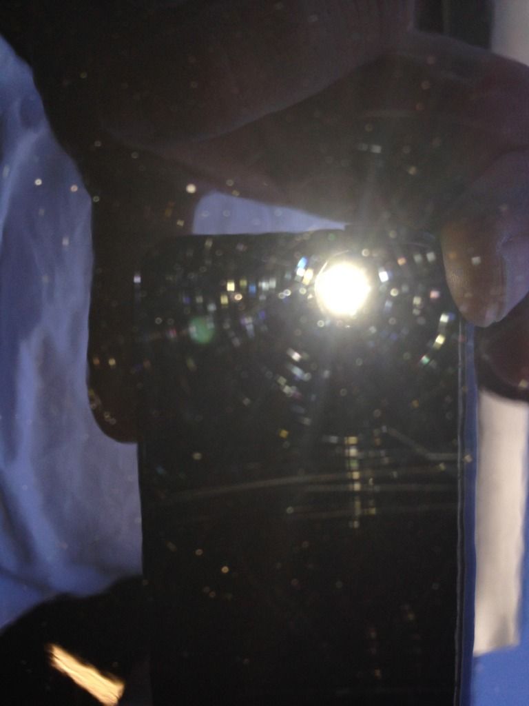

Judging by your very first photo of the "before" state of the car, the swirls did not appear to be too bad, but since you were simply using a tiny flash on a cell phone, I would imagine that didn't truly represent the condition of the paint and that it was actually worse under ideal lighting.
You might have tried something like UC on an orange pad followed by UP on a white or black pad over the entire car, followed by applying wax via a black or blue pad.

Hey Lance, there's quite a bit of marrring(compounding swirls) left over. You need to go over the car with a lighter pad and polish. :dblthumb2:
He mentioned waxing with a white pad. Could that be part of it? Would that leave some marring? I thought a white LC pad was for polishing.
I would think 205 or UP on a white pad followed up by the Collinite on a finishing pad (grey?) might do the trick.
I doubt the white pad would leave any marring when used with a wax unless the paint was particularly soft. I have never worked on a Nissan, so I cannot add any insight as to how hard or soft his paint might have been. However it is definitely more common to use a black (grey?) or blue pad to apply waxes and sealants.
