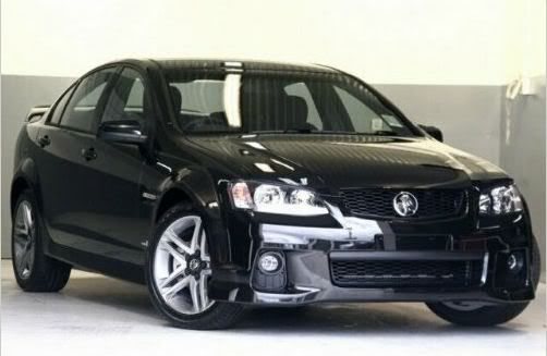

Dear fellow AutoDetailing experts,
I have recently purchased a brand new car that is the colour 'phantom black' would like to know what you would recommend in mainting and caring for such a colour. The dealer said polishing a black is a NO NO and they tried to sell me some X-Pack Detailing kit which I refused to buy.
Any comments much appreciated, this is a picture of the car
thank you all
