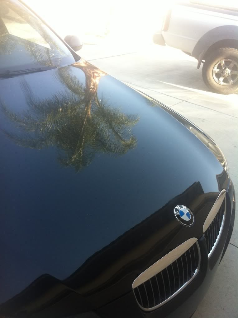

^ This is a true mirror finish (zero orange peel)
