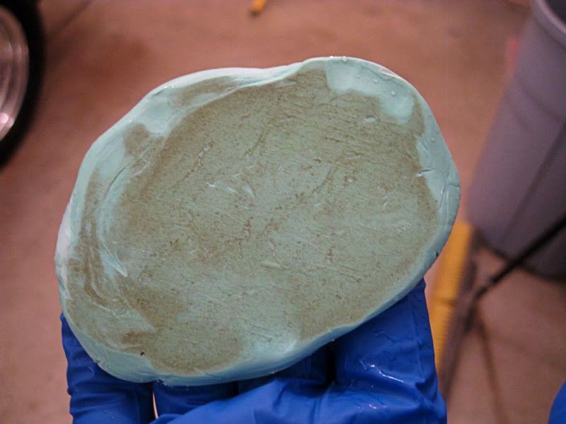

This is great guys! That's some FILTHY clay! I'll break the rules slightly and post up a vid of that 2000 Accord. This was the worst section of the car... :dblthumb2:

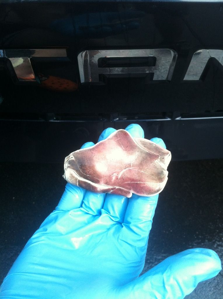

That happened to my car recently! I had just clayed and polished a few weeks prior and then all of a sudden I could feel the grit like sandpaper on the next wash. When I clayed it turned the claybar pink. Every panel was equally contaminated...
What do you think causes that type of contamination to make the claybar turn pink? Some sort of tree sap or pollen???
Hey thanks for watching and great questions. This car was so badly contaminated it took two people about probably an hour to clay all the road tar, sap, and iron particles off the paint. In terms of technique I was using much more aggresive force and speed to work on this paint compared to what is appropriate on a well cared for vehicle. The paint was such a wreck to begin with the very last thing I was worried about was any marring induced from the claying process.

I have no idea, I know in my customers case, it was the first time the truck was detailed since he had it new two years before... and it was really only the tail gate... he does a lot of hunting, so for a while I though maybe there was dried animal blood or something...
