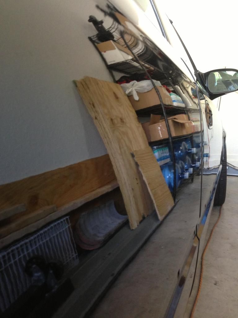

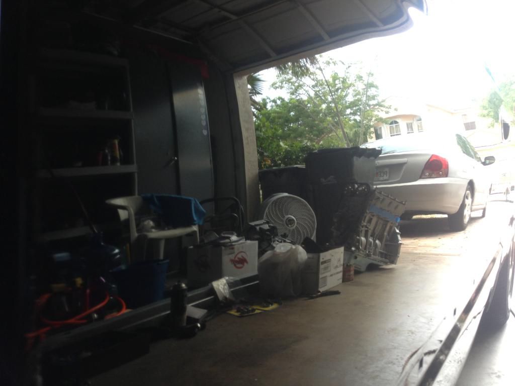

Tight space to work on since car couldn't be moved. We gotta do what we gotta do, make it work.

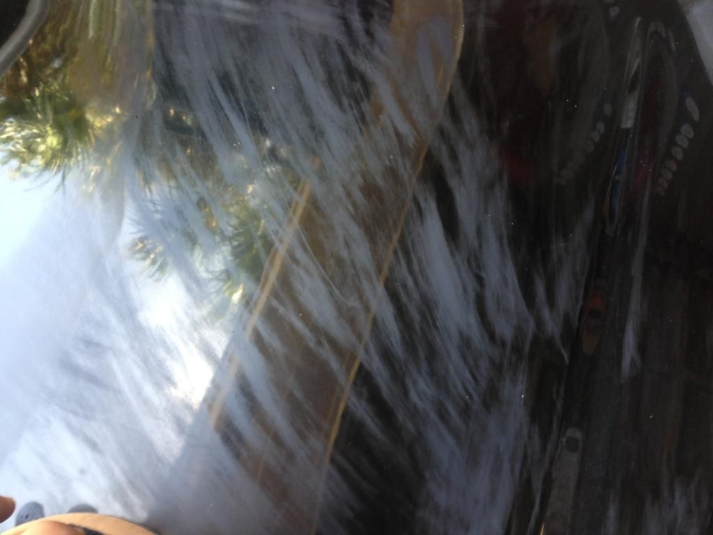

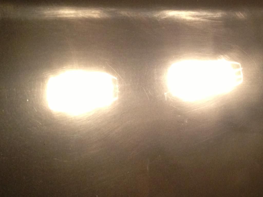

To give you guys am idea of how bad the paint was,
I did a quick 50/50 but this time I was prepared for the worse.
The worse is what I got.
Notice the left side, bad sanding and buffing job. I wasnt kidding.
That was only after compounding with M105 paired with LC purple wool pad and Flex3401.

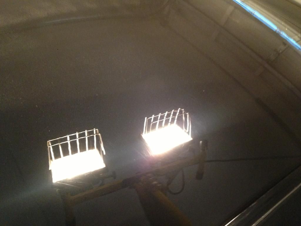

50/50

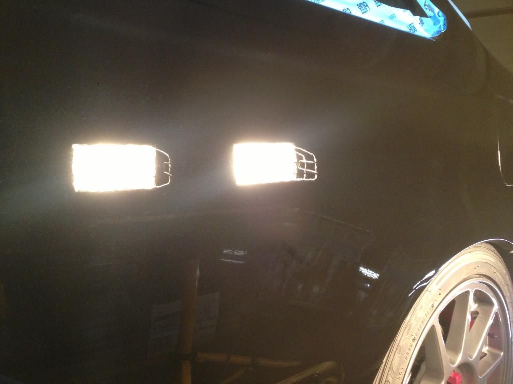

On this angle same problem which required some wet sanding to remove a lot of the scratches.
50/50
In most cases I was able to get away with LC orange pad plus HD adapt with one step only.
Before
After
Before
After

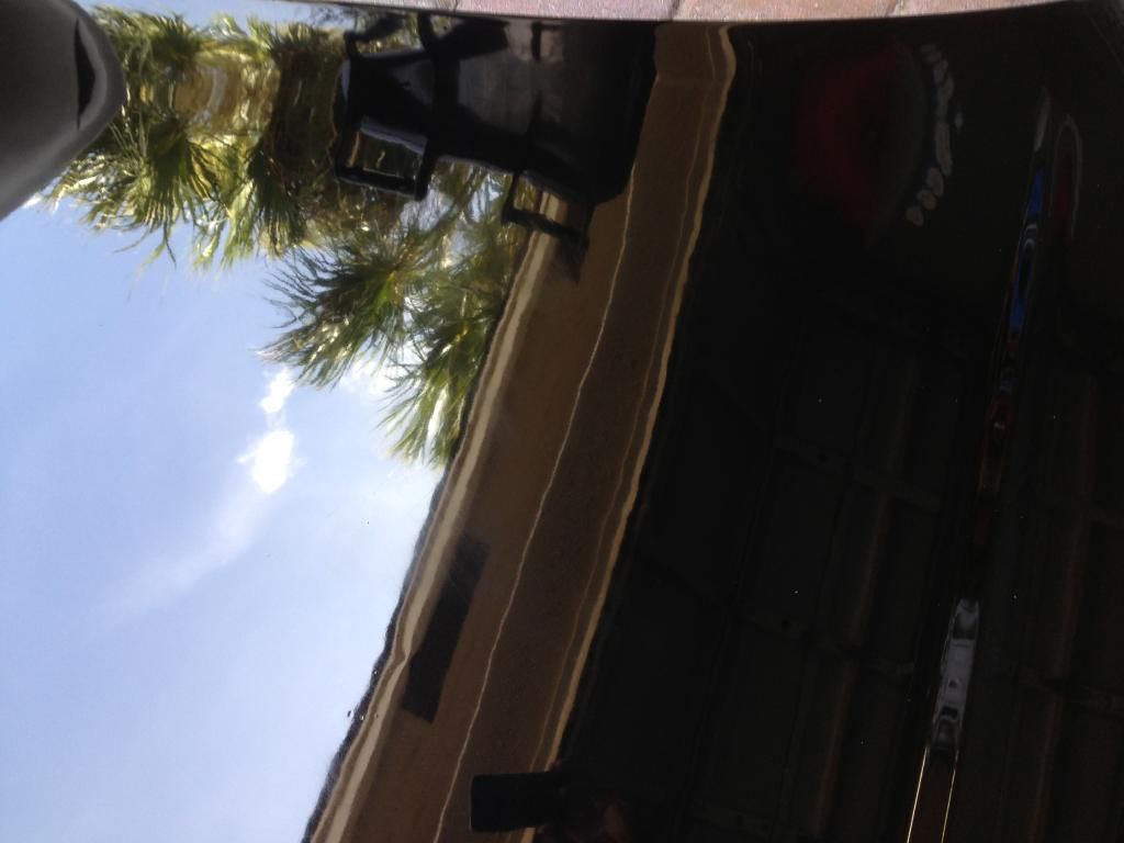

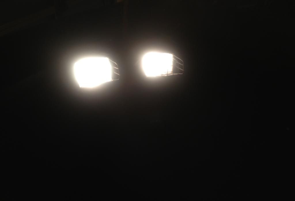

Here is a perfect example that sometimes it's not with going after. Some deep deep scratches after wet sanding and buffing still remained on the top but much more improved. After all, he will be using this car to race.
After

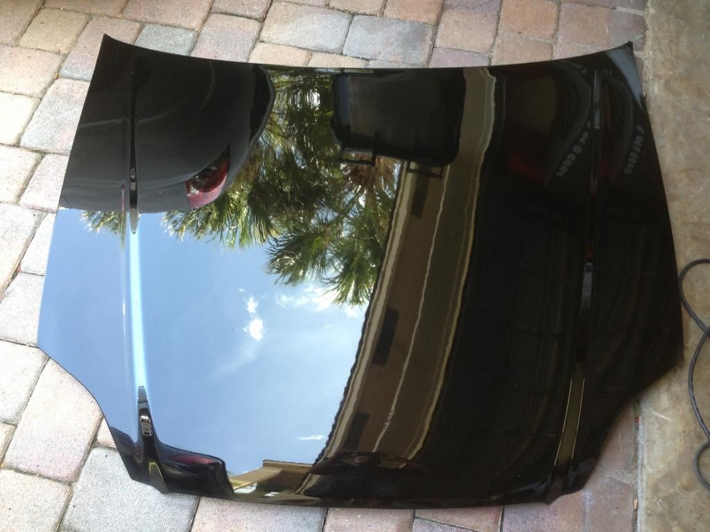

Here is how the hood looked, had to wetsand the hood with 2000 grit and 3000 grit to make it a smooth as possible.
Before
After
Entire hood complete

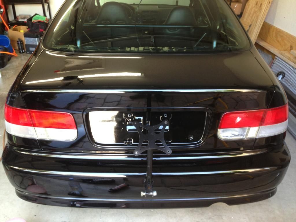

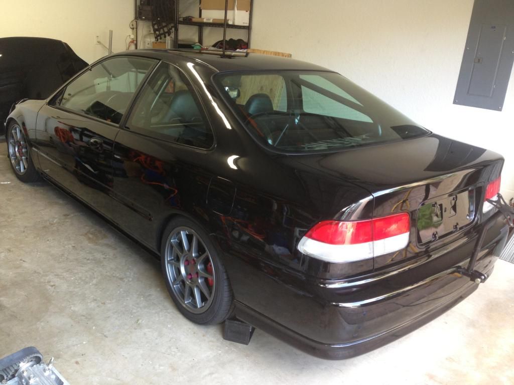

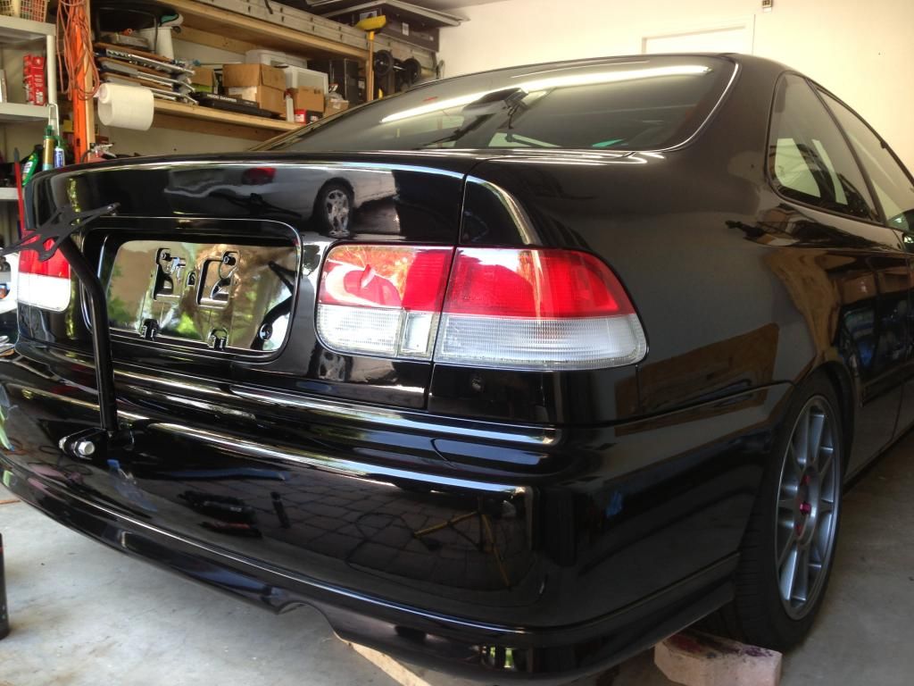

After long hours the car was finally complete.
After shots. Not the best by any shot but at least I tried my best to document the work after all the correction done to his car.

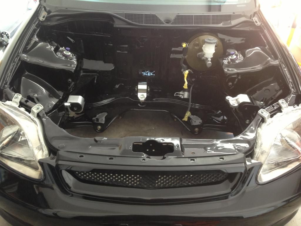

Even the engine bay got some special love before the engine gets put back in. I will update this thread again once he gets the car completely done.
