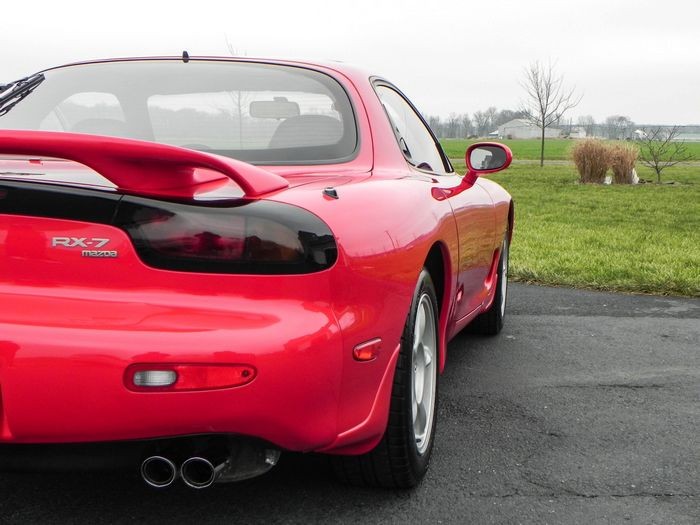

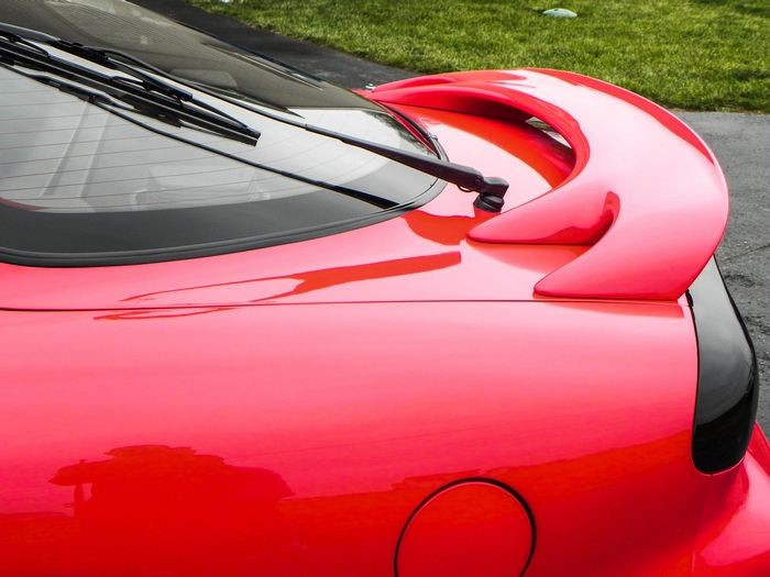

Alcohol did absolutely nothing to help remove this tree sap. I tried D120 @10:1 and @1:1, then I tried 2 different forms of hand sanitizer, let them dwell on the tree sap for a while and they did nothing. Next was straight 70% isopropyl alcohol, absolutely nothing to remove the tree sap. Magic Eraser struck through the clearcoat.. Finally I had to bear through it with aggressive clay and it took a good long while.This truck had been sitting under a tree for basically years..
It was a PITA to restore the shine to this truck.
But I got it dun. With my HF DA.
