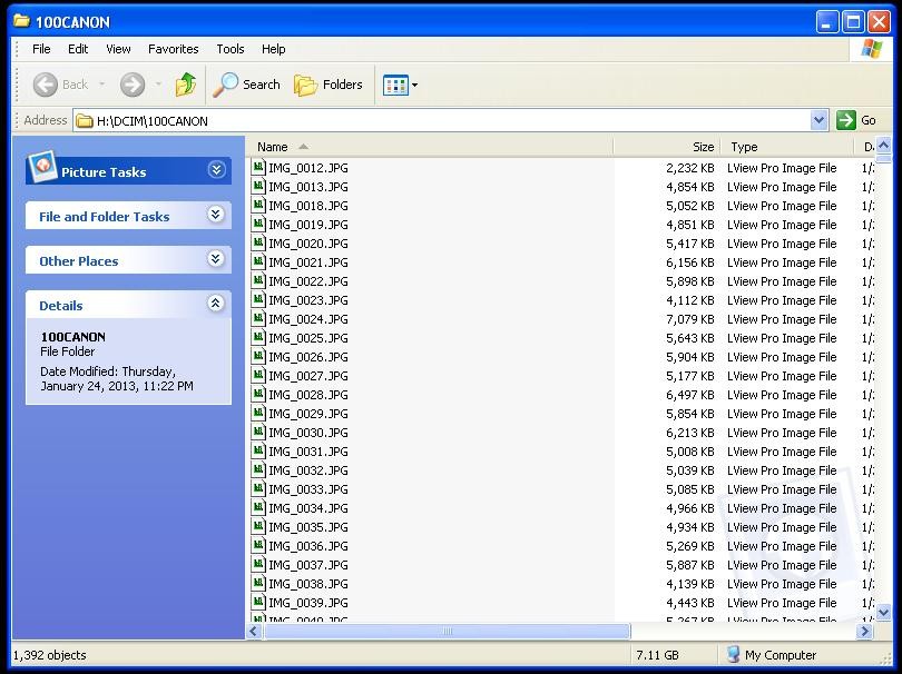

No its the fender.
For some reason the site twists my photos around. I have an even better, more close up photo but it won't upload which is annoying.
Here's your picture uploaded to our gallery so it can be "inserted" instead of attached. Our site doesn't actualy twist your pictures, this is how they come off your camera phone. When you look at it on your camera phone SOMEHOW the camera knows how to display it to you so it looks normal. Take my word for it... I've worked with a few pictures in the forum world in my life. For the below picture I rotated it before I uploaded it.
